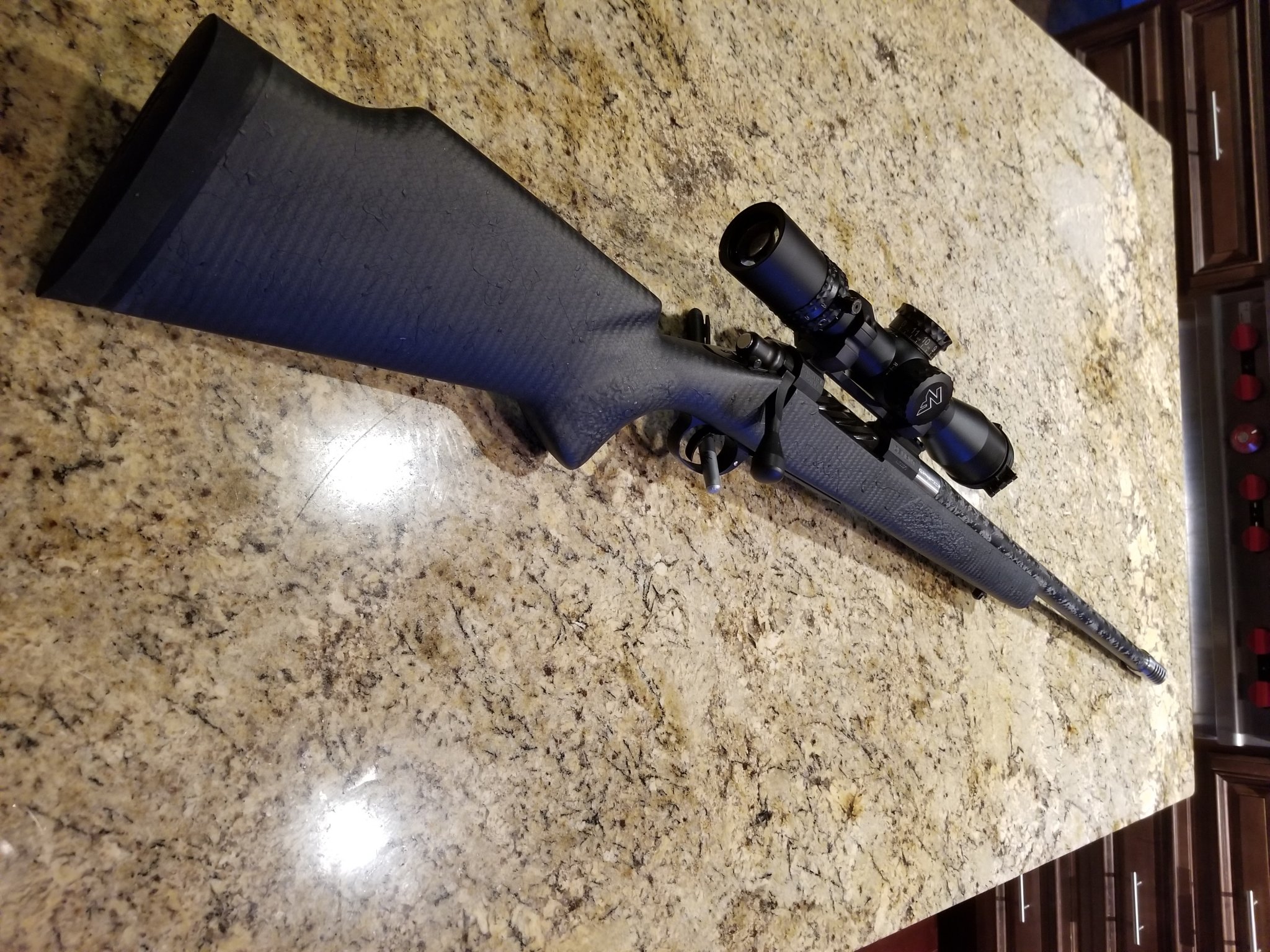

I just had this one built, just started load development. Plan on using 210gr LRAB
Altus Shooting Solutions
300 Norma
Defiance Deviant Hunter Nitrate
Proof Sendero 26" 1-9
Piercision Titanium 5 port brake 3/4-24
Sunny Hill Rigby BDL aluminum bottom metal
Huber 2 stage 2#
Manners Elite carbon MCS-T
Nightforce ATACR 4-16x42 Mil-R
APA Truloc .856" rings
Weights 9lbs 11oz w/optic
