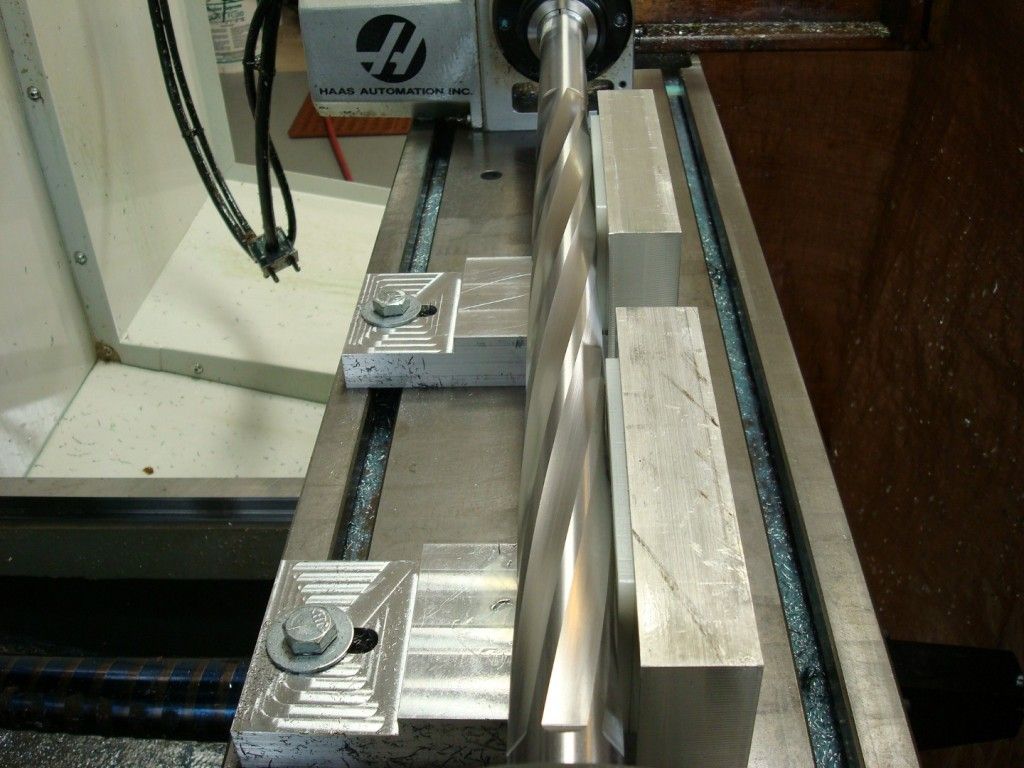

I'm thinking I'll have SAC install their bolt release, as I think it's a good looking upgrade, as well as needed with the trigger I'm using. Now, if I could just find someone to make those wide flutes for me......
