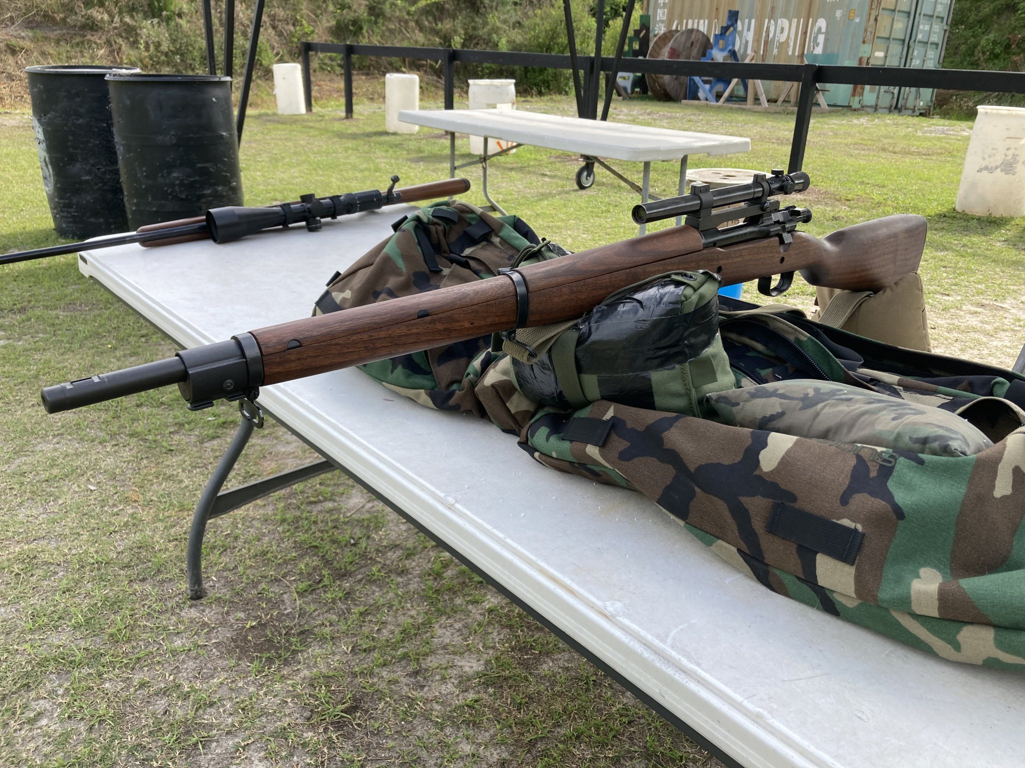

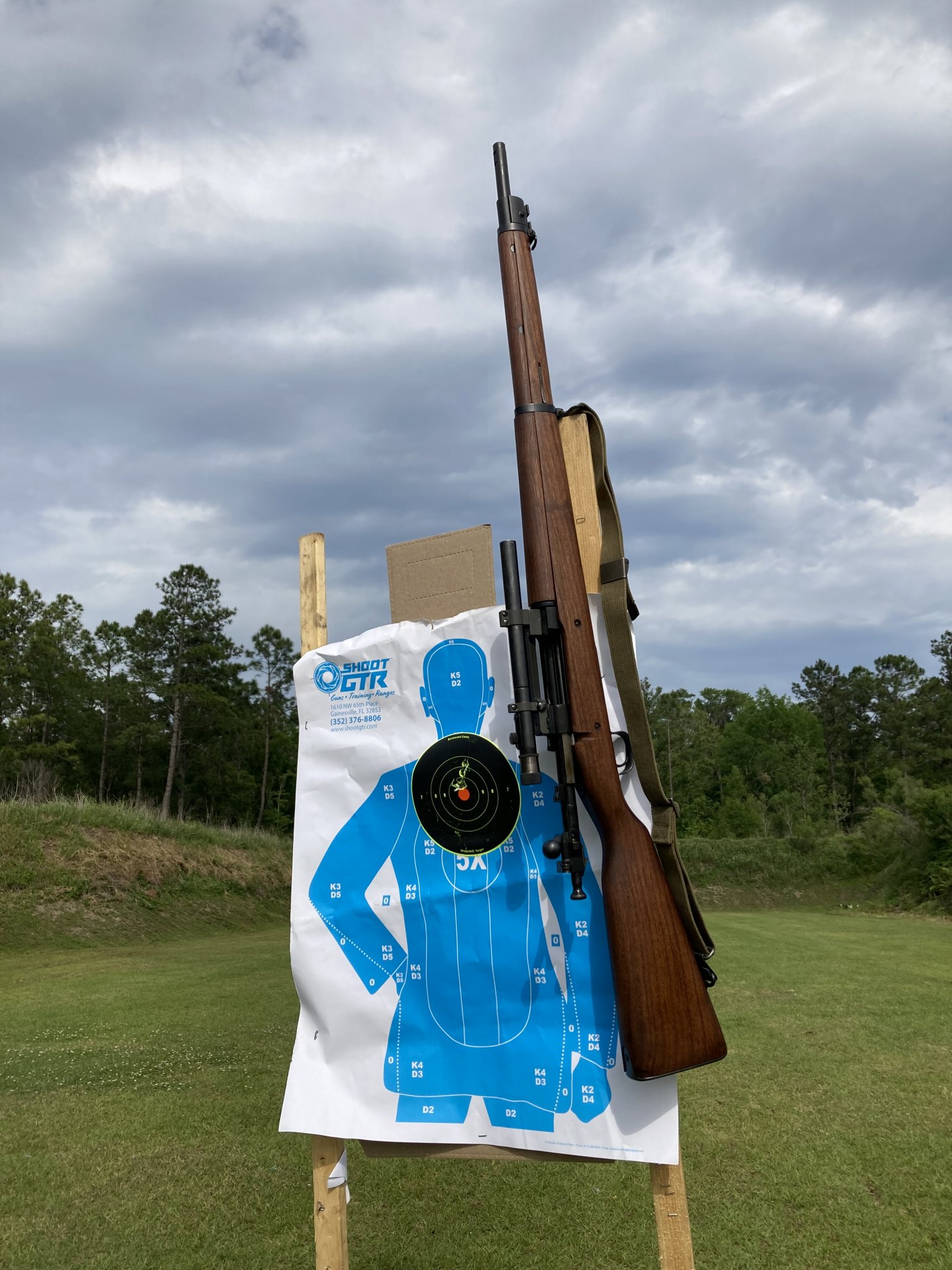

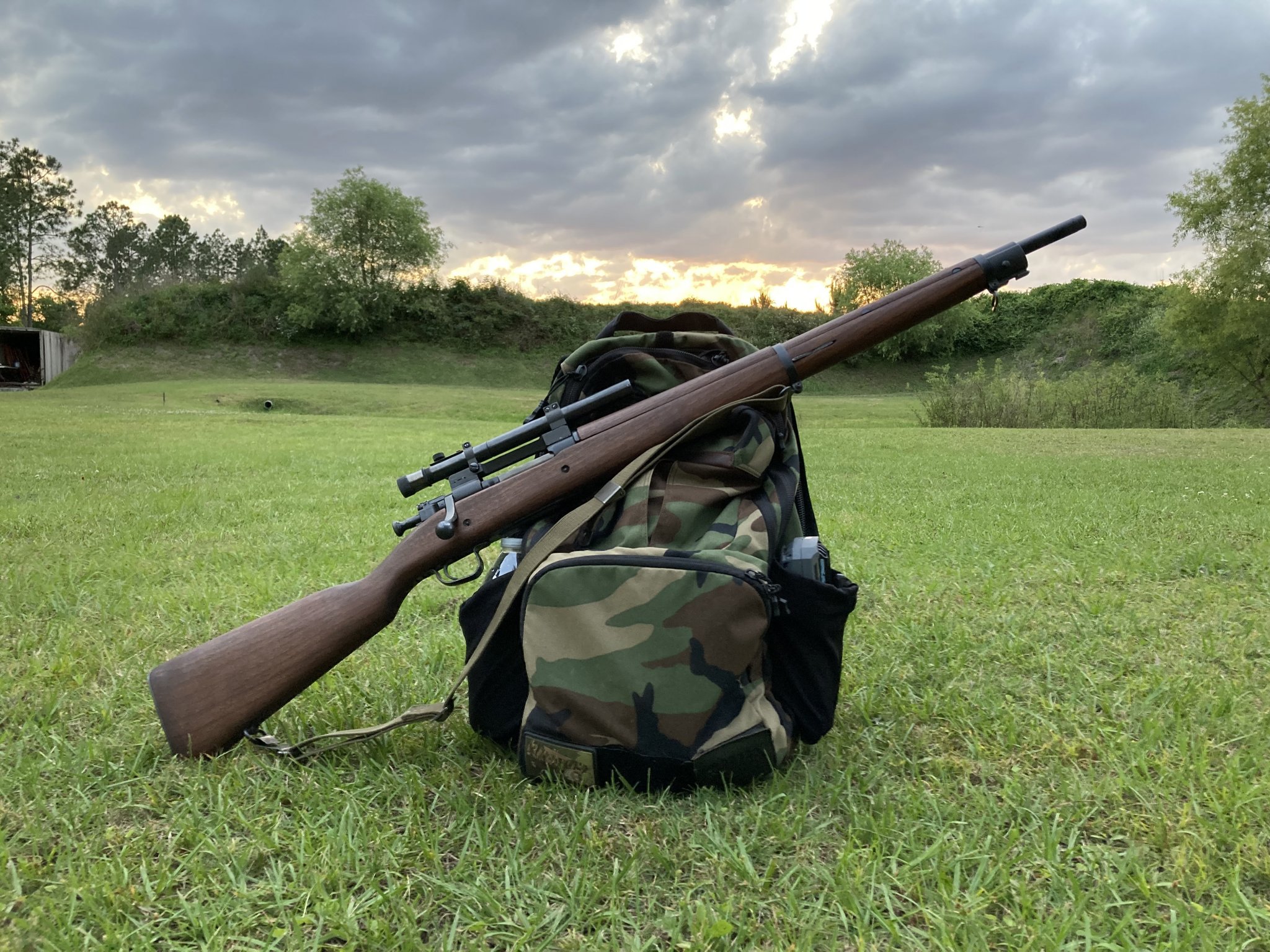

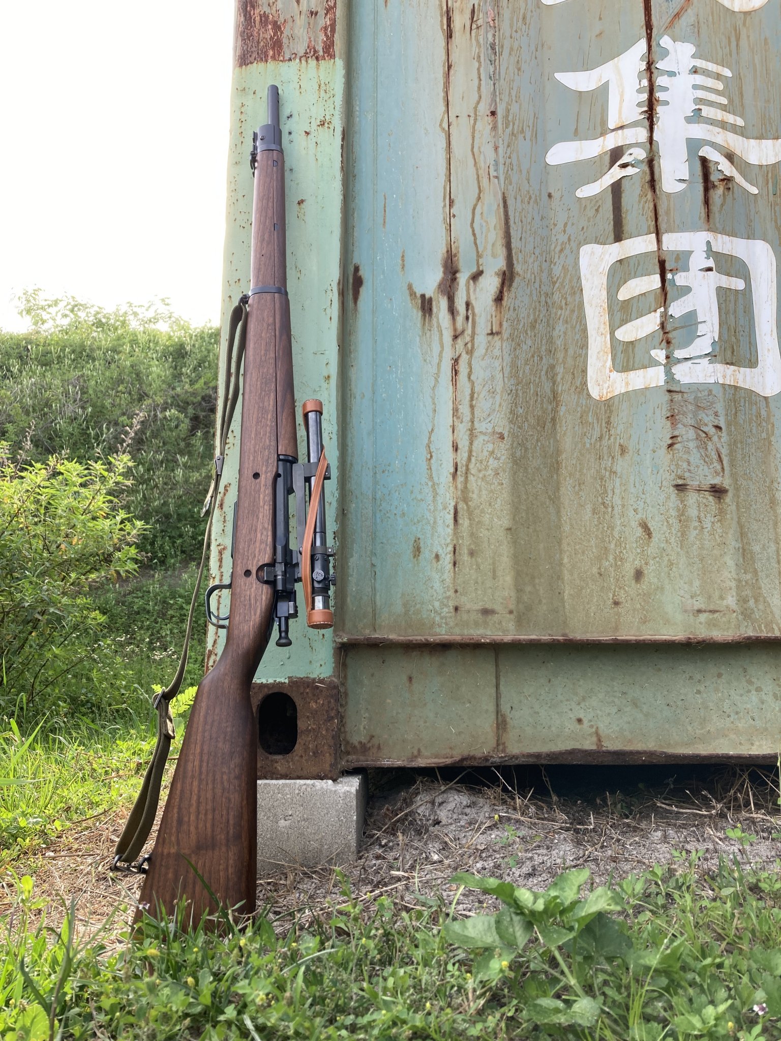

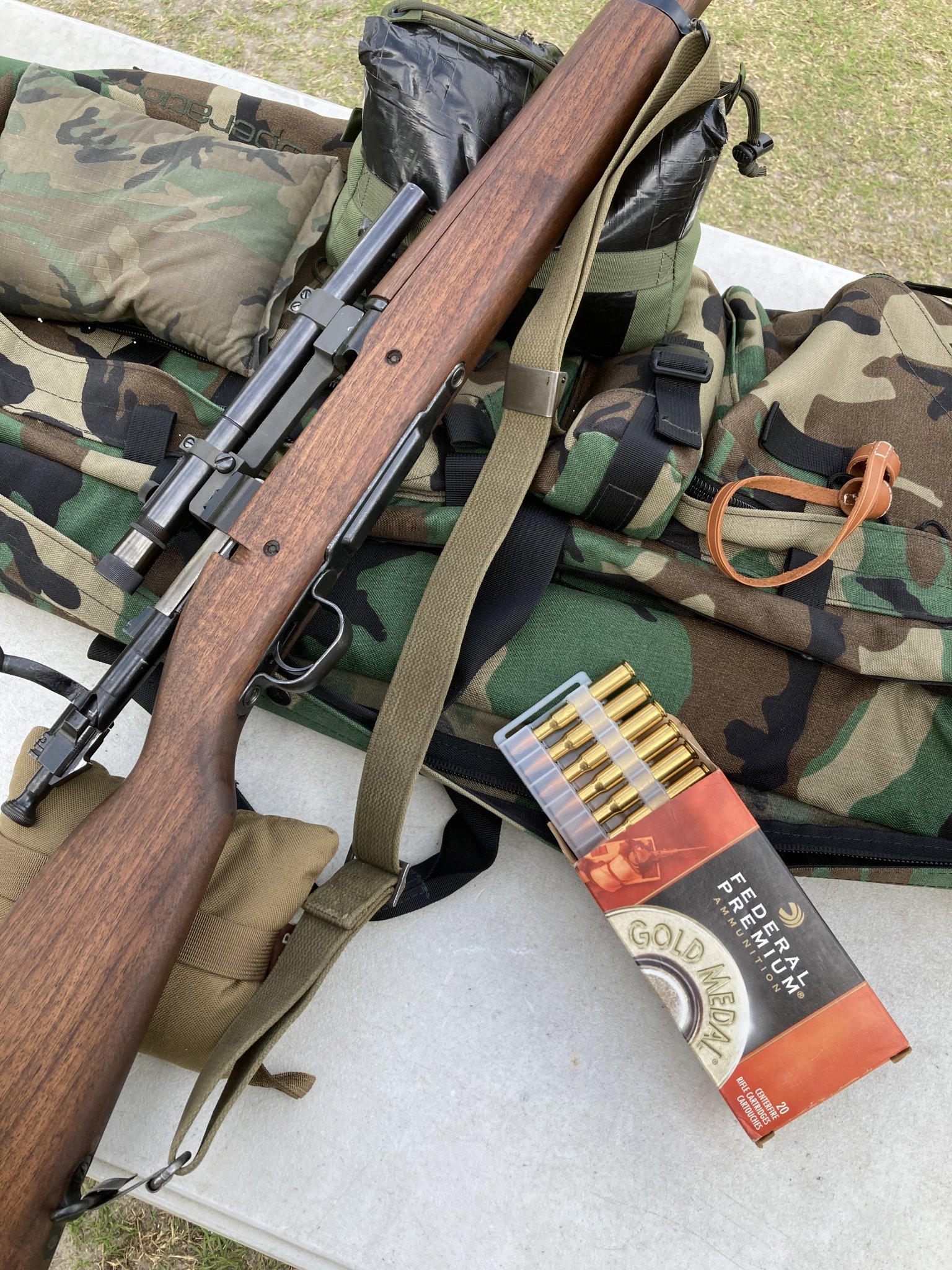

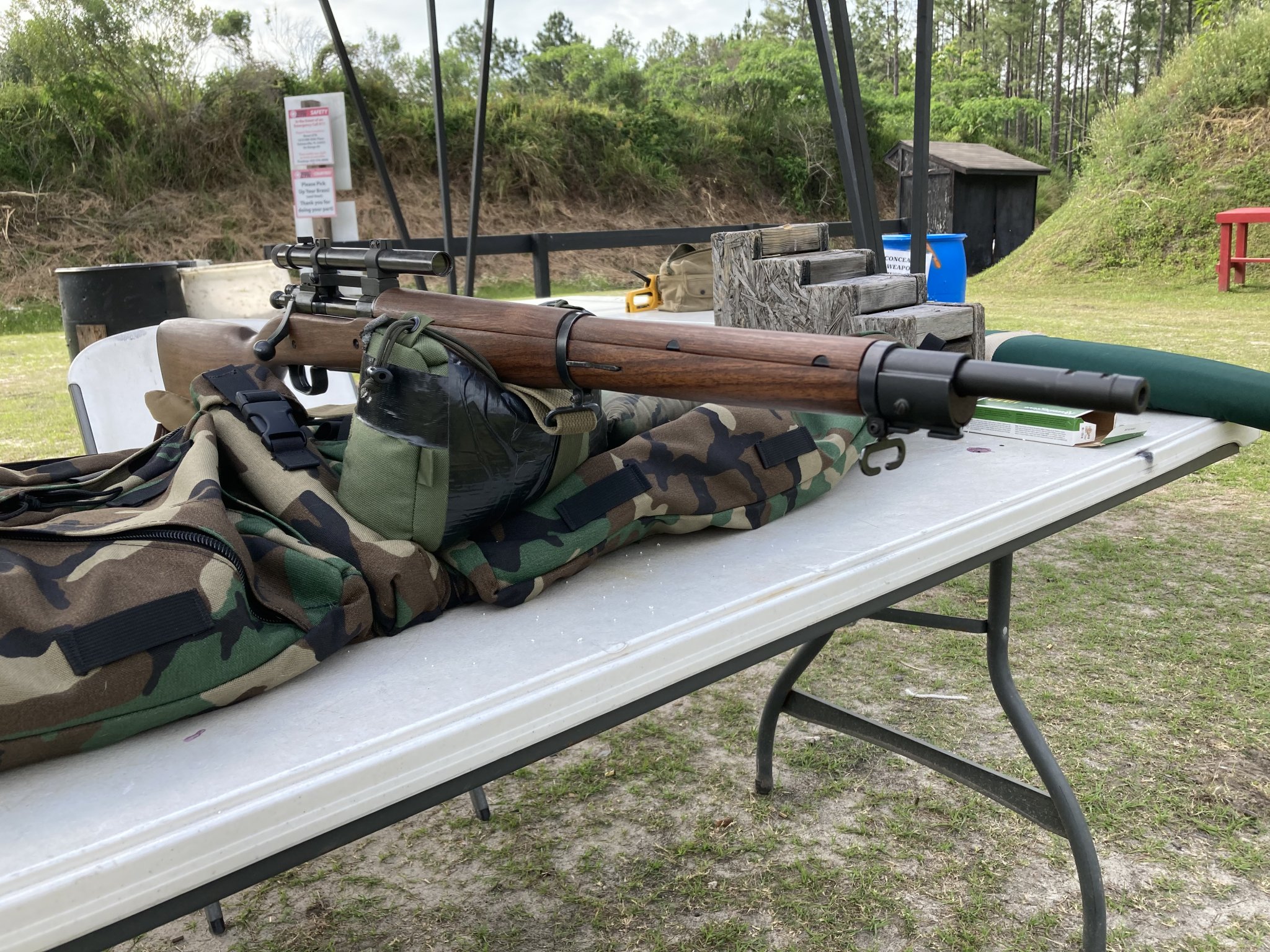

    I final got a chance to get out there and shoot it for groups, and take some good photos.
    All of the groups were shot with FGMM ammo.
    My greatest limitation in shooting the groups was the scope. The post-style reticle is an awesome intuitive reticle for fast shots, but not great for our modern standards of precision shooting. My best group was just over 1.5" and my other groups were hovering around 2".
    With a modern precision optic, it wouldn't surprise me if this thing was a consistent sub minute shooter.
    Enjoy the pics.
