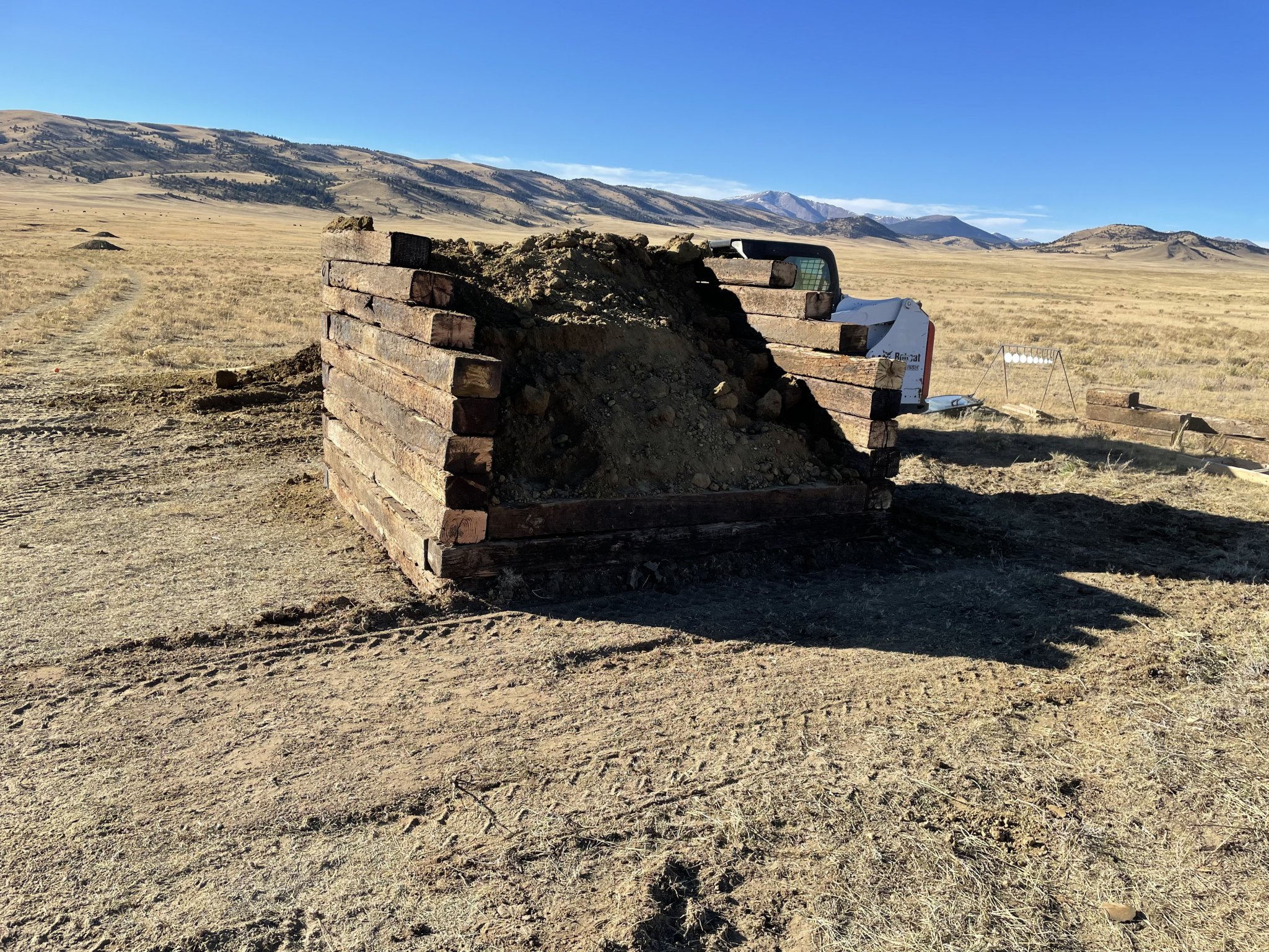

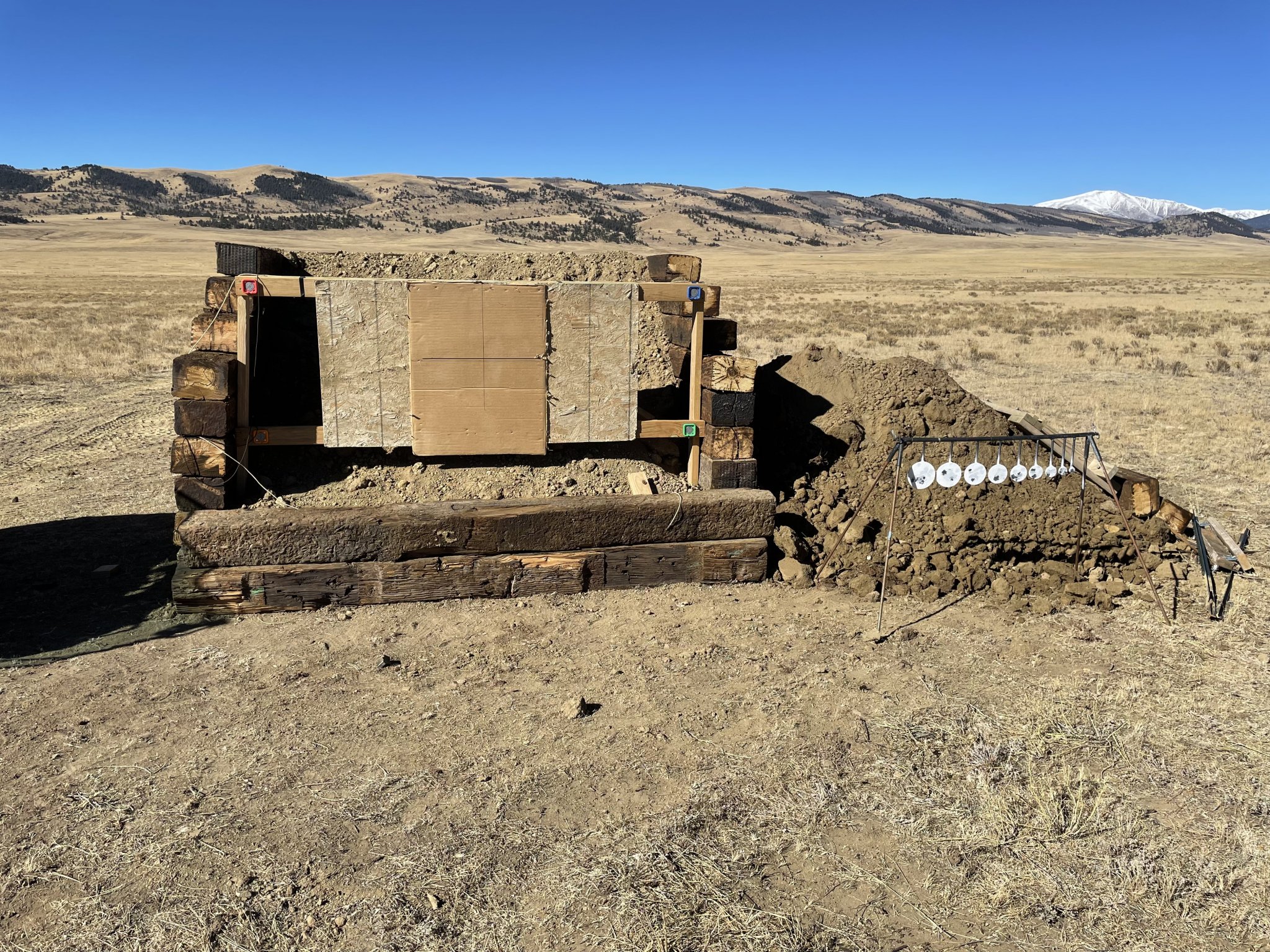

    Recently built range on my property. Do a lot of shooting on paper at 100 and 450 so built heavy burns at those 2 yard lines.
    After doing a fair amount of research I went with railroad ties with dirt fill to keep them intact. Here are some pics:
    img_1594-jpg.7885462
    Depending what’s behind your target would determine if you’d really need dirt mounds. Soft dirt or sand will stop a bullet much easier even just flat ground. Likewise rock, hard clay, water etc won’t. Partial hits can be hard to catch anyways. Fire some tracers and you’ll see just how off course bullets can ricochet. Steel hanging at an angle help direct shrapnel and prolongs your target life as well

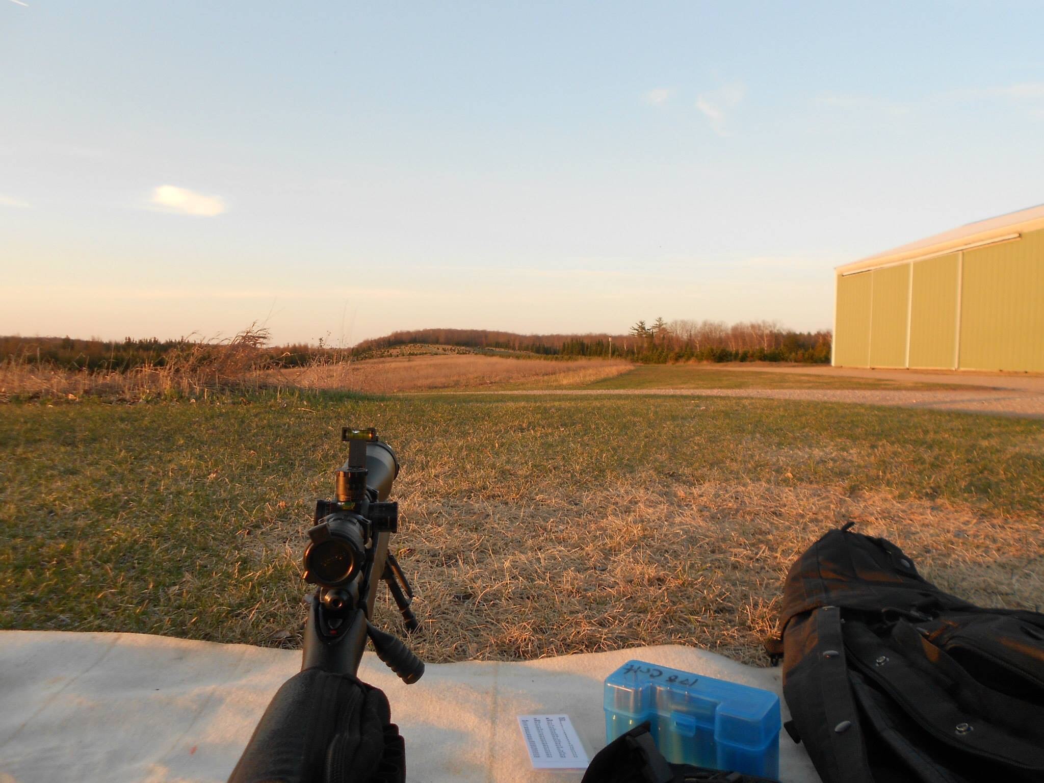

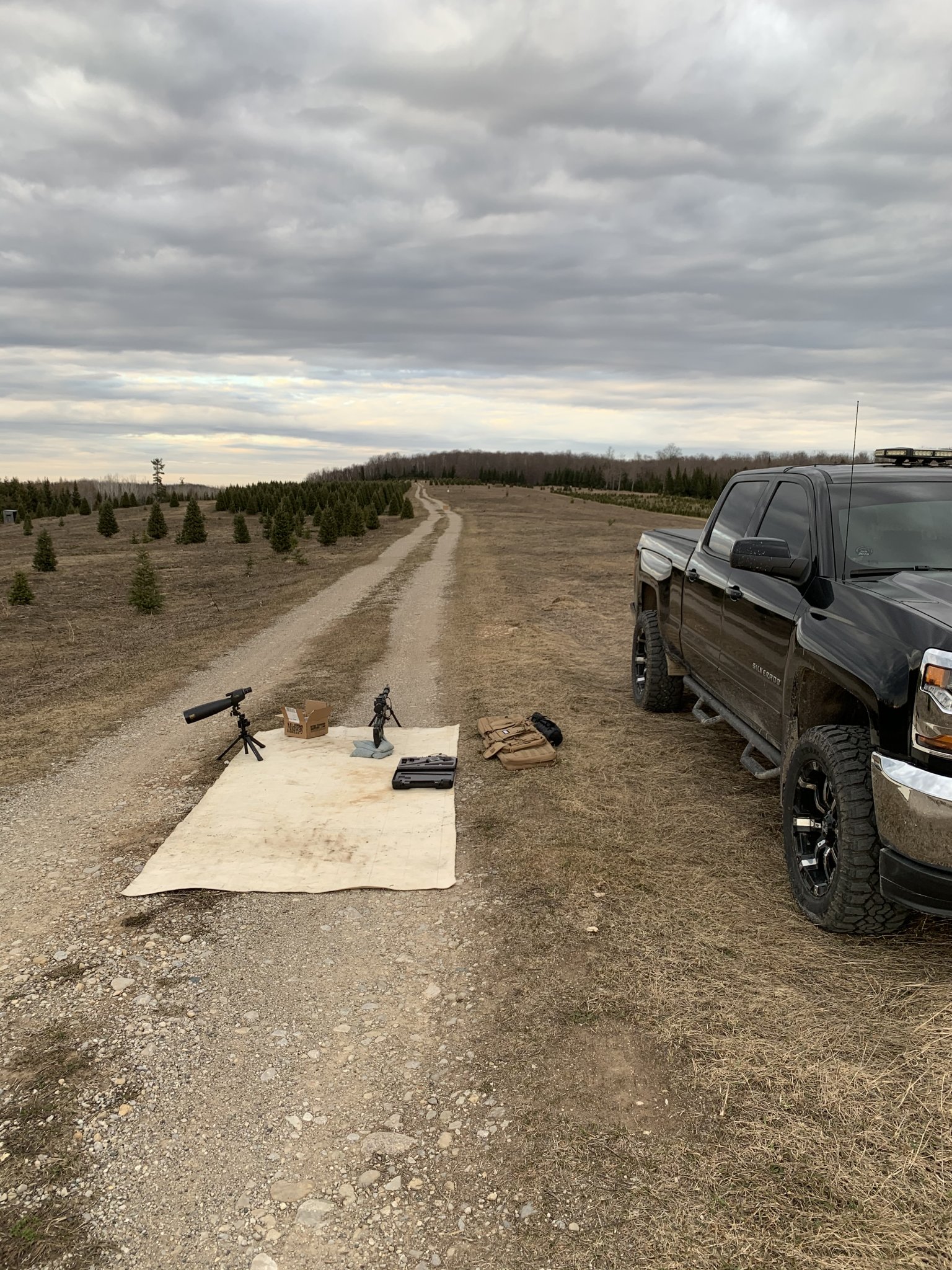

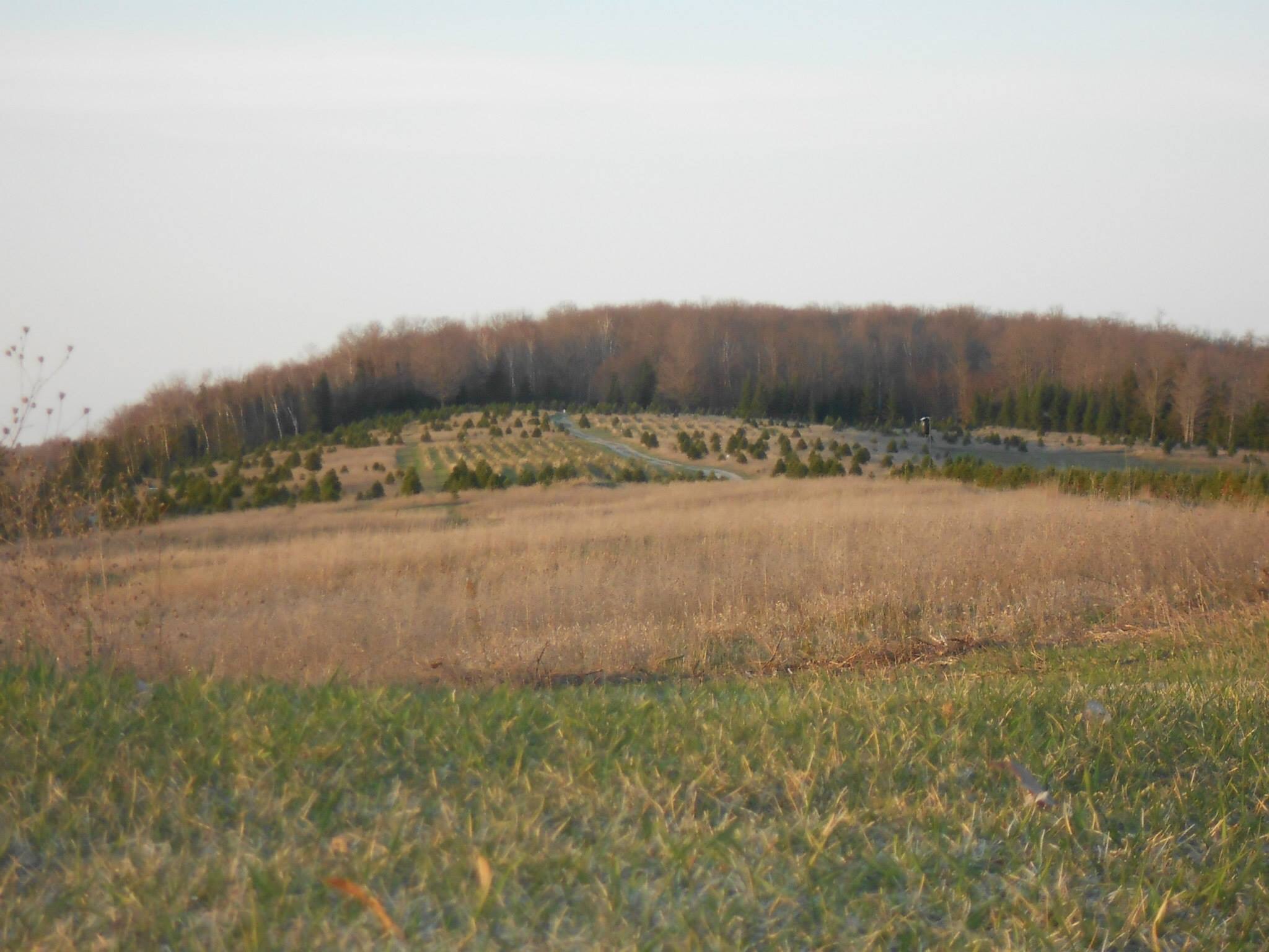

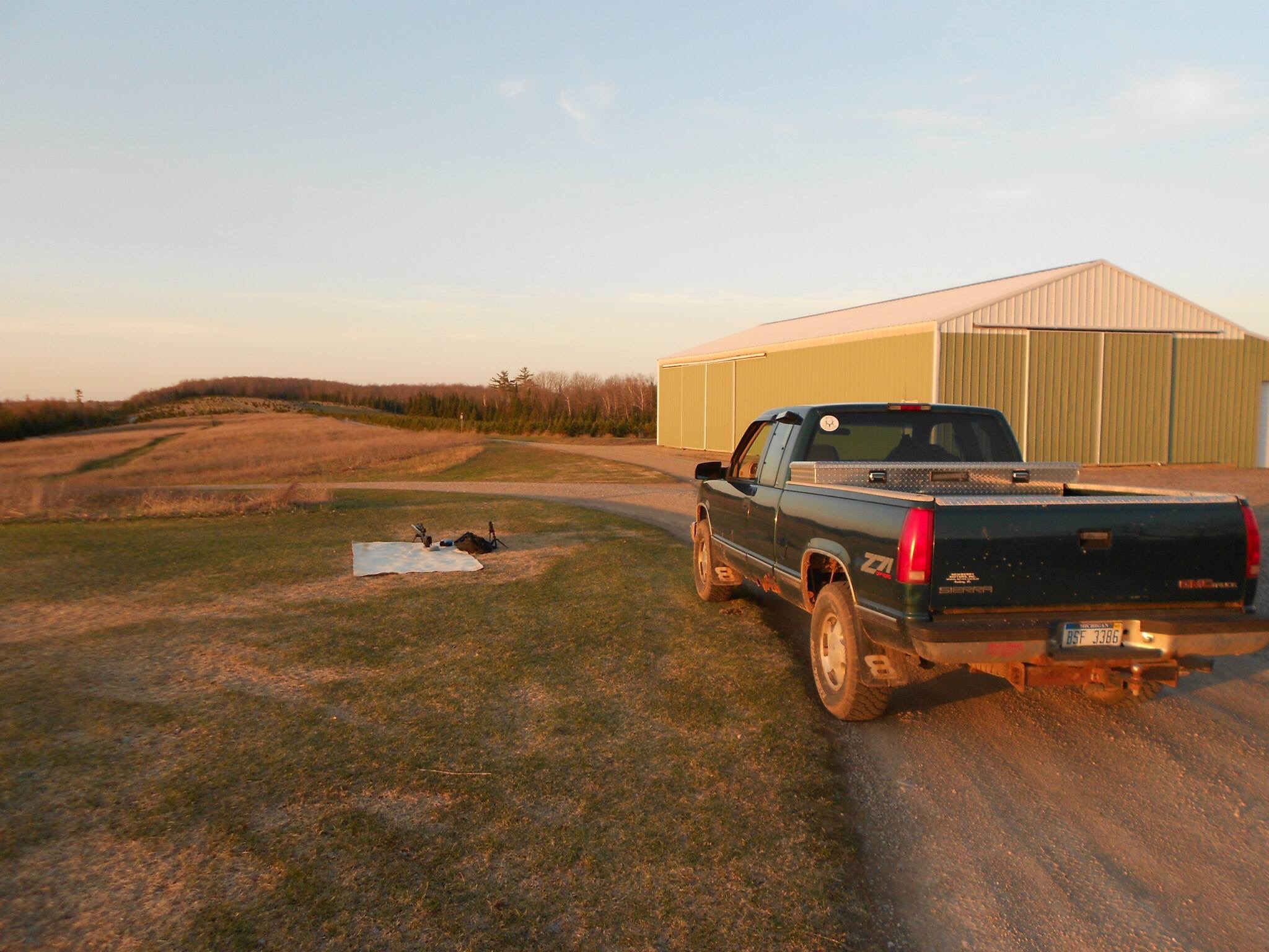

    View attachment 7885464View attachment 7885465View attachment 7885466View attachment 7885470
    Is that a Christmas tree farm?
    Thanks guys, hadn’t considered railroad ties but will look into that.
