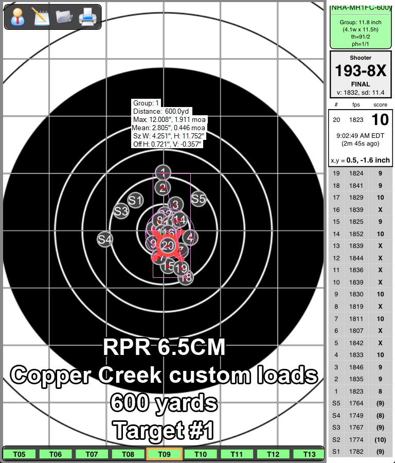

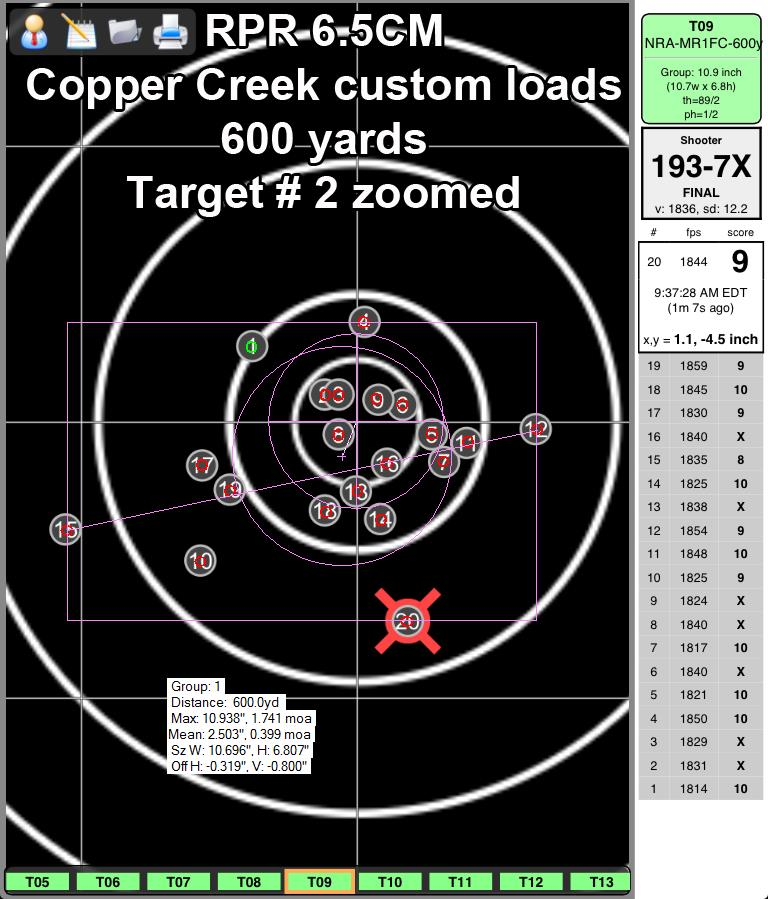

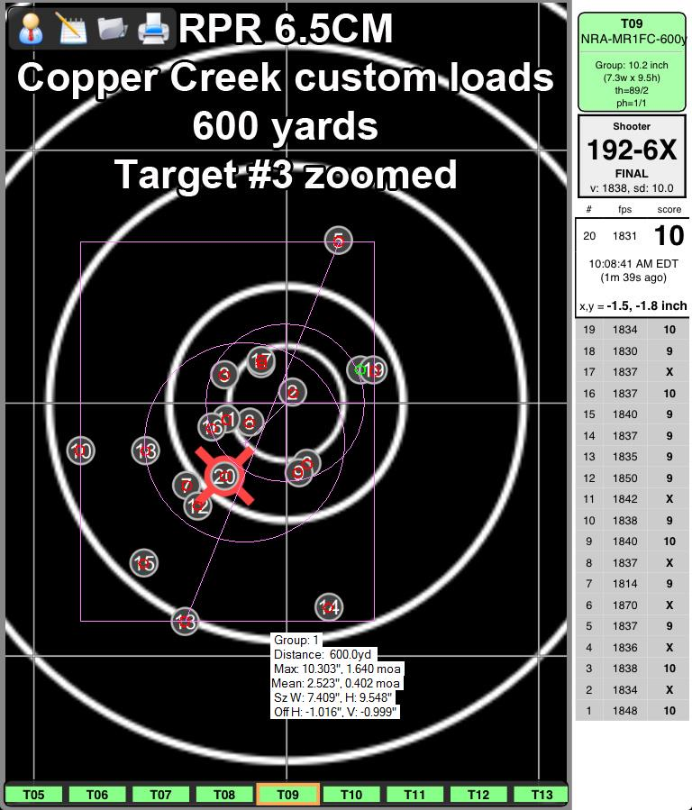

I did this on my 2nd time shooting my RPR at 600 yards at an F-class match. Nothing to brag about, and I came in 6th place out of 8 shooters. I was "unclassified" and the two I beat were an "Expert" and a "Master." :)
For the 2nd and 3rd targets, I zoomed the e-target on my ipad before doing the screen capture.
Target #3

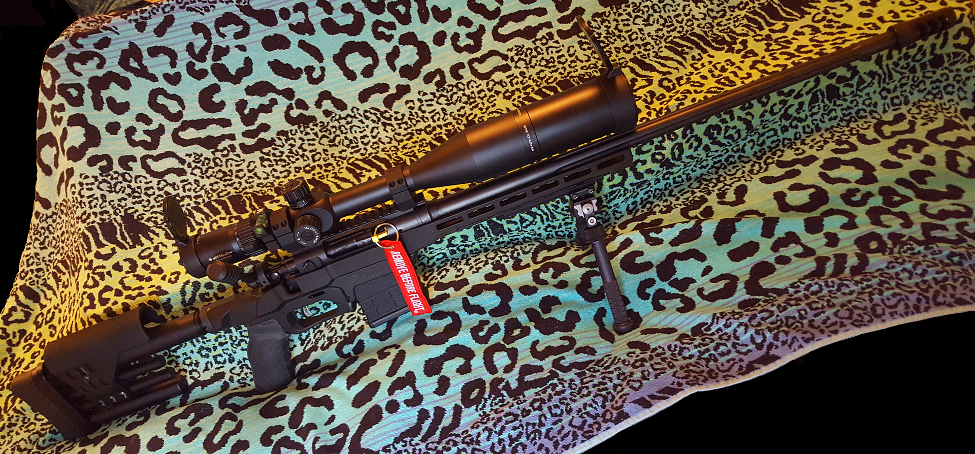

I started in the same direction a couple years ago with a Savage 10 FCP-SR 24" in 6.5 Creedmoor...plastic stock, AccuTrigger. Threw the stock away and went with an MDT LSS-XLGen2 chassis and XLR Extreme buttstock and went from there. Always been sub MOA gun even with the original stock. Now with the Goodies and handloads I'm .5 MOA at 100 yards. Only shot steel at 600 and 1000....shoots palm sized groups consistently at 600 with handloads.
I have roughly $2000 invested with the Athlon Argos BTR 10-40X56 scope and just added an MDT Vertical Grip not shown. MDT and Savage is a drop in and go arrangement and I have done everything without the help of a gunsmith or anyone. I never intended to be competitive but some guys at my Club are soliciting me. Not sure about weight requirements for the various disciplines.
