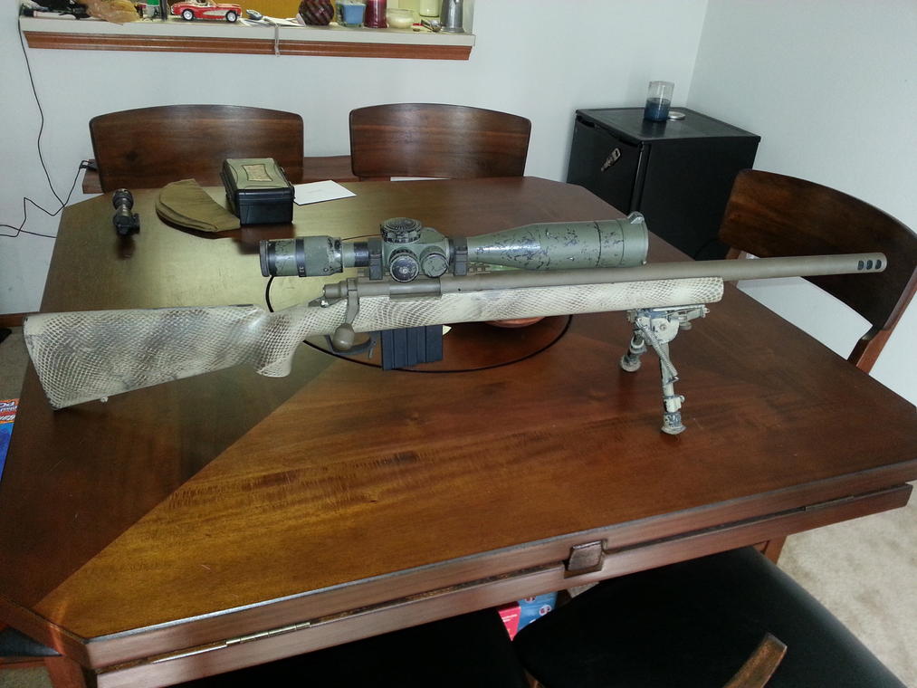

You can get the HS stock for around 200 get it inlet for another 75 and the PTG bottom metal that acccepts AI mags is 125, Thats 400 for a decent stock with a detachable mag setup in fact I might post a pic of mine for ya I have the badger M-5 bottom metal but it looks the same as what I just posted. Stand by for pics tonight.

I was going to post this the other night but I was haveing issues with my phone/computer interface.
Keep your eyes out in the for sale section on here and you can find a take off PSS stock for around 200.
Here is a pic of a the gun I put together as a utility/truck gun.
