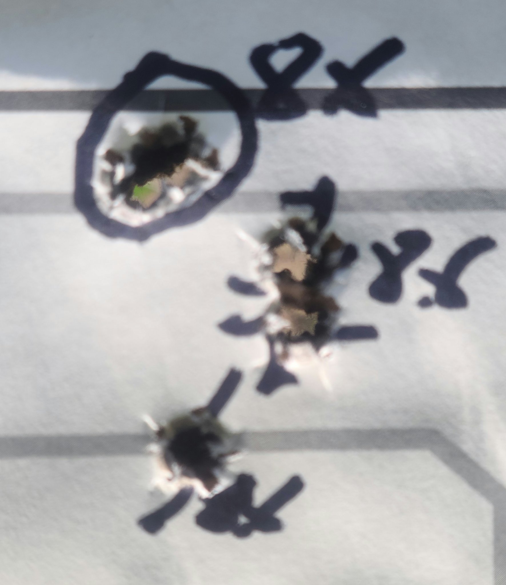

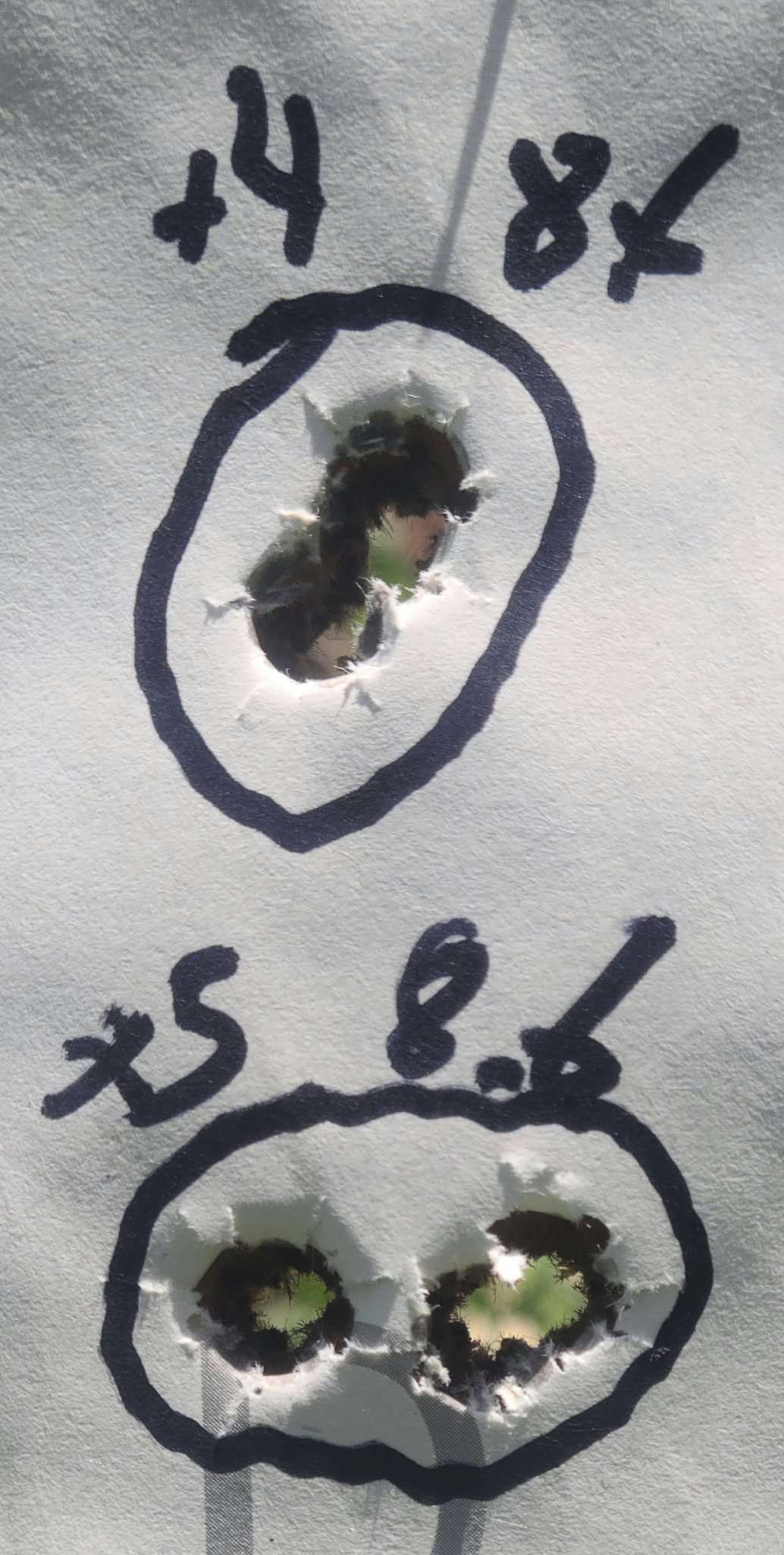

During break in my first 2 shot groups were pretty tight for just messing around. So on group #3, #4, and #5 I went ahead and tried to shrink them and then adjusted my scope zero. Might be a mistake and have to readjust later but as you can see in the pictures, not too bad for the first 15 rounds out of a new build. Pic 2 is group 2 and 3(@ 6mm total size) while pic 3 is group 4(@ 7mm) and 5(@ 9mm). I pulled the last shot of group 5, I knew it was bad before I even felt the recoil. But I was getting excited about the size of the groups, so of course I ruined it. Shots were at 100 yards with wind at 5 MPH and roughly 80% value. Ammunition was the Gorilla 8.6 BLK 210gr Barnes TSX supersonics.

Nice groups, LR-308s are frustrating unless you get all you parts from the same place in my experience. Looks like it shot well. How was the fouling in the barrel, I would figure the 1:3 would chew up some of the copper
Not as bad as I was worried about. But then I was cleaning every 10 rounds. However as I posted in the reloading thread I plan on reloading with CFE-BLK to minimize fouling. I hope to shoot it a lot. The recoil Impulse is very manageable. I would place it below 308 or very close. I need more ammo to try it with the VLTOR equipped lower which includes a 5.3oz buffer and improved spring over the stock rifle style components on the 6.5 PRC's lower. If the new lower reduces the existing recoil it might come down to 6.5 CM levels.. which will get expensive because I love shooting 6.5 CM.
