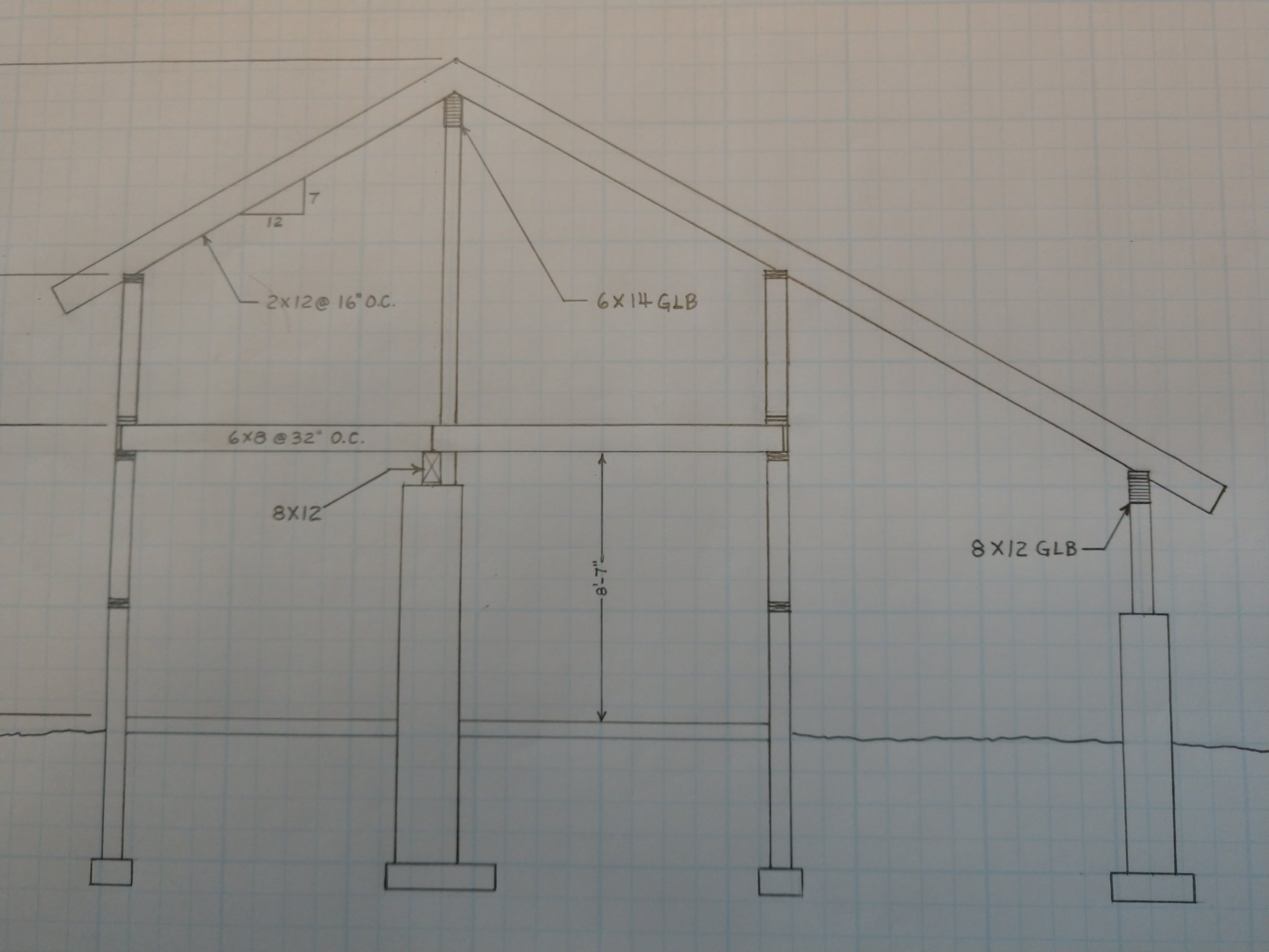

Basically my roof will be extended (new construction) 14-ft out beyond the edge of the house, highest part approximately 15-ft sloping down to 8-ft. The roof needs to follow the same line (7/12 pitch) from the peak to the extended over-hang (call it a porch or carport for now) to allow for easy snow shedding. That's why I can't have a stepped roof with a lower pitch, because of the huge amount of snow I get.

What's that roof rafter/joist size? That 8x12GLB should carry your load, but that will depend on the span between posts. I'd get in touch with a structural engineer first, and try and determine your framing assemblies / connection details.

2x12 Select Structural rafters 16" on center. 2x8 Select Strut walls 16" on center. 11-ft span. Ran this by several engineers, and they all say it's over-engineered.

If your local engineers say it's GTG, that's step one.
If you're leaving the three other sides open, I don't think they can call it anything other than a covered outdoor space. IBC won't necessarily dictate usage except through their occupancy classifications. Ag will be different than R-3 Residential for obvious reasons - life safety.
