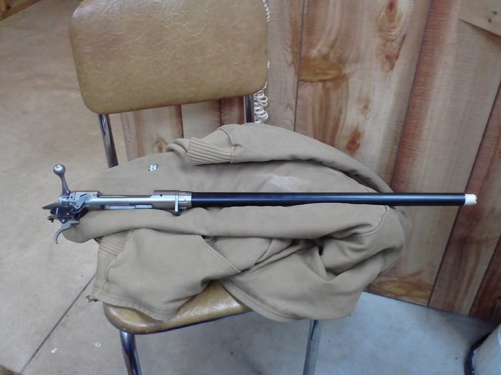

Well, thought I would put up a small update. This last weekend I got a hold of a barrel wrench from a buddy. Took the action and wrapped it with a piece of lead. Sounds crazy, but it was sheet lead and it worked great. Put it in the vice, threw the wrench on and gave it a few taps with the hammer and the old barrel broke free. Went a lot easier than I thought it was gonna be. Spun it off and we were in business. Spun the new barrel on to see what it would look like. All I have to say is this is gonna be badass.
Still waiting on my stock. It is currently backordered from eabco.com. Kind of a bummer but it was on sale and I got it for $400. I guess I will just have to wait. Also did a little trigger work and managed to get the stock trigger down to 3.25 lbs. Gonna see how it works before replacing it with a new one. I have found a brake that I am going to put on it, not the Cooley that I listed before. I am not going to go with a Shrewd. I found it on Brownells for about $60. This way I dont have to mess with getting the other one timed.
Well, it isnt much to look at, but it is progress. Here is a pic.
Hopefully soon I will have the stock and we can set this thing in place. I will update the progress.

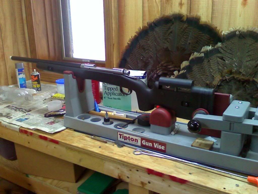

WEll, update time.. Got the stock in. That is about it. I also ordered a brake from Brownells. Went with a non directional brake to avoid machining cost. I know I am being cheap, this is a first run. Curious to see what happens with all this. The next one I will not go so cheap. But just havin fun and want to see what this can do. Anyway.... Brake and go no-go gauges will be here next week. Will be time to slap this thing together and start to think about glass and mounts. Here is a current pic..
