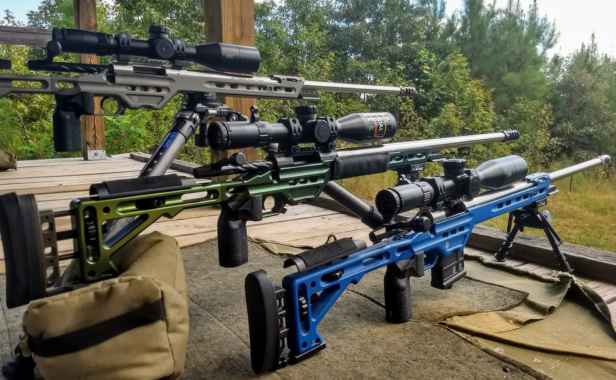

My choice for PRS is MPA chassis, with weight kits to add some weight and more importantly balance my rigs. It's a very versatile chassis and #1 among PRS shooters using chassis by a wide margin. I have a 6 Creedmoor and 6 Dasher. Varying barrels, and the MPA weights allow all to balance.
If you prefer stocks, Foundation offers Impact 737 inlet, got one ordered myself to play with. Manners T4A are very popular and I've got one with Area 419 arca rail that offers some of the chassis adjustability in a stock. In either case, consider what barrel will balance the rifle.

Not a bad choice. FWIW my trainer rifle is MPA and a 26" Heavy Palma contour, I like that balance on barricades. My match rifle is MPA chassis with all the weight kits except bag rider, 6BRA in a MTU 27.5" barrel. Heavy gun, but good balance. I strongly prefer the heavy rifle for competition.
I'd go at least Heavy Palma or M24 contour for your barrel if you plan to start out with no weight kit.
