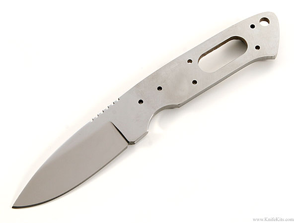

I am thinking something similar to this with a slightly longer , thinner blade and no finger groove . I have 2 or 3 different steels including D2 available . There are several outfits here in town that do heat treat and would probably Love the business . Not 100% on what I want for grips as of yet .
