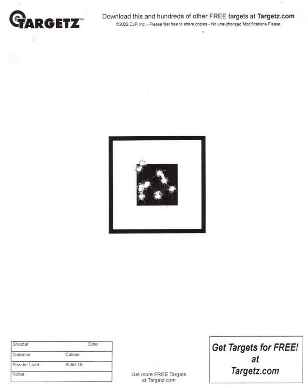

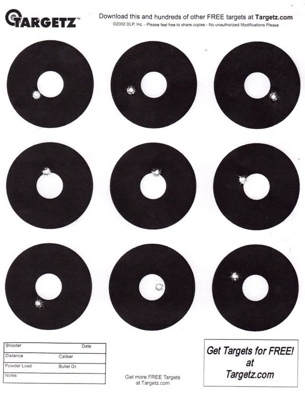

Stopped by the indoor range on my way home from work tonight.
All of these were shot standing w/sling (except for the last two on the Appleseed target) at 15yds with bulk Remington ammo. The first two are one-inch squares, the multi-dot target is 1/2" center in a 3" dot:

Pretty good Donut! did you shoot the last two Appleseed targets kneeling & prone? Appleseeds are shot at 25 meters, or 27 yds. Looks like you will be good to go. What ammo will you use?

Kinda. For the Kneeling, I bent over and put one elbow on the little shooting shelf, and for prone I put both elbows on the shelf. It was slow enough at the range that I probably could have gotten on the deck without getting in the way, but I wasn't exactly in activewear. LOL
I think For the Appleseed shoot, I'll be using some 40gr American Eagle I have. Not the best, but better than the bulk stuff.
