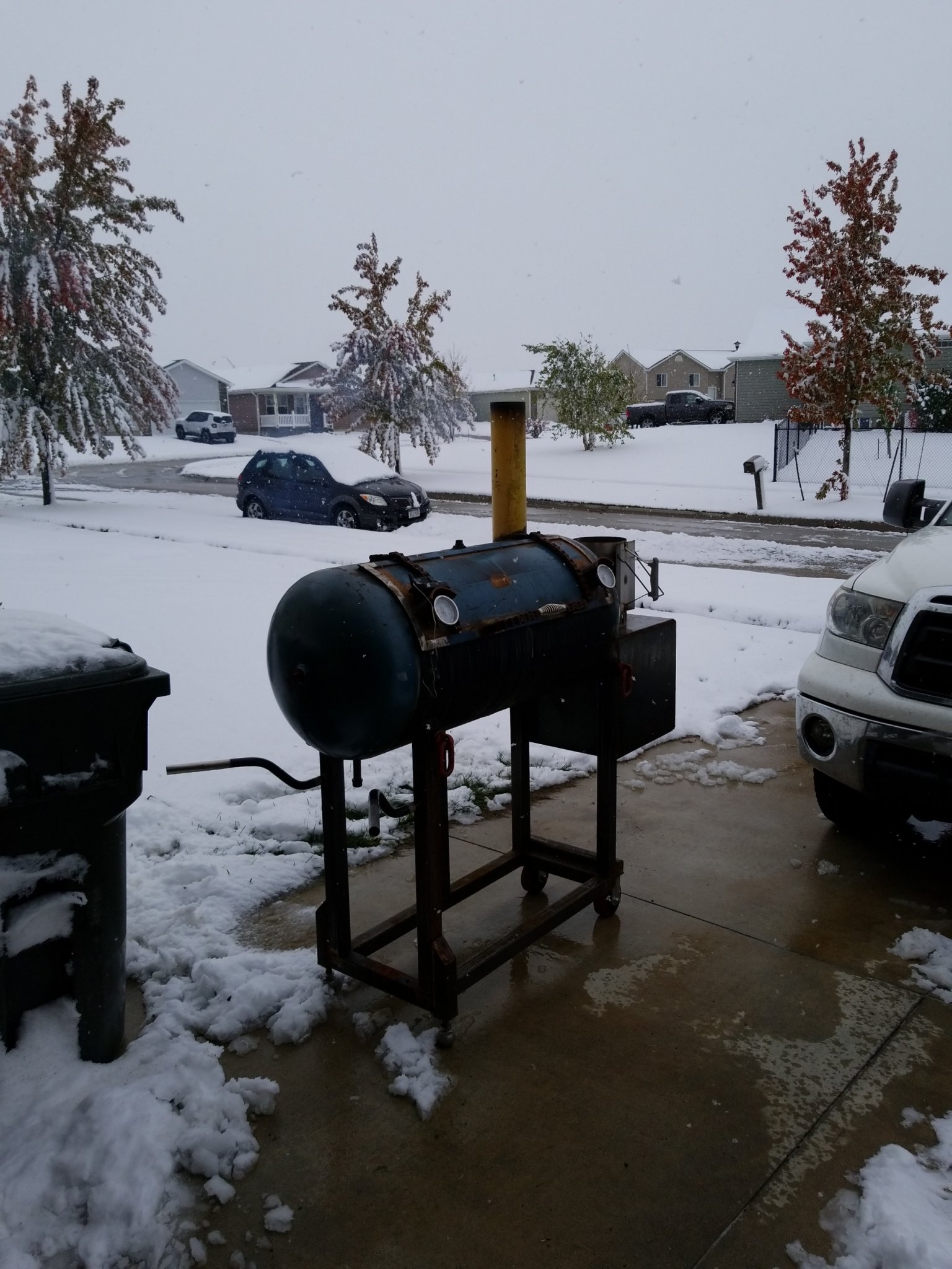

    Here's my reverse flow. The firebox is on the right, but there's a plate in the cook chamber that directs heat and smoke to the left before coming back to the right, over the food and out the stack.
    I can get as low as 200 degrees, but not much, if any, lower. I can get to 325 or 350 for chicken though.
    No electronics, just man, fire, and meat!
    Between me and the smoker, we can put out some damn tasty food!
    I can fit about 12 racks of ribs on rib racks, six or 8 chickens and probably 8 pork butts.
    But only about 15 pounds of sausage. I need a vertical for making sausage.

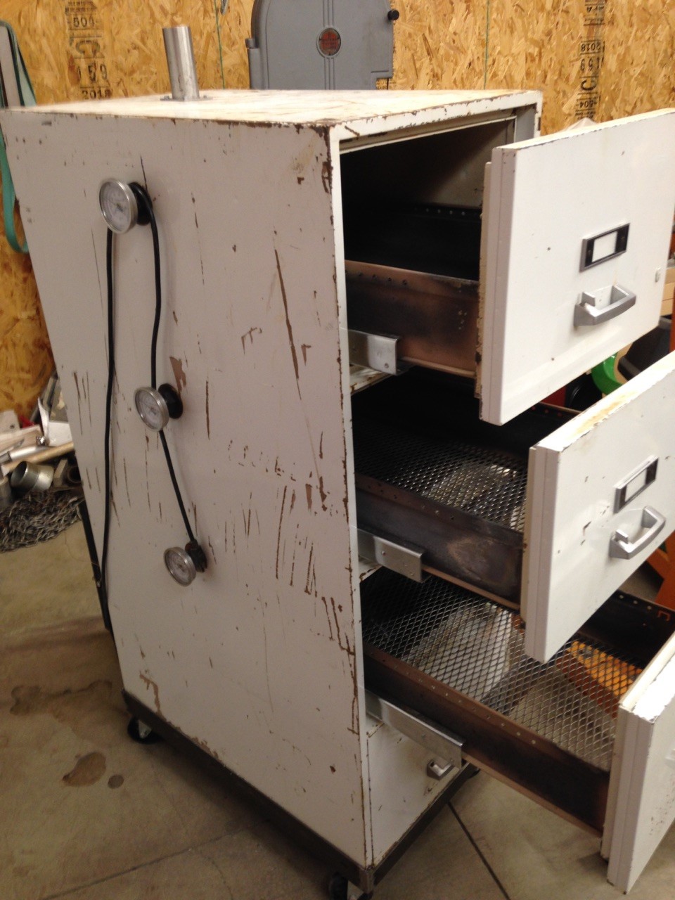

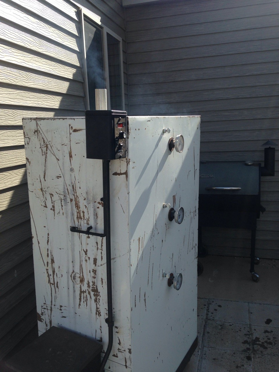

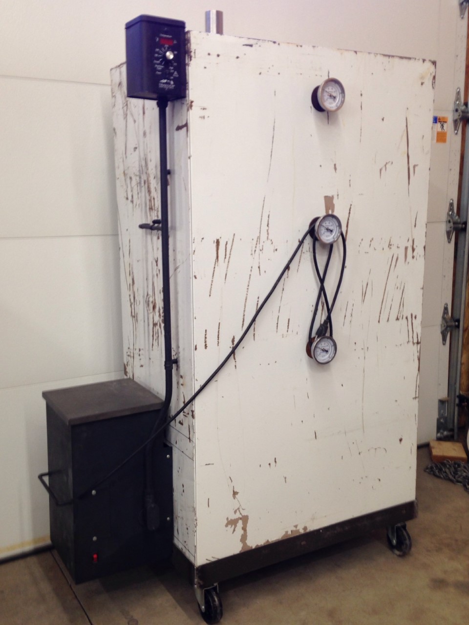

    With the grill threads lately I realized I had not answered @Sean the Nailer 's query on the smoker build. Here are a few photos. Cooking screens in the drawers, Traeger firebox, relocated controls, adjusted pause setting. Works well.
    Questions? Ask away or PM and allow the thread return to the darkness from whence twas summoned. :)
