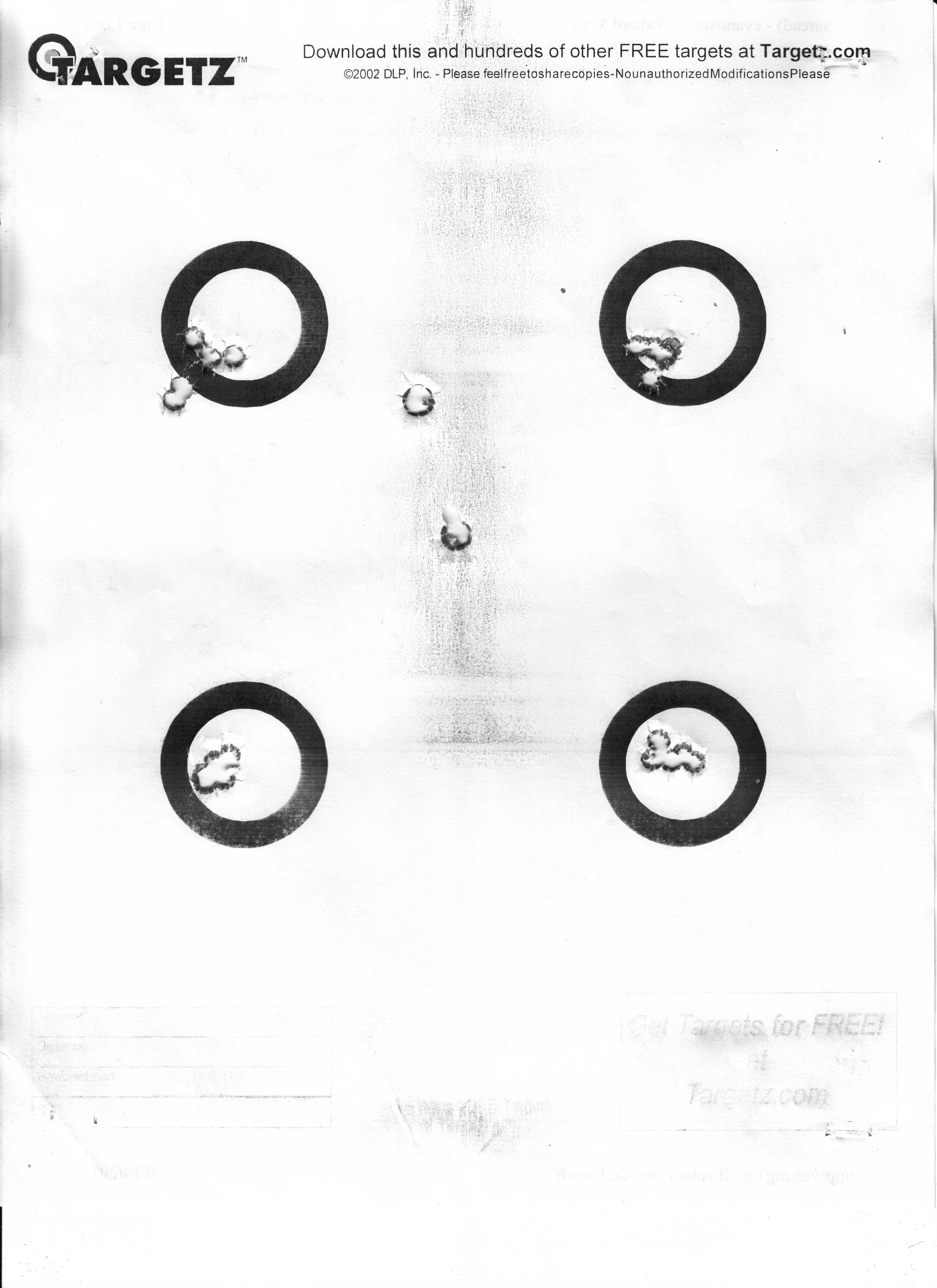

With the 75 Hornadys I shot the groups below at 100 yards with a 24" Kreiger 1:7.7 barrel in an AR, so gas guns are not inherently inaccurate as some would have you believe.
The group in the upper left was when I was dialing the scope in.
Ignore the .308 holes in the center of the target, and you'll see 4 five shot groups measuring .34, .33, and .28 MOA and the upper left .62 MOA
