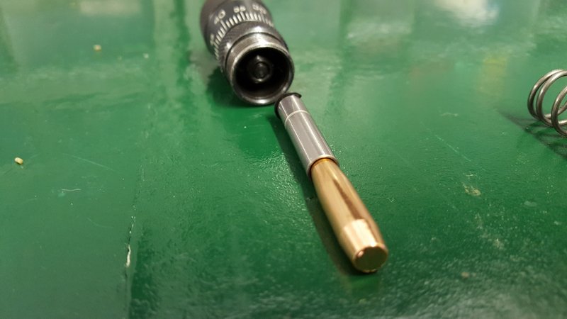

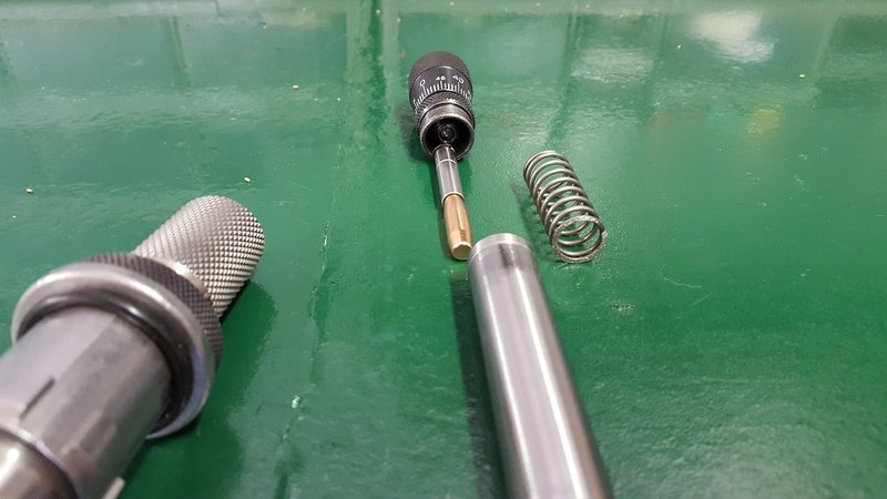

I'm not saying you're wrong, but I just looked at the seating die and the seating stem sits right under the the shaft from the micrometer top that screws up and down. That shaft contacts the seating stem solidly how could there be any variations with that shaft pushing the stem?
I use a lot of Redding micrometer seating dies. Every single one of them will give inconsistent seating if I don't have neck tension consistent. Also, the stem is not (no matter the die maker) a universal fit for all bullets. I've actually seen seating stems deform from having to much pressure or seating an incompatible bullet shape.
Do you see any ring around the bullet where the seating stem contacts it?
No, no rings or anything. Ok I have some new brass that should be more consistent I hope.
Also, I took the standard seating stem and swapped it for the VLD seater stem because the regular one was bottoming out and wouldn't seat the Berger

It the copper flexes just .001" different due to neck tension differences, and the seater contacts it at an angle, it makes a big difference in the OAL measured with a comparator. It is a similar reason that small bore diameter increases with throat erosion makes a big difference in the distance to the lands.
.001"/tan(1.5deg)=.038"
That's .038" difference for just eroding .001" off the tapered 1.5 degree face of the lands.
Breaking the edge of a seater or comparator just spreads out the material flex more and reduces that variable.

As for the original question, the chamfer on the comparator is most likely to get the bullet started in w/o a cant. One of the best ways to insure consistent seat depths is to run the vld seat stem in that comp seating die you have, even better to seat a bullet with a die the next size up, ( seat 6 creed with a 6.5 creed die), the seat plug or stem grips the bullet farther down the ogive and can only produce better results.
