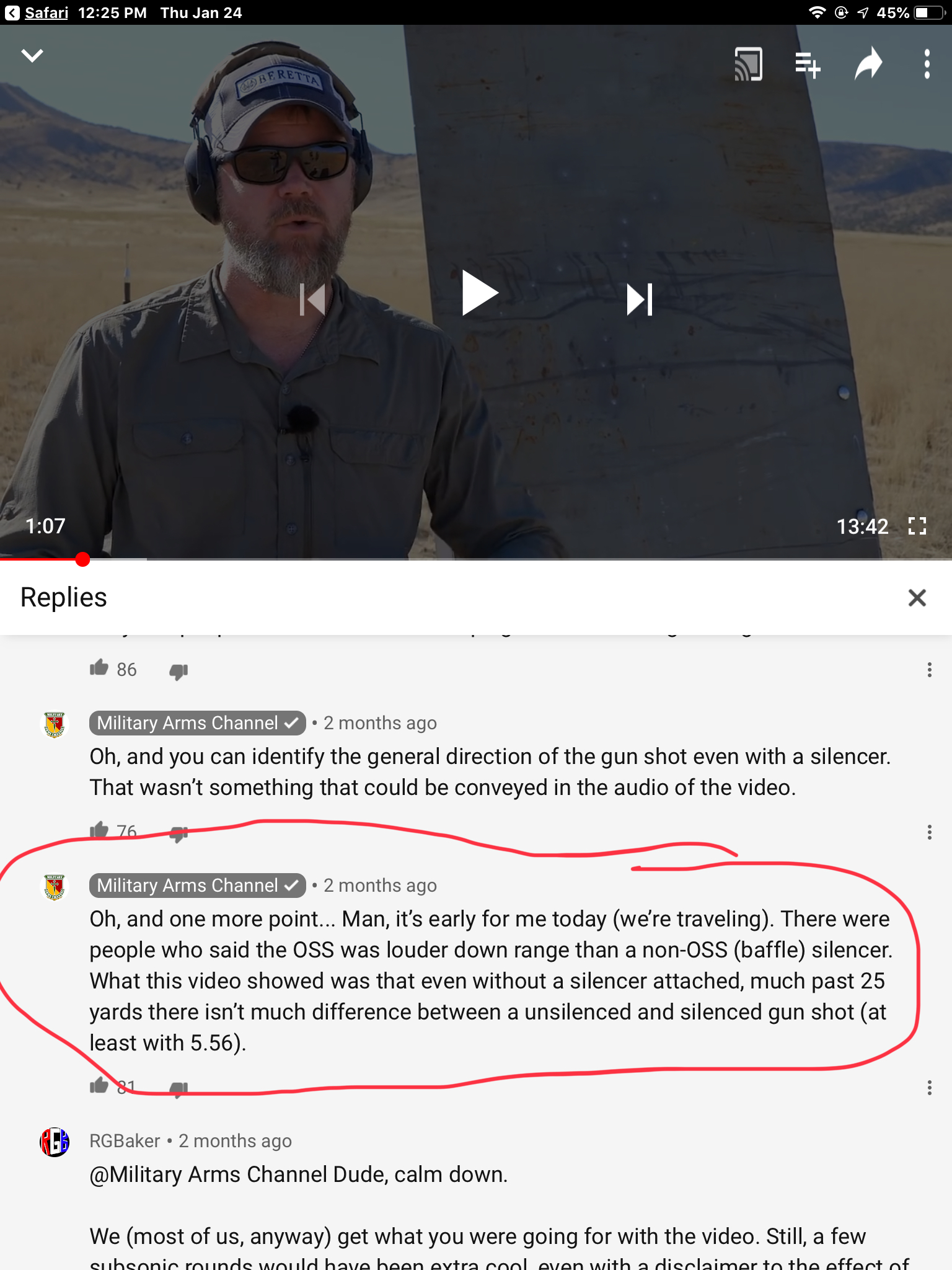

I know this thread is a few months old but I just saw it. I have a slightly different take on what the sound meter is picking up. If the bullets that are sub sonic there should be no bullet crack. However, they are shooting at a target. Is it possible that the sound meter is actually picking up the sound of the bullet as it is going through the paper target? Maybe they need to do the test again but not have the bullet hitting anything.

Could be the mini crack of when the bullet is trans sonic. Check this out to see what I mean.

Well all interesting for sure and proof that anecdote and data are two different things. Wish I could afford a mil spec sound meter to do some more hard data collection. Certainly environment in terms of echoing etc would play a role, so tests done in flat open areas, mountainous treed areas and rolling plains would give different results.
