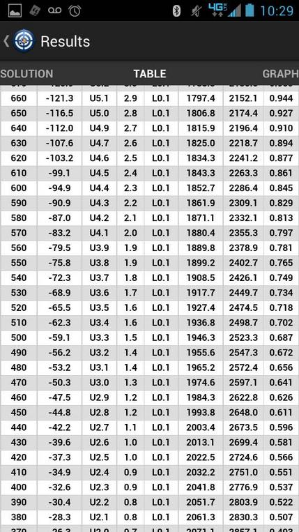

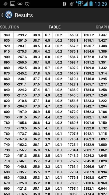

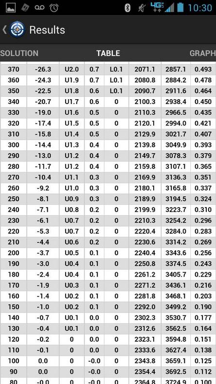

I run a straight-from-the-factory Barrett 98B with a 20" barrel. I reload lapua brass with lapua 300 grain HP and 85 grains of vihtavuori. I can't remember if I figured 2400 fps or 2500. Ill get back to you on that. I'm also down in south Florida where the temp is the same as the humidity (90ish) and the elevation is lower than your shoe size. You guys are super helpful btw.
This should get you started. Based on a 2450mv, sea level, 85f, 80% humidity, and a g7 BC of .389(the 419 BC on the box didn't match up with my trajectories at all, and .389 is what resulted from a range test by several of the guys on this site during a gunsite XLR shoot/bullet test.
View attachment 17215View attachment 17214 uploadfromtaptalk1380087531462.jpguploadfromtaptalk1380087590635.jpguploadfromtaptalk1380087601492.jpg

View attachment 17215View attachment 17214View attachment 17217View attachment 17218View attachment 17219
