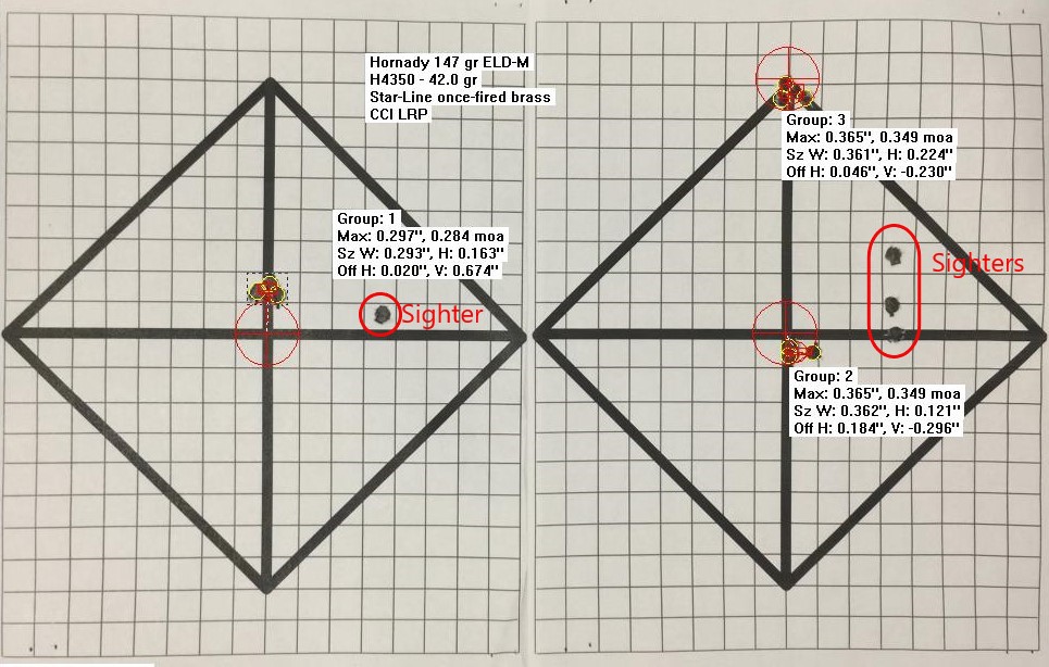

It’s not uncommon for me to find the best shooting loads by jumping .050 to .080; the barrel I’m shooting now is at .070

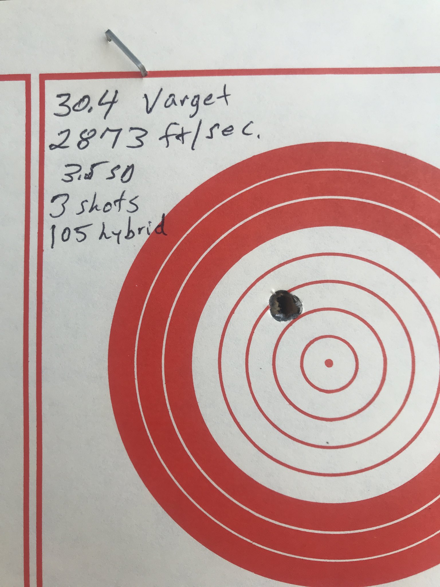

Berger Hybrids like to be jumped from 40 thou to even 130 thou off lands. Mine are usually from 40 to 80 off but my friends rifle likes 130 off. There were several other good depths but 130 was best.

Wow, and I was worried about .050" jump. That .130" is a lot.
