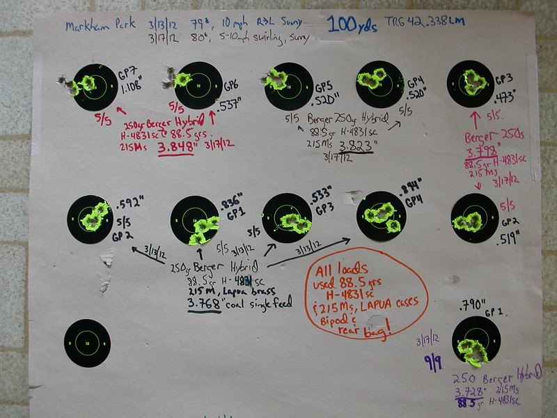

Over on 6mmBR forum, there's an article quoting lots of champion shooters and for some reason, many like .017" off the lands.
Load some up at .005", .010", .015" and .020" and see what you see.
I was on board for the Berger .338" 250 OTM hybrids and only had time to fiddle with seating depth and as I got closer to my lands on the TRG-42, thing opened up a bit.
Not conclusive, or a large sample size, but it was interesting nevertheless.
Chris
