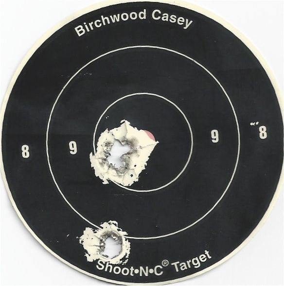

My experience is that they like a jump of about .030. 175 SMK, 43gr BL-C)2)
100yds 5 shots of which was one was a choke on my part.
My rifle built on a Remington 700.

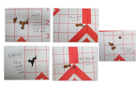

A few pics
Here is a collage of today's groupings. I can't shoot 5 without at least one flier...
