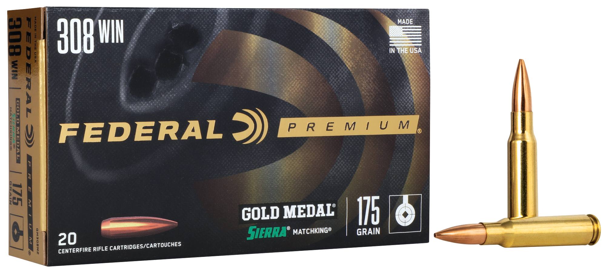

I'm getting into an AR308 with an 18" JP Supermatch barrel in 1:11.25
I would like to know some recommendations from those who know for bullets that I can try to feed it to see what it likes.
I would like suggestions for a:
1) Plinking Bullet - ?unknown?
2) Match Bullet - 175 SMK?
3) Hunting Bullet - Barnes 150gr TTSX?
From what I have read, these barrels often tend to like 175 SMK, so that was what I was leaning towards for a match bullet. Honestly, I will probably very rarely shoot the expensive match stuff - but I thought it might be useful as a baseline criteria when searching for other bullets.
Basing a hunting bullet off of the 175 SMK, I like all copper - and I came across the 150 TTSX
It looks like the copper 150 TTSX is within 5% of the length of the 175 SMK, and I feel like the lighter copper bullet would lend well to the velocity the copper bullets need for proper expansion. Please point me in the right direction if I'm misguided.
For plinking - which is what I would shoot by far the most of. I have no idea.
I would very much love to hear your from your experiences on which bullets I should try to feed this barrel to see what it likes in those three profiles. Thank you all very much in advance.
EDIT: I forgot to mention that the majority of all of this ammo will be shot within 300 yards.
An 11.25 twist handles a traditional bullet up to roughly 190 grains plus or minus a little, but for example is marginal with the 200.20X bullets where sometimes they work and sometimes they don’t.
Nothing wrong with the bullet you show. I would not hesitate to exploit any good competition target bullet that was on sale up to 190. You are more likely to find something like the 168 or 175 SMK to be sold in bigger boxes for a better price once in a while.
There are too many options to mention but nothing wrong with any of them unless you want to be more specific with distance and type of shooting you will want for those target bullets. For example, up to 600 yards the 168 SMK is fine, but it isn’t a good choice for 800 to 1000, especially in that 11.25.
As for hunting bullets, I’ll assume stuff like deer or elk and say there is nothing wrong with that TSX or the TTSX as long as you stay within range where the terminal effects still work. You might get farther with a traditional Sierra or Hornady cup core bullet like a 165 SGK or Hornady ELD-X. And nothing wrong with a 150 grain either.
As for plinking, once in a while Widener‘s puts bulk 150 FMJ on sale for a good price. If you keep the ranges short they can perform and they are about $0.17 a piece, and sometimes they sell the Speer 125 grain TNT for about $0.18 per piece.
I tend to recommend you standardize on bullets that are more often available and for a good price, but keep in mind that if you get picky the Berger and Sierra target bullets are not cheap but you won’t get good performance with poor quality bullets once we are out past 300 yards or so.

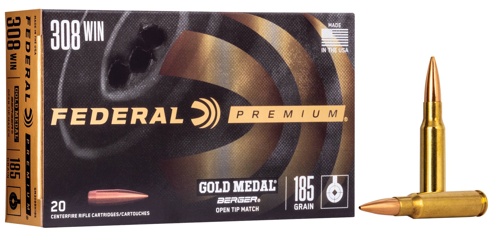

168gn SMK is a good choice inside 300yd and save you a few bucks too
175 or even the 185 juggernaut for 500+ yds for match stuff
147gn FMJBT stuff for plinking. Find it as cheap as possible and go have fun.

Whatever for plinking but I use Berger 185 Juggs for match and 185 Classic Hunter for kills. Any of the above mentioned will work but I like heavies. Varget works great when. you reload.
