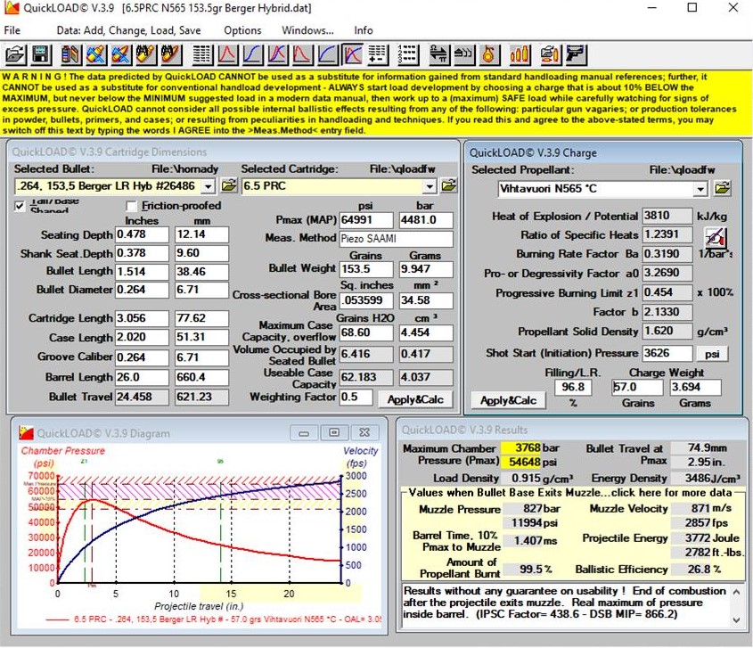

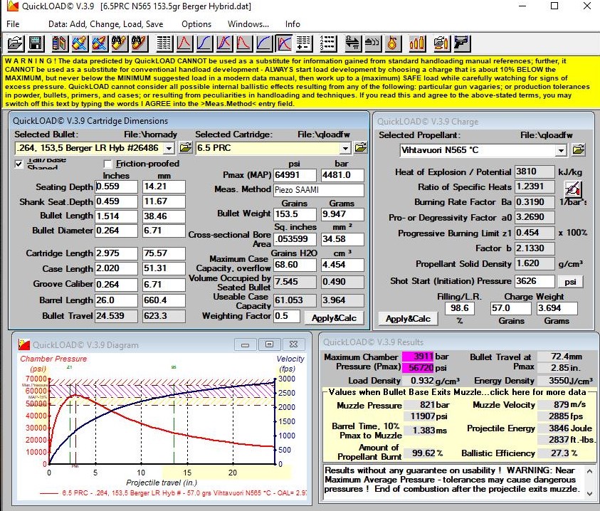

Hmmmm??? Then how do you explain this?:
Do you think I could run the 390 grain hornady atips? They are 1.5in in length , but unsure if the 375 ruger has enough ooomph to move it a
View attachment 7930994 View attachment 7930996
Your screen captures prove my point. The peak of the red curves (max pressure) occurs after the projectile has traveled somewhere around 2 to 2.5 inches. (sorry, I can't make out all the details on your screen capture graphs.) So the bullet has left the casing and traveled more than its entire body length before maximum pressure is reached. Bullet jump is measured in hundredths of an inch. So the bullet has fully engaged in the rifling (effectively sealing the gasses behind itself) and begun traveling about 2" down the barrel before maximum pressure is achieved. Yes, pressure ramps up quickly, but it doesn't peak until well after the bullet separates from the casing.
That looks like some pretty neat information. What software was used to generate the data? Is it an online program?
The point is, when you seat deeper the peak pressure increases (as does the velocity) as well as decreasing the barrel time. What's concerning about pressure is the safe limits of peak pressure. When peak pressure occurs doesn't matter much . . . maybe, unless one is loading cartridges to be jamming the bullets into the lands. (BTW: click on the picture to enlarge it for viewing details better)

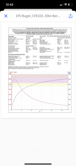

Peregrine monolithic sent me this for a 230 grain .
