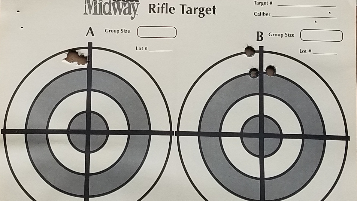

If you're designing loads for strictly indoor, 100yd shooting, I wouldn't concern myself with velocity at all.
I would choose accuracy first.
You might get lucky and have both.
Here's an example of accuracy vs velocity.
17fps difference in average velocity.
Guess which load I would choose 100% of the time.

I guess it'd make sense to say the highest velocity while remaining precise.
