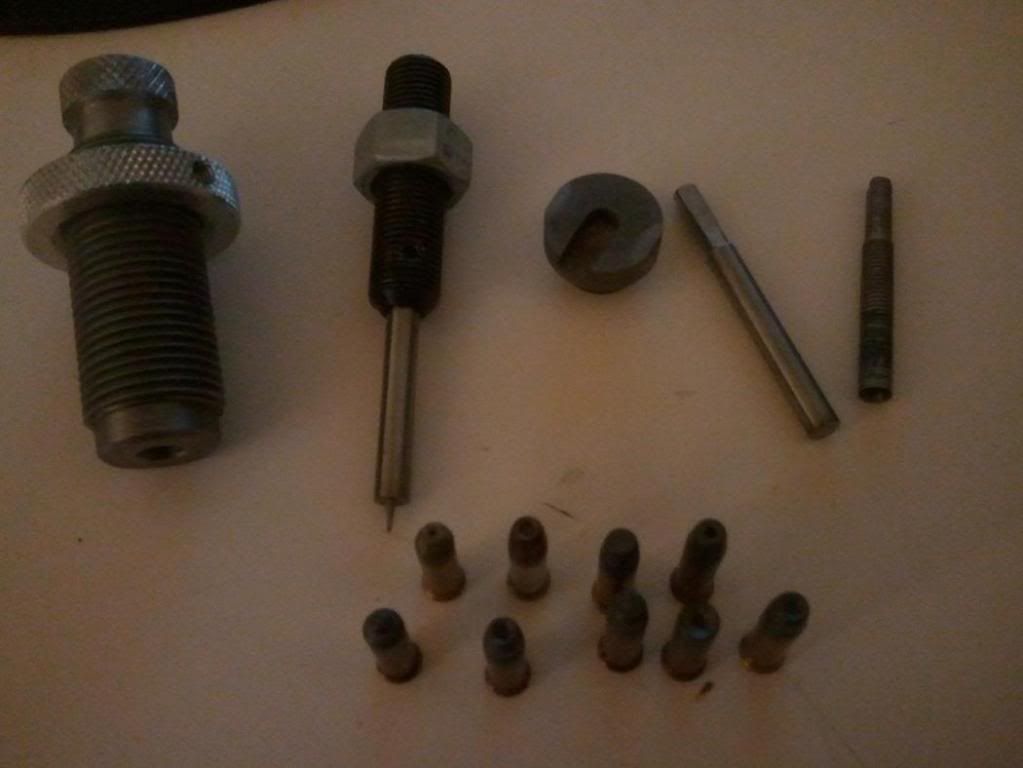

that's the nickname my .22LR sizer got. since it can seriously squeeze the shit out of a .22LR. it's threaded to work in any standard press and is fully adjustable. the maximum diameter it will size to is .226". the bullets can be sized far enough to totally remove/fill up the bands on the side of the bullet.the shell holder was made in two pieces and welded since we didn't have a small enough woodruff cutter for the rim slot.
the tool rod that is setup is for hollow pointing and will make a small or large hollow point depending on how far in it's adjusted. the other tool rods are for flat pointing and the far right rod is just a bullet seating stem for .223, it makes a weird nipple shaped bullet. nipple bullet is on bottom row, third from the right and also the first on the left in bottom row. they're hard to see, but I think you can make out most of the bullet shapes in the picture.
my favorite is what looks like a reversed wadcutter with the hollow base showing. it's on the bottom row, second from the right. that huge frontal section seems to really hit hard, and also make perfect circles in targets. i need a lot more testing, but groups have improved especially with bulk pack ammo which was the whole purpose of making it.

<div class="ubbcode-block"><div class="ubbcode-header">Originally Posted By: Dr. Phil</div><div class="ubbcode-body">Nice work!
That is the same way the Waltz Die works.
Just increase or decrease the depth of the rod.
Which ammo has worked best in your setup?
I know that Neil Waltz recomends Wolf MT with his. </div></div>

<div class="ubbcode-block"><div class="ubbcode-header">Originally Posted By: TOP PREDATOR</div><div class="ubbcode-body">would this happen to be a Neal Waltz die? or is it something you made yourself? </div></div>
we made this die in our shop
