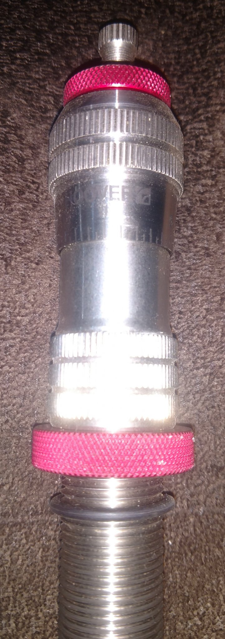

It is very easy to use once you have it setup. And one unit with a bunch of caliber sleeves will do all common bullets. I bought three of the Hoover units one by accident.
