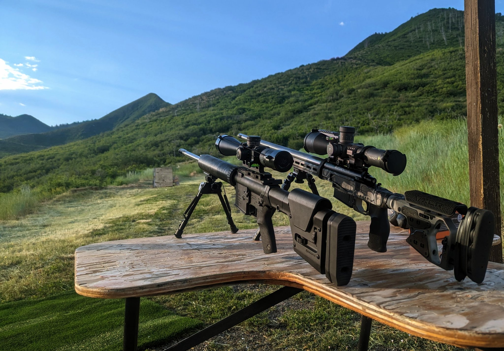

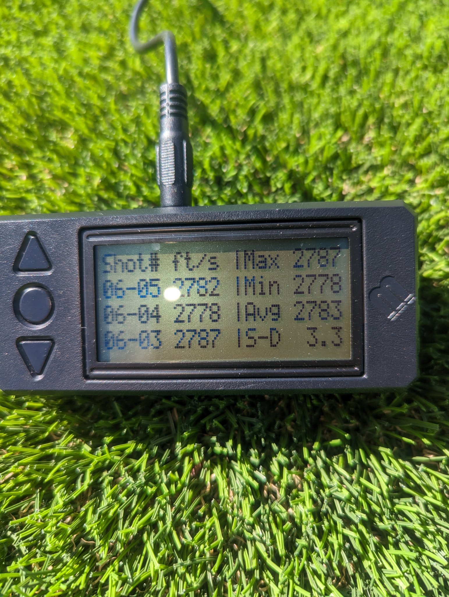

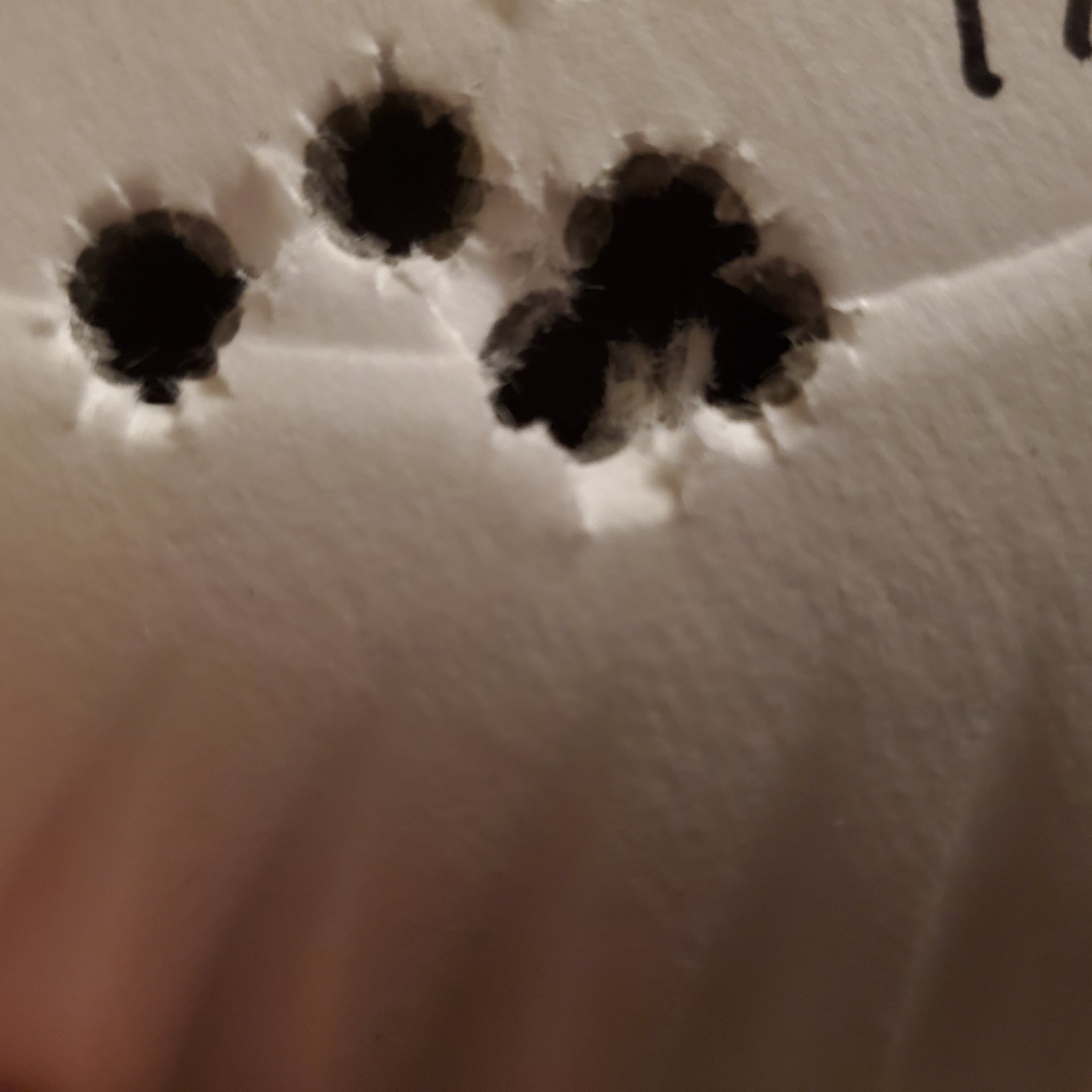

Just finished a new 16" light weight AR 10 6 lb 3 oz 308 AR10 I have been shooting the new 169 SMK and the new 177 SMK. It has a 1-10 twist the 177 SMK and 44 gr imr 4895 run 2584 fps ave 10.8 S/D in Lake City brass shooting 3 shot groups in .2" and .3" & 5 shots 3/4". Bad weather, hunting season, and an adjustable gas block that failed have dampend further testing...but 130 gr Speer Varmint is usually accurate in any 308. The 169 SMK were showing promise too and running a little faster.
Set it up for 1200 yds, to dial the elevation...confirm that later. This AR 10 has a WC Recon fluted barrel, titanium bolt carrier, 1 oz JG carbon fiber handguard, (3 oz with mounting hardware) titanium muzzle brake, magnesium upper...lighter than many AR 15s, at 6lbs 3 oz.
