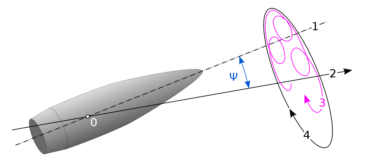

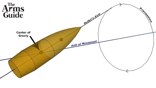

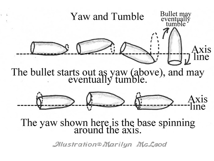

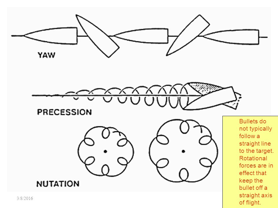

It’s where the weight is at.
Crudely: Ideally the bullet is spinning perfectly along its axis of motion.
7066608
7066606
7066604
But the real world isn’t perfect so any tiny bit that bullets center of mass is off of the perfect middle can cause the bullet to lose its stability. You’re restricted by bore size diameter so the heavier the bullet/the more mass for longer distance shooting the longer you are forced to make that bullet. The longer the nose the more it can decrease air resistance for better long range flight. The longer the bullet is the longer the fulcrum is that forces can cause instability can act upon. Twisting it faster can help to spread that force more evenly around the entire bullets rotational path so one side of the bullet doesn’t experience more drag that the other and begin the process of tumbling.
