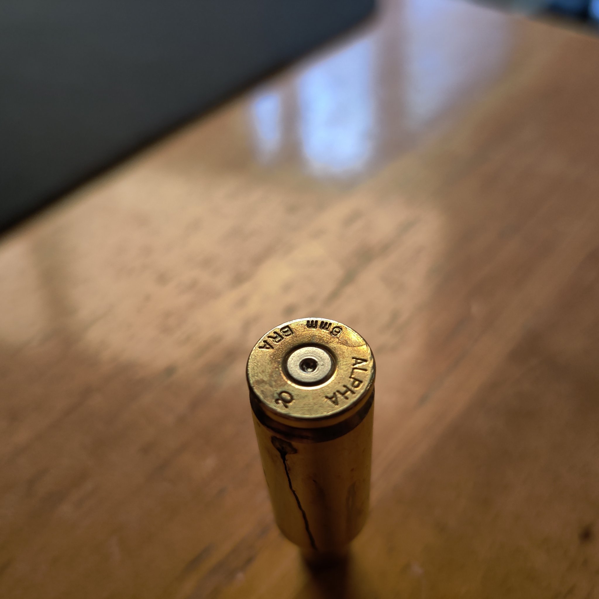

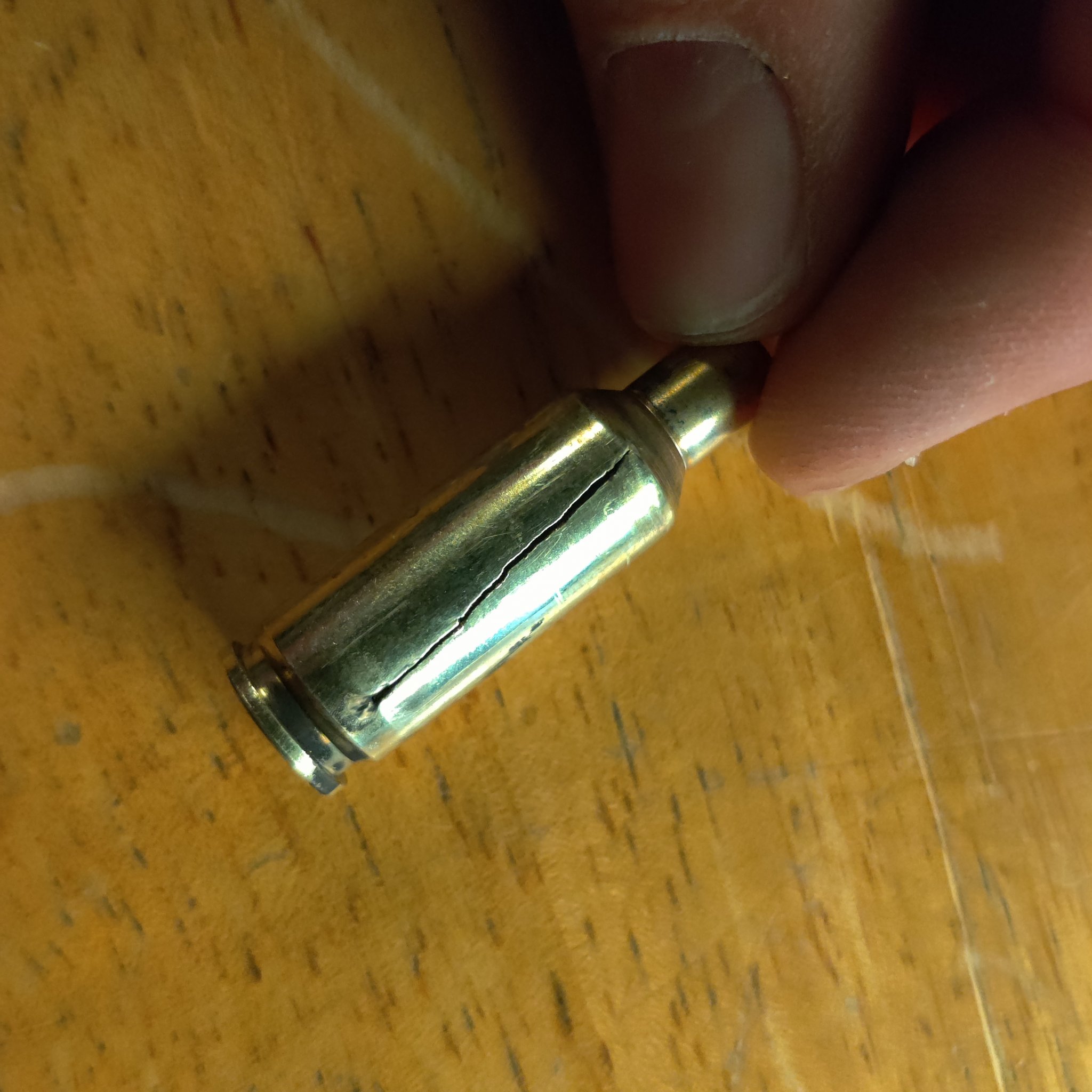

    This is the cracked case:
    Is it possible that debris from the cracked case was causing the issue? Perhaps cleaning it will solve problems going forward?
    View attachment 7876484View attachment 7876485
    That looks like either corrosion or burr/brass buildup on the draw punch that made the case leaving a big scratch on the inside. Diameter on the rest of the body doesn't look out of line to cause that split. Uber-roomy chambers can cause that but it doesn't appear to be the case just by looking at it.
    As for your barrel, what is the rifling configuration? 4 groove? .236" or .237" bore?
    Got a pretty good ejector swipe on the cracked brass. You sure you’re not over pressure?

    The brass cracks because its too hard, not annealed to proper range of hardness. I don't think cracked brass has anything to do with this. I do think the charge is too high and its high pressure. Thats why I say go down 3 grains, see if its all the same.
