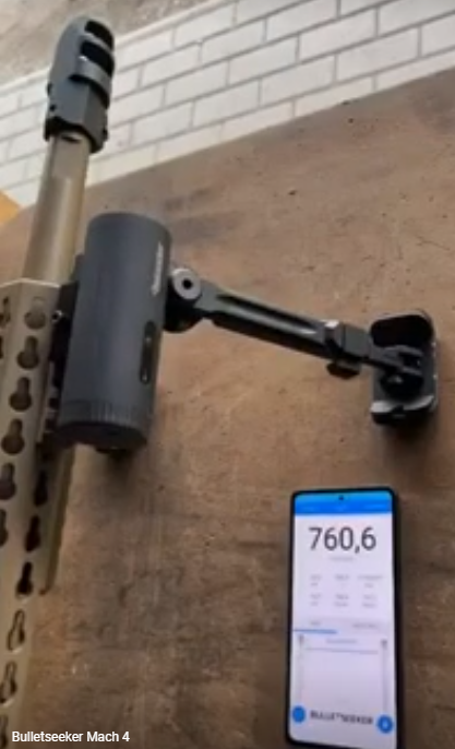

    Previously Longseeker radars were limited to Air and rimfire the Mach4 model seems to be centerfire oriented weapon mounted radar developed and manufactured in Europe. The price point in Europe is similar to Labradar , but considering you cant really buy Labradar till summer or autmn ,this is a moot point.
    Bulletseeker Mach 4

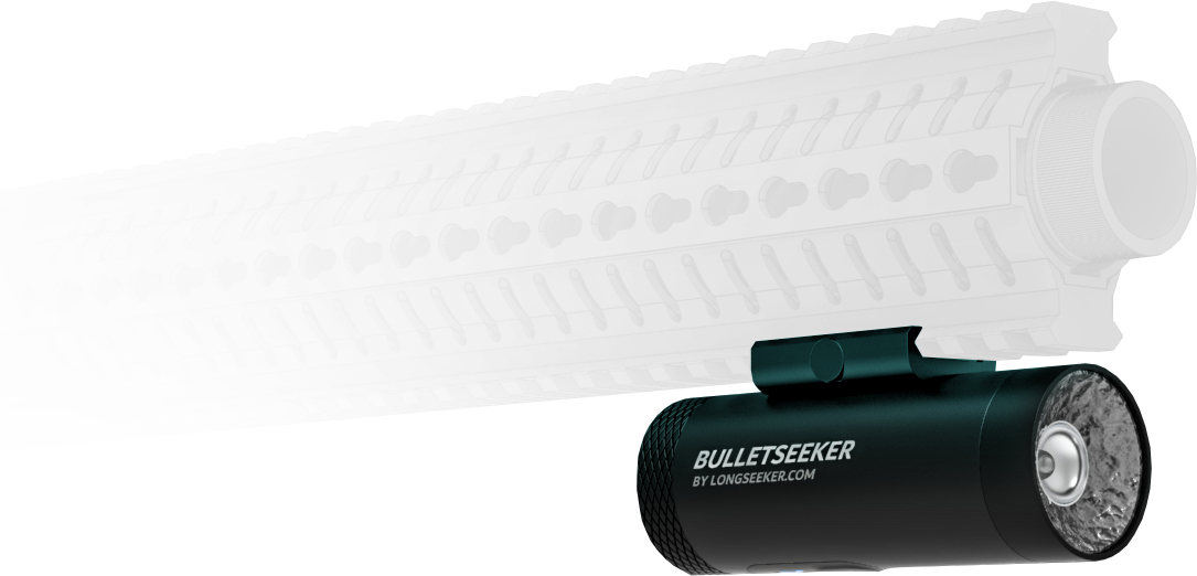

    Currently, the most advanced ballistic radar for measuring missile velocity is based on the Hi-Tech SIR chip operating at 120 GHz.
    The high frequency, many times the frequency of competing products, allows for more reliable and accurate projectile detection, and Bulletseekers do not have a problem even with bulk projectiles. Thanks to its compact design, it can be mounted on a weapon and innovative technology allows it to be used in tunnel shooting ranges, where other products fail.
    • Unique compact design
    • Radio working band 120 GHz
    • Weight only 190g
    • Integrated Picatinny adapter
    • No need to set the measurement direction
    • Measurable speed up to 1200 m/s
    • Bulk projectile detection ?(full auto?)
    • Connection to a mobile phone
    • Development, production and support in Europe
    • Operating time up to 6 hours

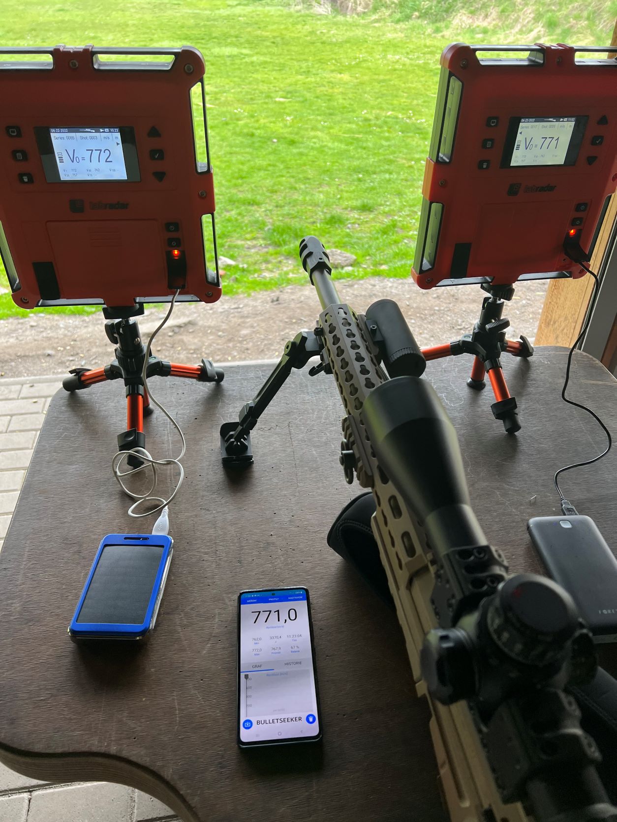

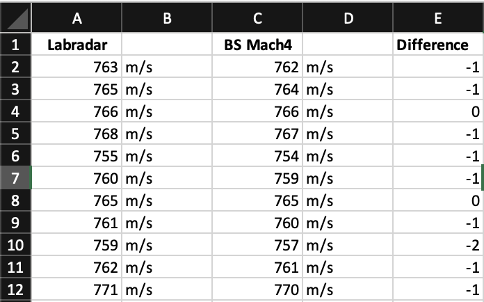

    Labrador is an order of magnitude more accurate, 0.1%!
    Its supposed to at least as accurate as Labradar , but yes info so far is sparse and poorly written, its early days expect some comparative tests in the coming weeks.

    I have published some video from test on FB. Bulletseeker Mach 4 is testing a long time in a few countries including Canada and problems for recoil is not happened.
    Hell yeah. Thanks for posting the video. This is potentially the most exciting thing since sliced bread in the personal chrono department that I’m aware of, especially if the app is easy to use, it works as shown consistently and if can be used with Apple.

    Can be on the stand close muzzle. Beam angle is 20 degrees from the axis and measure range is 100-150 cm. Position for working properly is depend on it.
