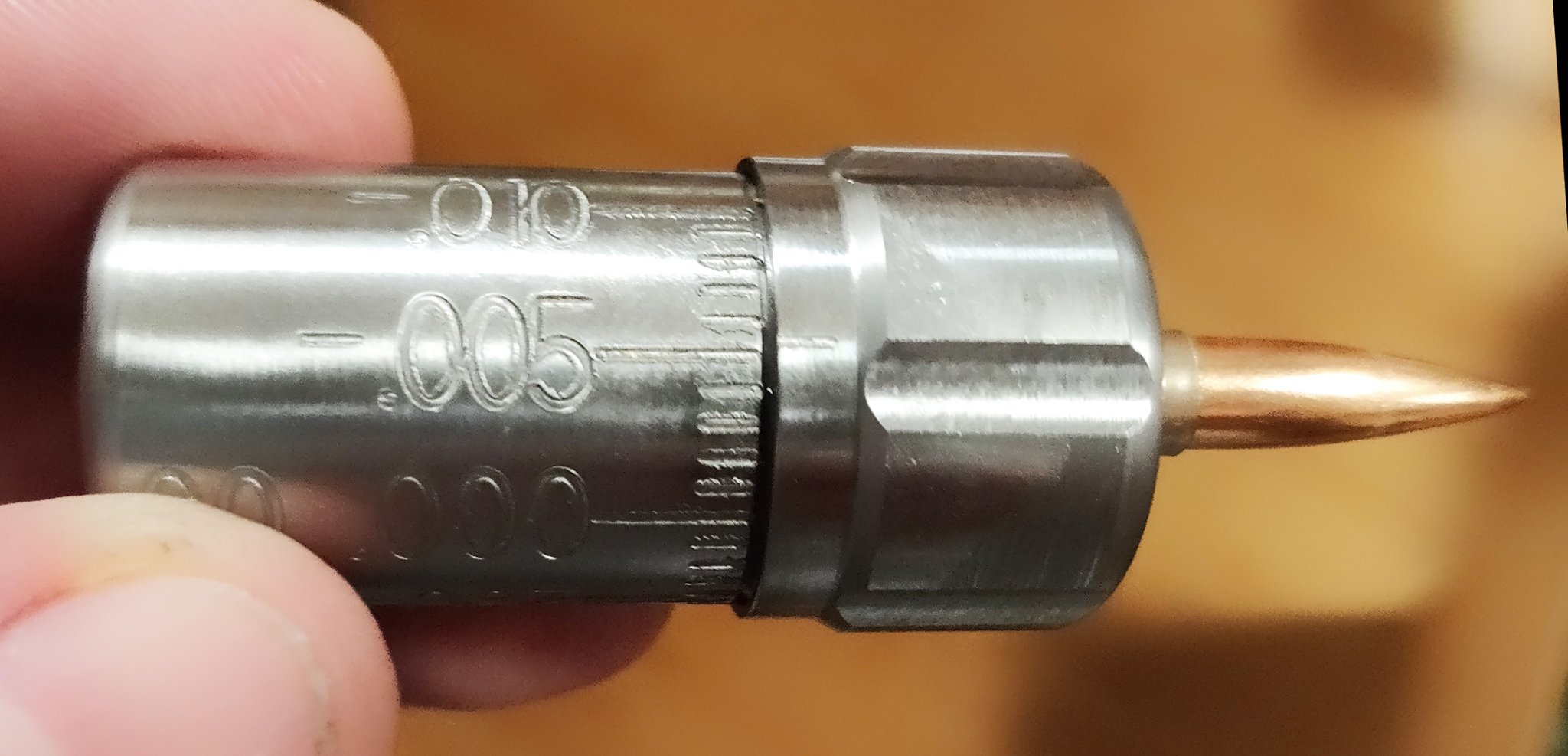

Not sure if I just cant read my RCBS Precision Mic correctly, but i started at .037 on the gauge (below zero). Fireformed it went out to .043 (still below zero on the gauge). Which is growth of .006. After the cam over set, still no change in the mic reading (.043)

Thanks fellas, that's my plan, I returned those redding shellholders, going to use the redding body die and the RCBS precision mic case gauge to measure.
