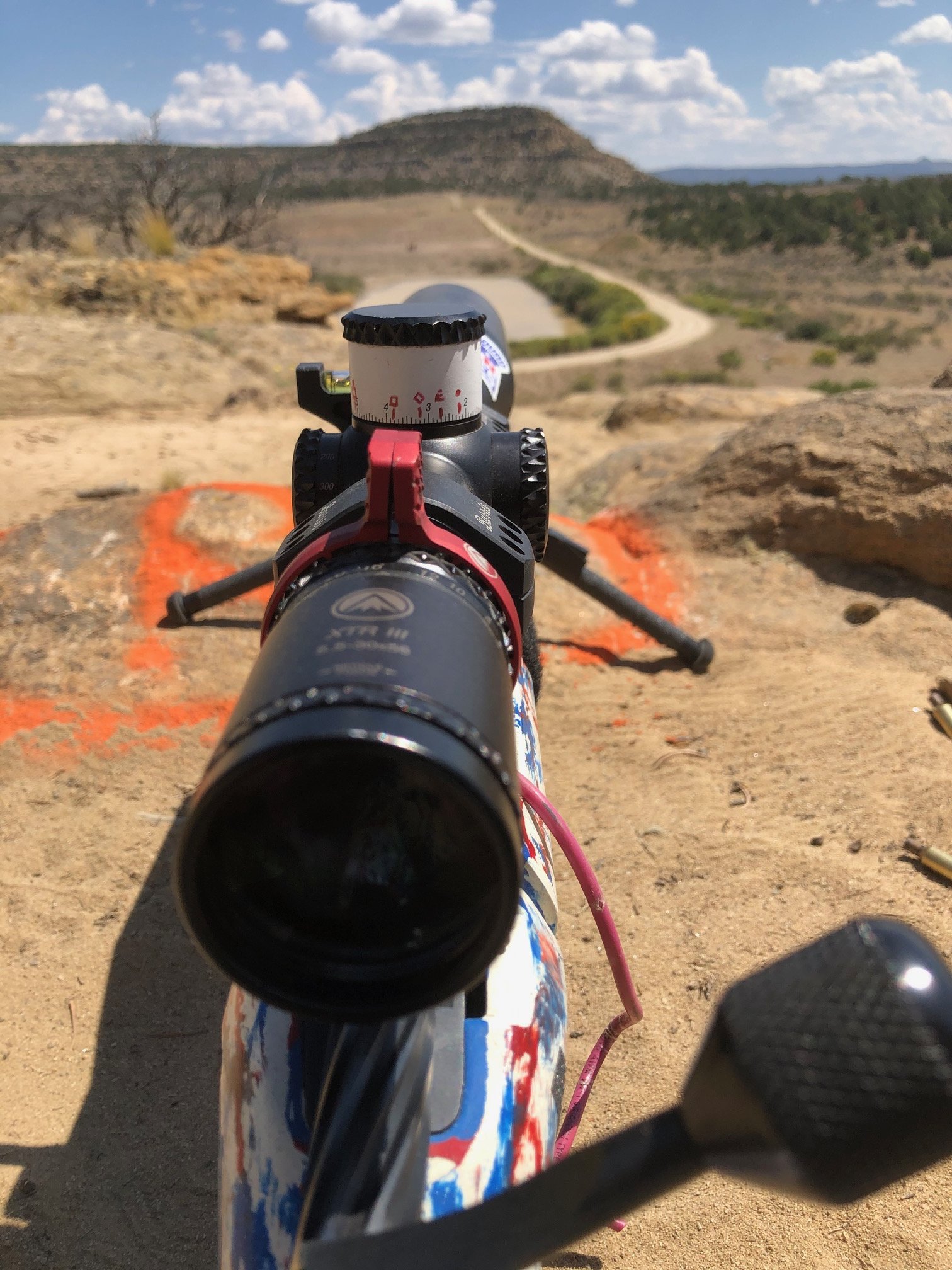

    pic to stay on topic. love this stage. all targets were spread out and diff shapes so I drew the shape on the target knob. I was th only person in my squad not to time out.

    That's a brilliant idea with the shapes DT! We also get to see your fine mechanics skills with trying to draw different shapes on the tape. ;)
