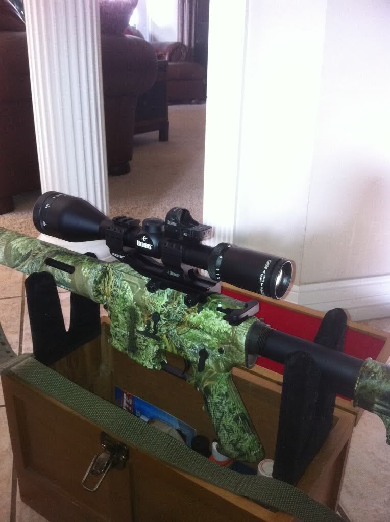

I am wondering who uses, or has used, the Burris PEPR mount for a secondary red dot for shooting yotes. I just got Burris Fastfire and am still looking at mounting options. I would like to offset it but don't have any room on my rail with my current Rock River scope mount. PEPR seems like an easy fix but I know easy isnt always best. Thanks.

Thanks to all. My Burris Fastfire should be here this week. Gonna to move my Burris Fulfield to AR w/ Fastfire and pick up a PEPR at my local shop. Might as well keep it all in the Burris family for the R15. Thanks again.
Re: Burris PEPR?
Here it is...
