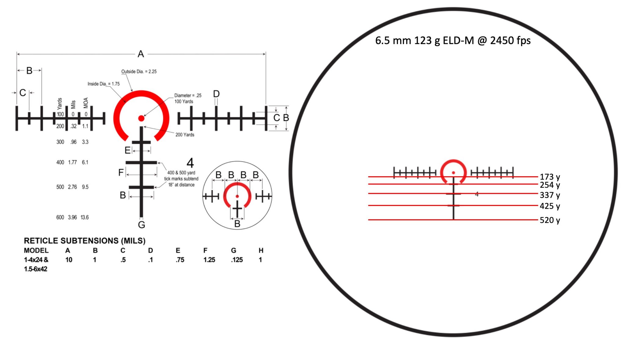

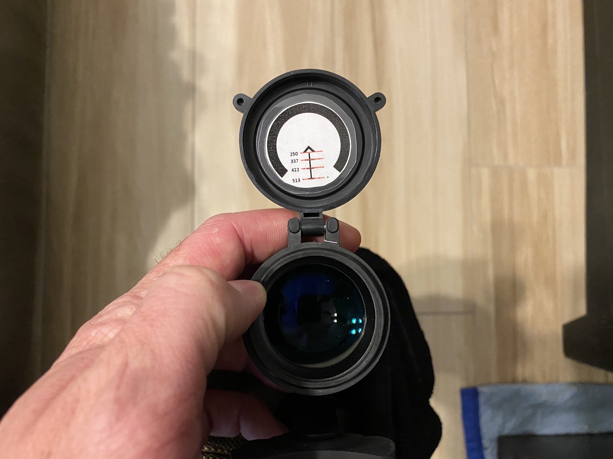

Yeah, LPVO's are made for hold offs, not dialing. It is easy to make your generic BDC custom to your rifle. It took about 20 minutes to customize the RT-6 reticle for my 6.5 grendel ballistics...
Printed, laminated, and glued into a scope cap (not the Burris RT-6 scope)...
