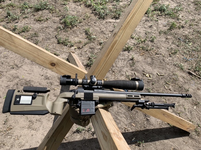

Okay so here's some background - I used to have a Viper PST Gen2 SFP and I honestly really liked that optic. It was pretty clear and never gave me any issues. But I learned the error of my own ignorance and moved to a FFP scope - the XTR2 5-25.
When I first looked through the Burris, I felt like it was an improvement over the Viper, but that could have just been "buyer's excitement".
As I've now spent more time with it (I bought it in January), I'm starting to notice that it sometimes gives me some image issues. I set the diopter focus while looking up at the sky with parallax set to infinity and max magnification. Looking through it at a blank canvas (the sky or a wall) the reticle is really clear, no issues there at all. But when I start looking at targets, I either get a blurry image or distorted colors (white steel plates look blue/yellow around the edges). Even adjusting the parallax I can never really get rid of it completely. At 100yds, it's hard to make out where my shots are on paper because the image just isn't clear enough. At 25x it's damn near impossible, so I have to back it down to 20 or lower to get a clear image. Everyone once in a while, if I'm looking through the scope for a long time, I can see a "ghost reticle" floating off to the side of the actual reticle. Like my eye is fighting to focus between the reticle and the target. Though this part honestly could just be my eyes, as I wear contacts, but I've never had this issue with any other scope.
My friend has an XTR2 as well that he just bought and it's clearly a newer model than mine. The logos on the scope are a bright white where mine are more of a dull grey. He also has a dark "silver" ring around his ocular housing and mine doesn't. Otherwise, our scopes are identical - same reticle, same magnification, etc. When I look through his, it's noticeably clearer than mine.
So, is my scope busted, or are the adjustments on the XTR2 just more finicky than my old Viper? Is it worth the 5-6 week wait for a warranty check by Burris, or should I just spend more time trying to adjust my focus?

Surprise surprise, I'm a lazy piece of shit and just never sent this in to Burris. I finally pulled this gun back out of the safe, fell in love with it again and then ran into this "God this scope is awful" rut all over again. I opened the support case back up with Burris and it's currently en-route to them. I'll let you all know how it goes, just for the sake of documenting this experience.
Reactions: Birddog6424
Burris determined that the inability to fully focus the optic was due to the internal mechanism reaching its maximum range and this caused some "damage" (I don't have the full tech details yet, just the general description email). The scope was in a 0MOA SPUHR mount on a 20MOA EGW base, zero'd at 100yds shooting 6.5CM. I've never had any POI/POA issues out of it and dialing out to 300 and back (haven't taken it off property to shoot further yet) was never a problem. My only performance issue was getting everything focused.
I did notice that the parallax knob had quite a bit of play in it when I was unmounting it to send it in, so maybe the tech notes in the box will shed some light on how that's all connected. The illumination also stopped working right around the same time I started having these issues, so maybe that whole side of the turret mechanism was disconnected internally.

Got it back but haven't mounted it back up yet. Initial impressions are that the glass looks substantially cleaner to me than it did before I sent it. I haven't really checked the parallax at distance yet, just looking at stuff in the back yard around 100yds away. But so far, it looks great. Can't wait to get it mounted back up and really try it out.

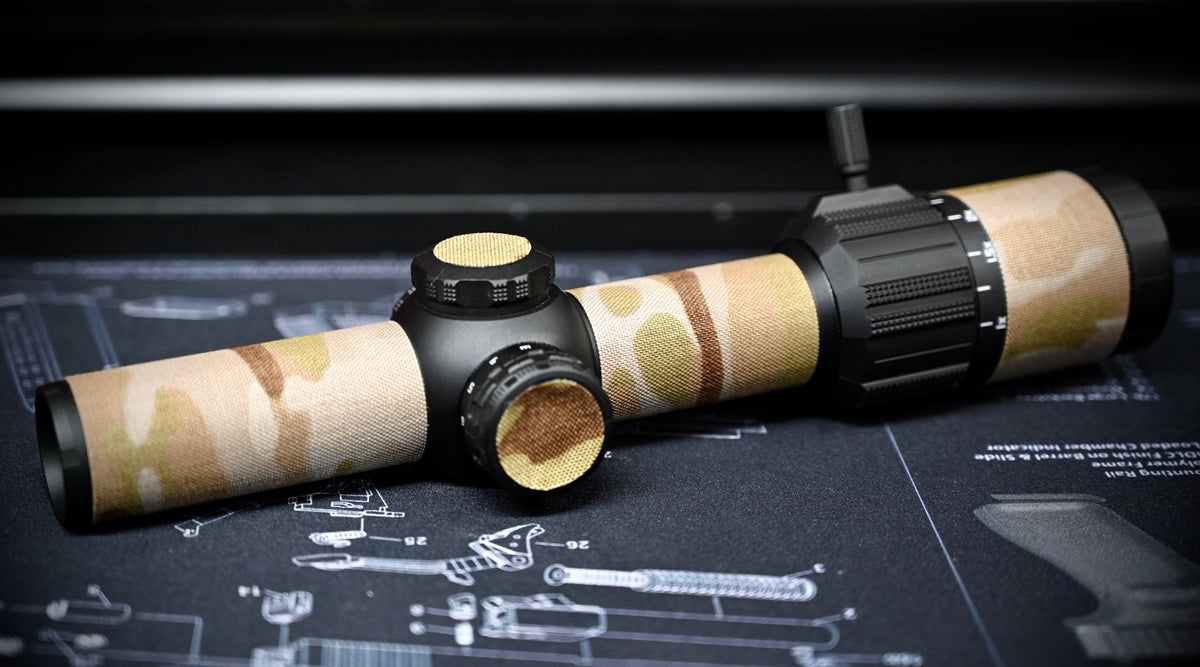

On a side note, does anyone know of any companies that make cordura wraps for the XTR2's?

They're not bad, but me neither. I have one I used for a couple of months & then took off. Probably just going to tape them w/ generic scope tape going forward.
I think you're looking for Ranger Wrap though, don't know if anyone sells it precut for Burris products
e: they have enough for different scopes w/ bells, one will probably work for you. Shoot them an email
Yeah I've thought about that, or using their universal sheet to cut up my own. I don't mind using the vet-wrap, I just hate that it breaks down so quickly and if you don't replace it often, it will leave some nasty residue. I may just have to use goontape or something.
I need something with some thickness because the optic was coated with ceracoke and a stencil was used, so there's a thickness difference. If I just rattlecan over it, the thickness difference will still be obvious and the stencil area will still be visible. I was kind of hoping Burris would just replace the optic so I wouldn't have to deal with it lol. I've heard removing ceracote is quite the task and requires abrasives, so I'd rather cover it with something.
