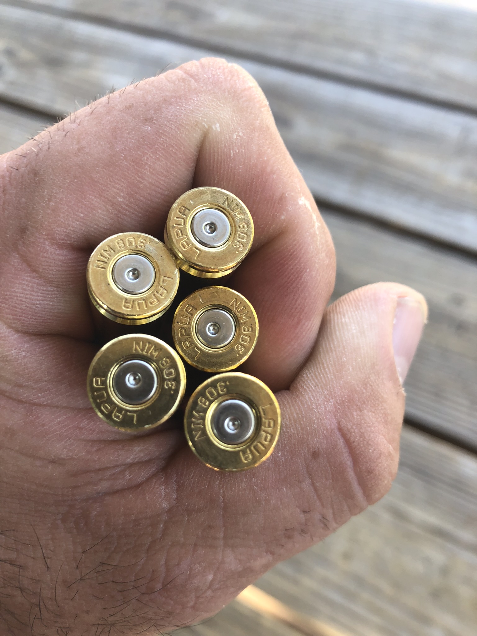

I'm considering sending my Bergara HMR bolt in for a bush job. I recently switched to Lapua cases with the small flash hole. So far cratering has not been an issue (it is there but not excessive) but my current pet load for the gun is pretty mild (41.6 gr H4350 under a 140 ELDM). This gets me about 2700 FPS average. I would eventually like to explore some higher speed loads but I'm worried the cratering issue would become a problem then. How long can I expect to be without my gun if I send it in to ,say, Gretan? I hear they do great work. I would hate to wait for weeks as I am used to hitting the range at least once weekly.

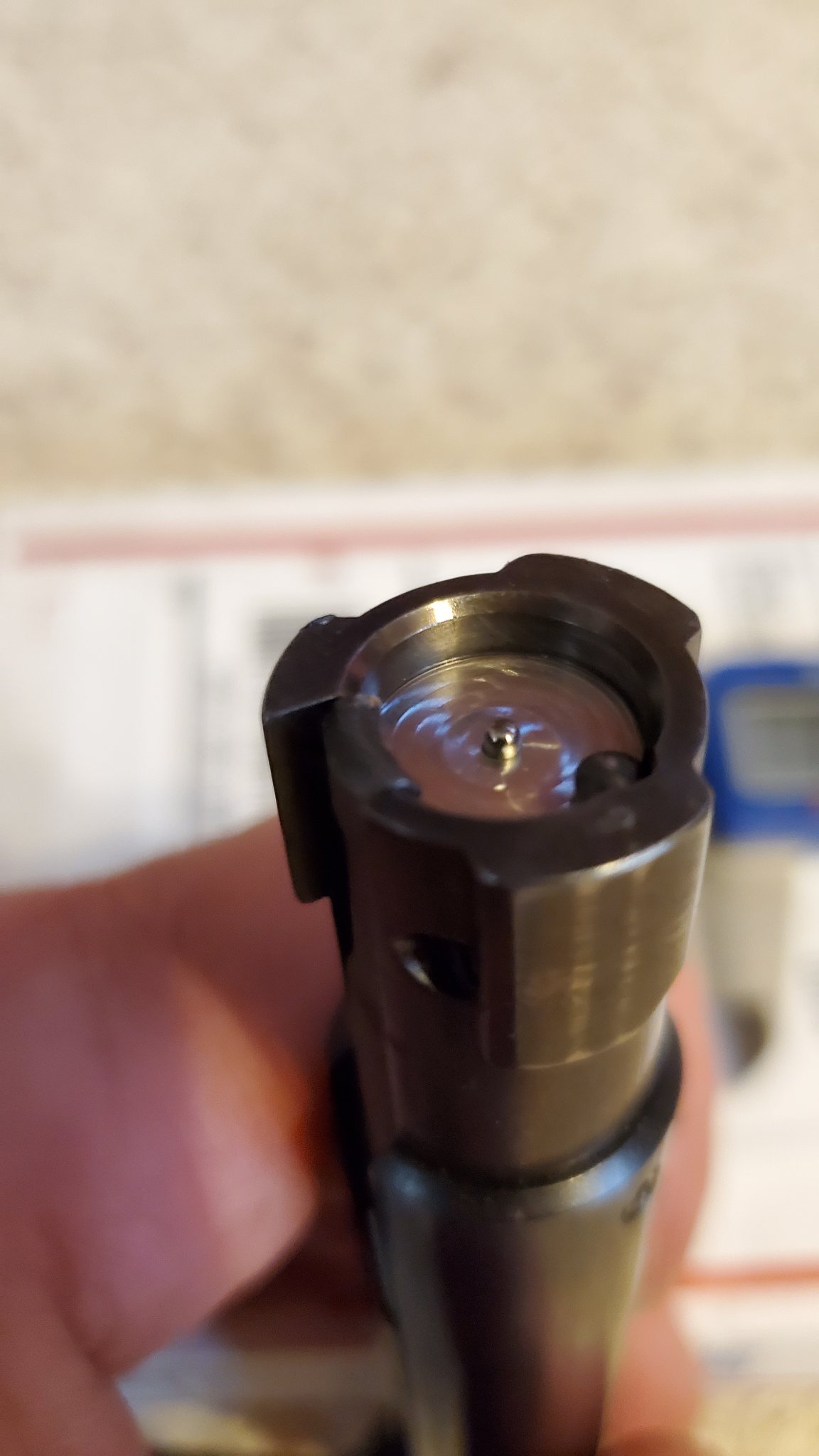

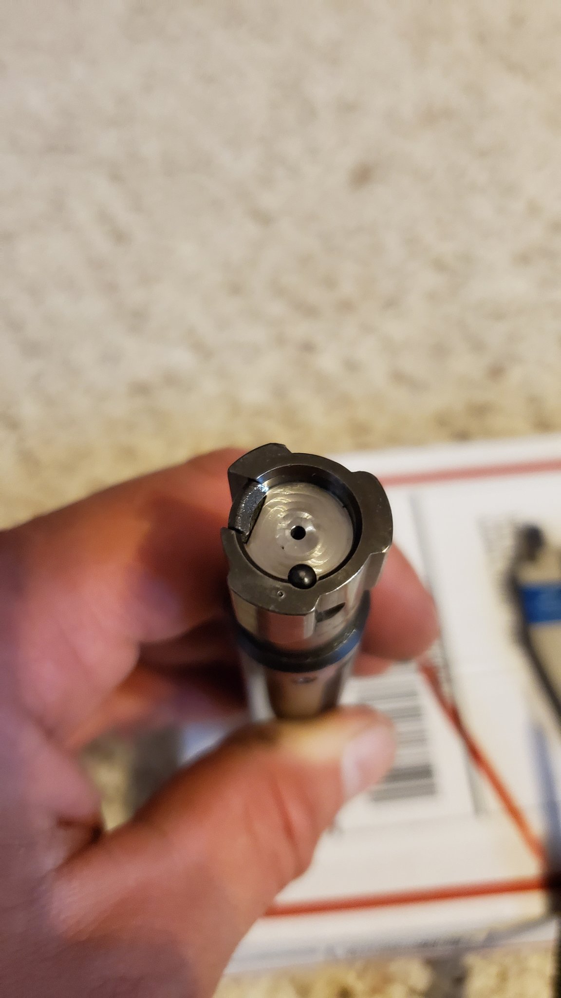

Gretan quoted me 8 plus weeks lead time. Bolt was back inside a month. Here are the before and after pictures. Great job.
