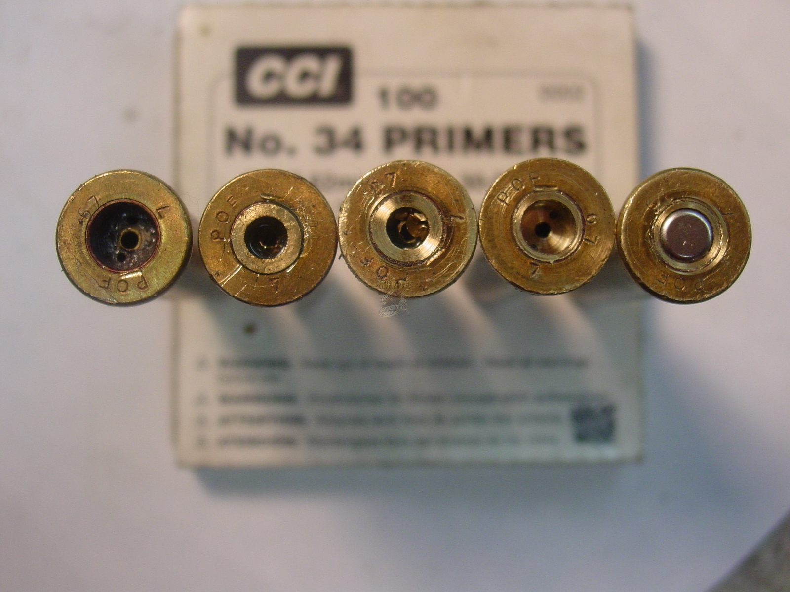

With the cost and scarcity of brass on some cartridges has anyone explored bushing brass primer pockets when they get loose?
Ive read where guys did this to make large primer pockets into small.

saw a video with another guy that did something like that with berdan primer pockets turning them into normal pockets for large primers .
Just sayin, guys are paying $2 for once fired. Other guys are culling brass with loose primers.
You can see that it can be and has been done and would be tedious to say the least.
The plug must be made to a quality level that is achievable with a common lathe, and the Berdan anvil has to be turned into a flash hole.
It takes equipment, material, time, and skill, all of which are also worth something, so the trade-off would depend on how bad you want that brass. It really isn't free to do this compared to just paying for brass, unless you don't count your time.

Im not talking about converting berdan unless that brass is more available.
I'm talking about cases with loose primer pockets. One could drill it out and insert a bushing or in the case of large rifle primers insert a bushing that would convert to small rifle primer.
End mill with a pilot that would alight with the flash hole
various size id/od tubing is redily available in bulk and could be pre cut into pocket depth lengths and simply pressed in.

I’ve done the punch and ball bearing thing on a lot of 50 cases
I’m on the 3rd loading since and they’re still doing good.

I have wondered about something like a short die that shrinks only the casehead down a bit, kind of like the tools MEC puts out for reloading shotgun shells.
Is that even possible?
I was thinking something similar like a swager. If you could imagine quartered shell holders that fit around the case head and pushing that through a slightly tapered die.

BTW, for reloading shells for my 25mm Hotchkiss Antitank gun, I bush casings to take .50 primers. No brainer. Since 1930's French primers are not available and each casing is $50. Also have to resize with a 20 ton press and dies the size of a Fosters can. But for small arms, not so much. But don't let us stop you, OP. If you want/need to, go for it! Might come a day when we are bushing .223 rounds to get enough protein to last the week. Hard rain's a-coming and all...
