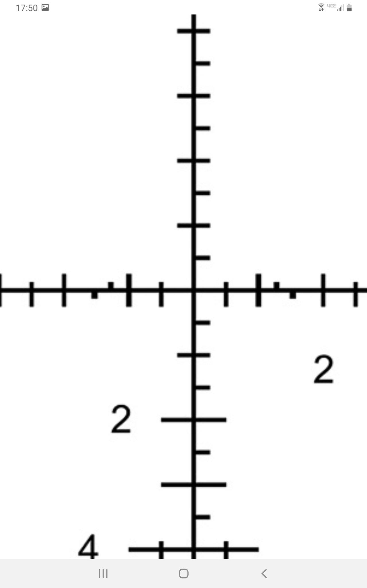

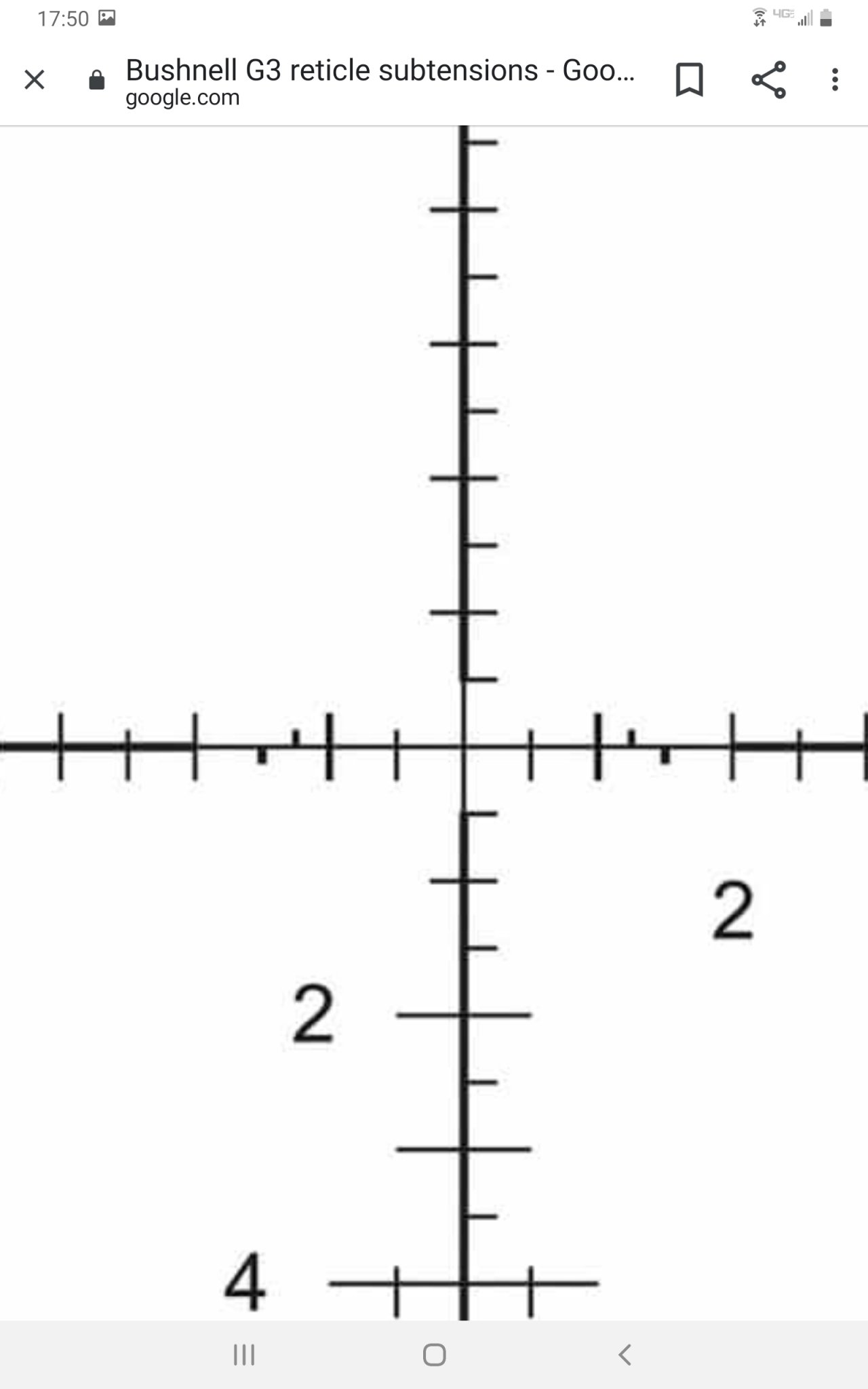

Hmm only difference ive saw in reticles, is the illuminated has the thicker center section. Ive got 1 dmr2, 1 dmr2 pro, and 2 xrs2

My DMR2 illum reticle same thickness throughout, and my PRO thinner at the center, like these images.
Yep, exactly what I said, irregardless of scope model, the illuminated g3 reticle has the thick center section. The non illuminated has the preferred thin center. Great pics to show reticle difference. The illuminated g3 reticle scooes are usually slow sellers on the px here and command less money than their non illuminated brothers.
