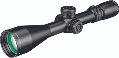

I've been spending way too much time trying to decide what ~$1,000 optic to put on a new high quality 6.5 Grendel build that I am putting together to shoot steel and occasionally hunt deer with, and have narrowed the options down to two scopes.
The first contender is the Vortex Razor HD LHT 3-15x42 HSR-5i MRAD. I know this scope is well known, but the specs are:
Magnification 3-15x
Objective Lens Diameter 42 mm
Eye Relief 3.8 inches
Field of View 35.3-7.0 ft/100 yds
Tube Size 30 mm
Elevation Turret Style Locking/Zero Stop
Windage Turret Style Capped
Adjustment Graduation .25 MOA
Travel Per Rotation 15 MOA
Max Elevation Adjustment 80 MOA
Max Windage Adjustment 80 MOA
Parallax Setting 20 yards to infinity
Length 13.3 inches
Weight 19.1 oz
The other option I have narrowed it down to is the Bushnell LRHS2 4.5-18 x 44 G2H
New feautures for LRHS2
  • ED Prime glass
  • Magnification throw lever
  • Locking windage adjustment (changed from capped on gen 1)
  • EXO barrier (one of the best waterproof/fogproofing coatings in the industry)
Specs:
  • First focal plane
  • Magnification range: 4.5 - 18x
  • 30mm Tube diameter
  • Eye Relief: 3.4"
  • Parallax adjustment: 50 yards to infinity
  • Waterproof IPX7 compliant, fogproof
  • Turret adjustment increments: 0.1 Milradian
  • Total elevation adjustment: 25 Mils
  • Total Windage adjustment: 25 Mils
  • Turret rotation: 10 Mil per rev.
  • Exobarrier coating applied to glass
  • Revlimiter Zero Stop
  • Non-illuminated
  • Weight: 775 grams (about 1.71 lbs)
  • Length: 14.4 inches
Which would you pair with this rifle?
I sold my LHT and bought a handful of LRHSi/LRTSi scopes. The LHT was a scope I hated to love. It did exactly what I needed, it was light and it had a useful reticle.
I don't like SFP optics and Vortex's seem like they're waiting for their fist chance to break. The LHT's have a small record of issues holding zero after drops and the turrets don't give me confidence.
Either would do great, the LHT is a lightweight scope with nice glass. The donut reticle in the LRHS2 will do really well, but it's a bit heavy and has a somewhat narrow FOV. They'll both do well, neither one is perfect.
I’m still open to other opinions/options in that magnification and price range, and could be open to stretching to $1,500 if it was REALLY worth it…
The lht is much more of a hunting scope. If you're mostly shooting steel off support you'll probably want something ffp. The eyebox on max magnification is awkward for improvised positions and while mine has always tracked fine the elevation turret doesn't inspire confidence. The windage turret is capped for a reason.
It has a nice eyebox on lower powers and is actually pretty fast up close on 3x. The weight is awesome and the glass is quite good. It's a good scope and I like mine it just doesn't sound like you would make much use of it's strengths and it's shortcomings would be annoying.

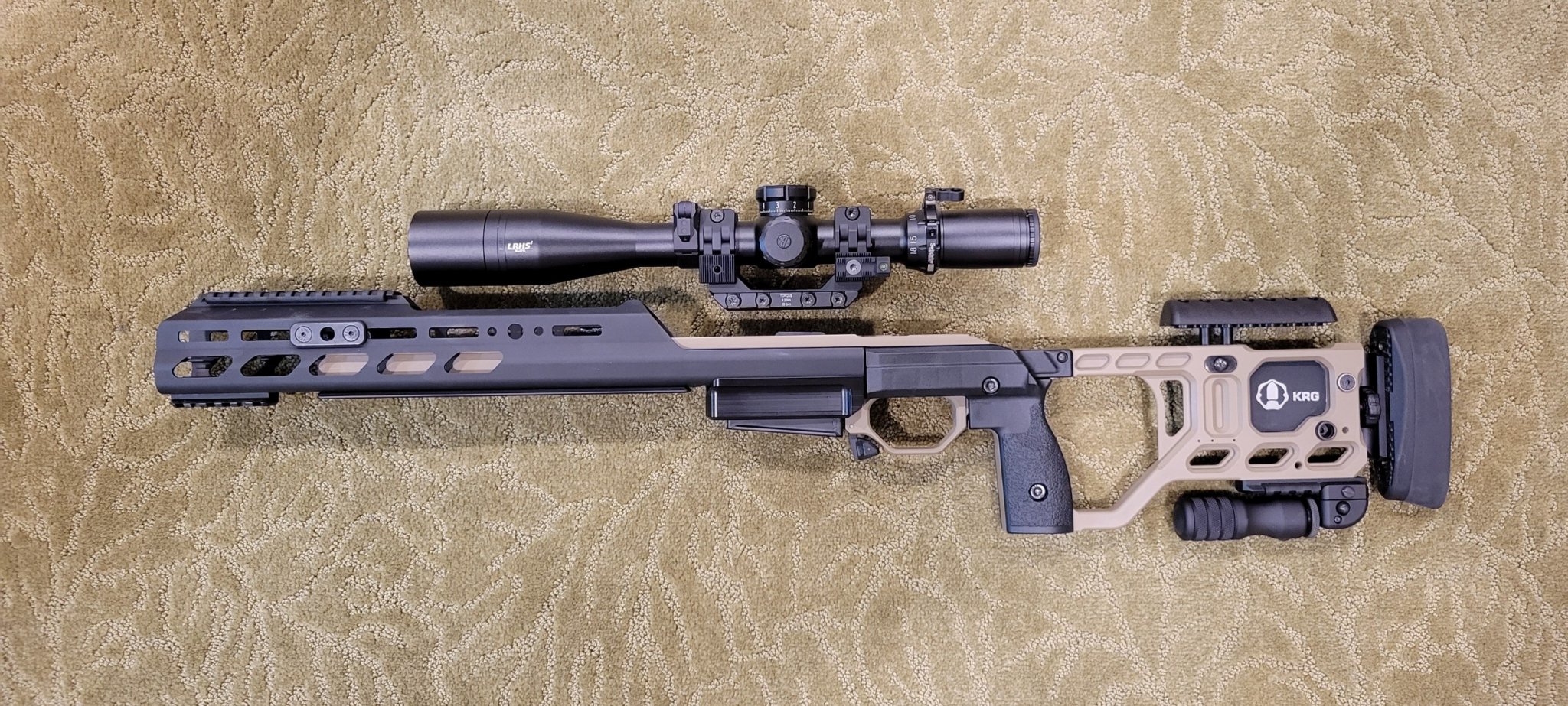

Shot out to 800 on 5 gallon jugs of water last year. Holds for wind were a non issue. "Donut obstruction" was also a non issue. Fast as hell up close especially with the bold lines thrown in.
The glass looks nice. I'm sure in the field, even better
