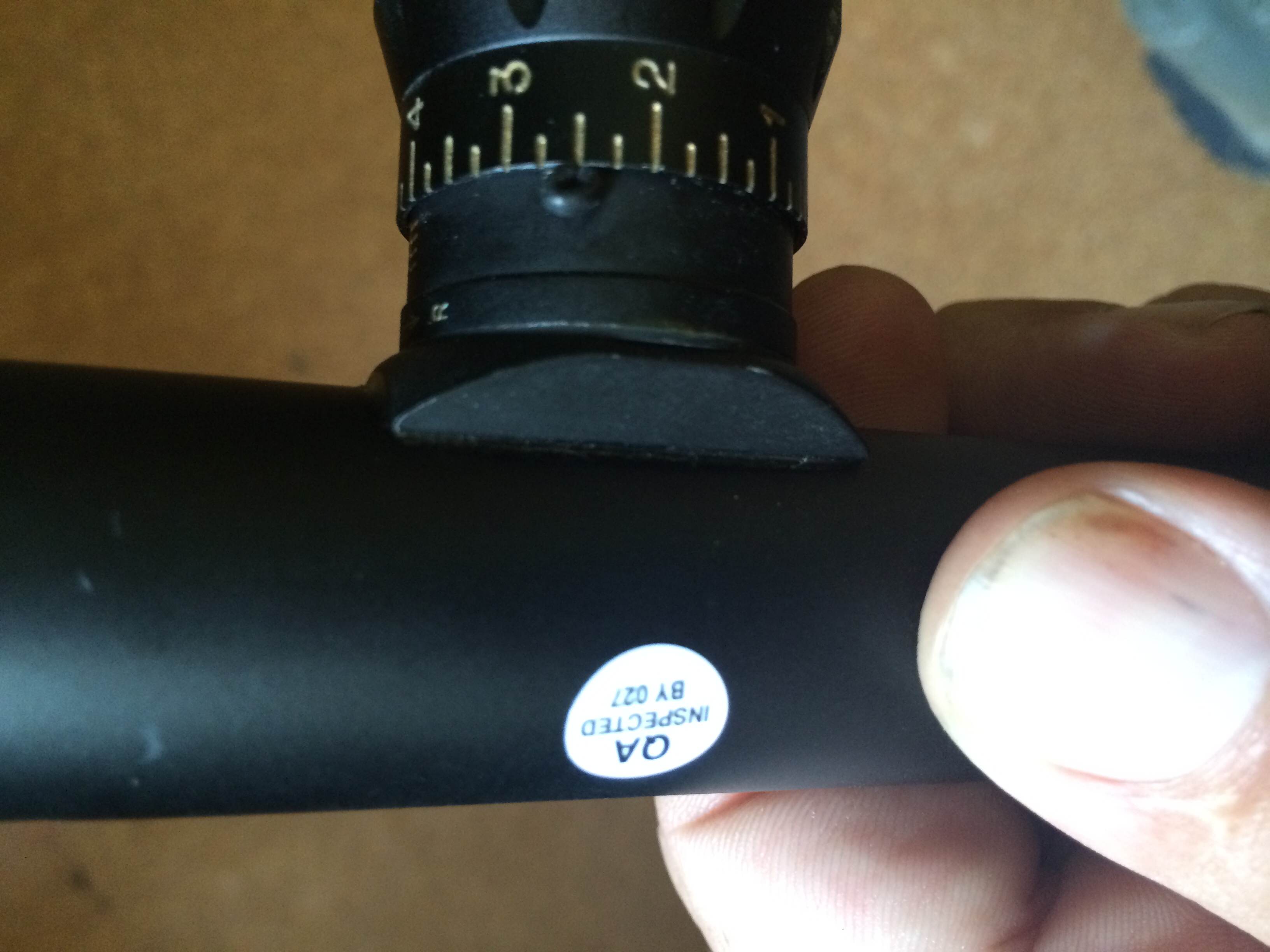

I sent in my 3200 10x because the elevation knob was not functioning correctly.
Once I got out to 600 plus the knob would not track accurately(edited because I forgot to mention windage adjustments also were compromised).
This is with a 243 shooting 95 VLDs on a 20 MOA rail.
The paper work says inspected, tested, meets specs.
I say paperwork because they informed me I could buy a replacement for 162.94!
I see now why people complain about their customer service and hope I never have issues with the 2 HDMR's I have.

I spoke to a CS rep this morning and he told me they put the optics in a collimator and dial the full travel.
My scope allegedly was inspected and passed this test.
I said that I intended to run a test myself, by dialing and shooting on a ruled paper, and would report back.
My intention was to dial the full windage and elevation, dial back to mechanical zero, then zero on a rifle and shoot the test.
I got as far as the windage knob which felt exactly like it did when I sent it in.

The elevation knob and windage knob both had binding issues.
From what I see now I'd say its the rubber gaskets inside.
With the elevation knob I observed times when the dialed amount was less than what was dialed.
I'm not trying to hit sub moa steel at 1000 with it.
I've been using it on 18" square or e type sized steel, so I don't consider my expectations of tracking to be lofty.
I also have better optics that are in use. The 243 has a mil/mil 12X SS on it now FWIW.
I simply wanted Bushnell to address the issues the optic has and they didn't do that.
The photo I posted has a twisted gasket protruding from under the windage turret.
That's a trait I'd expect from a $60 22 scope if anything.

The OP (MLC) and Michaelnel are both claiming that scopes which have the lifetime warranty were not adequately repaired when sent in for service. "Lifetime warranty" isn't worth much if they don't really honor it. I'd be interested to hear if there are any more than just the few bad experiences in this thread.
So what's wrong with the scope?
You saying that you can't hit crap past 600+ doesn't prove that the scope is bad....
And that o-ring hanging out from under the turret is NOT from normal use.
So back to my question - what's wrong with the darn scope???
That's not an o-ring hanging out from under the windage knob, it's a new species of parasite, some sort of scope worm.
Please ship it to me and I'll properly dispose of the biological threat.
