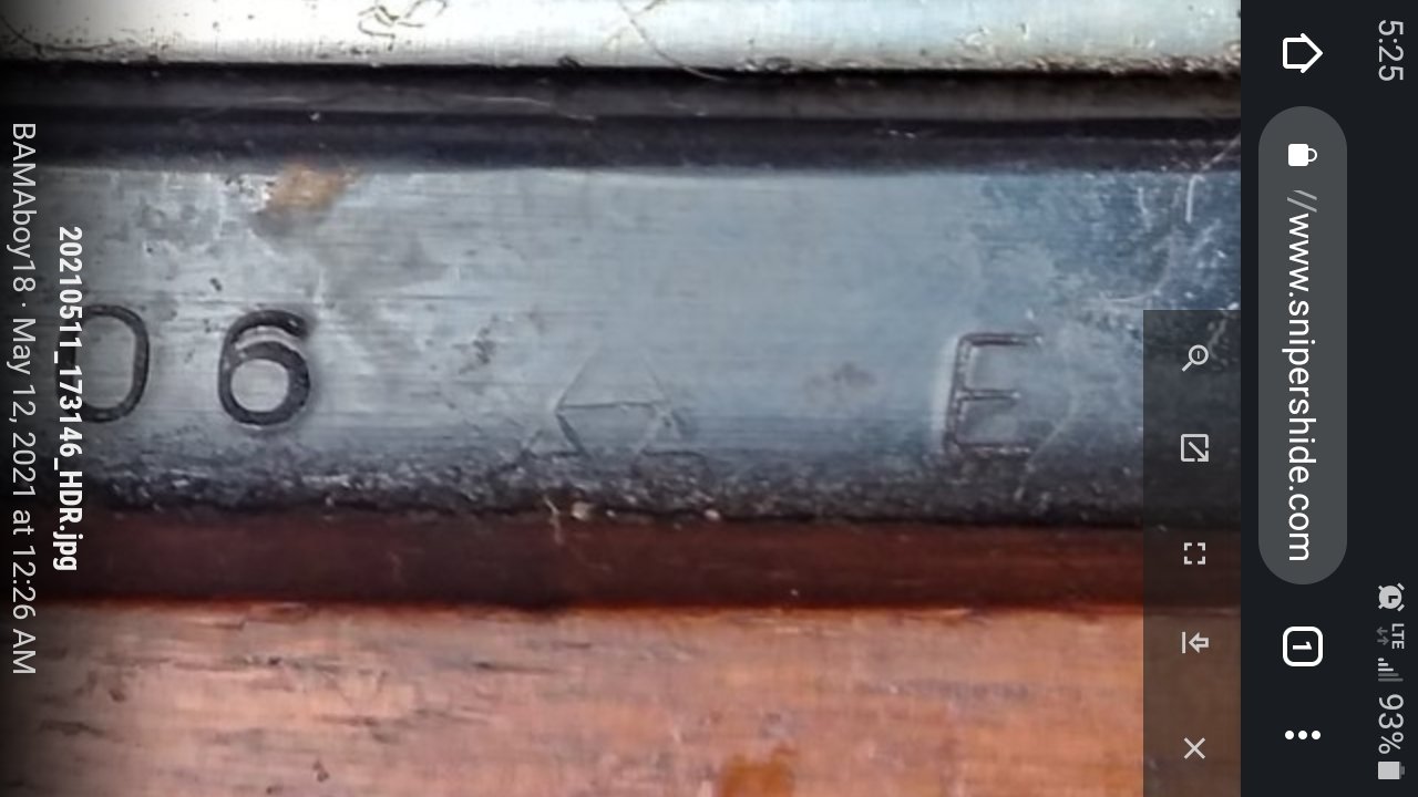

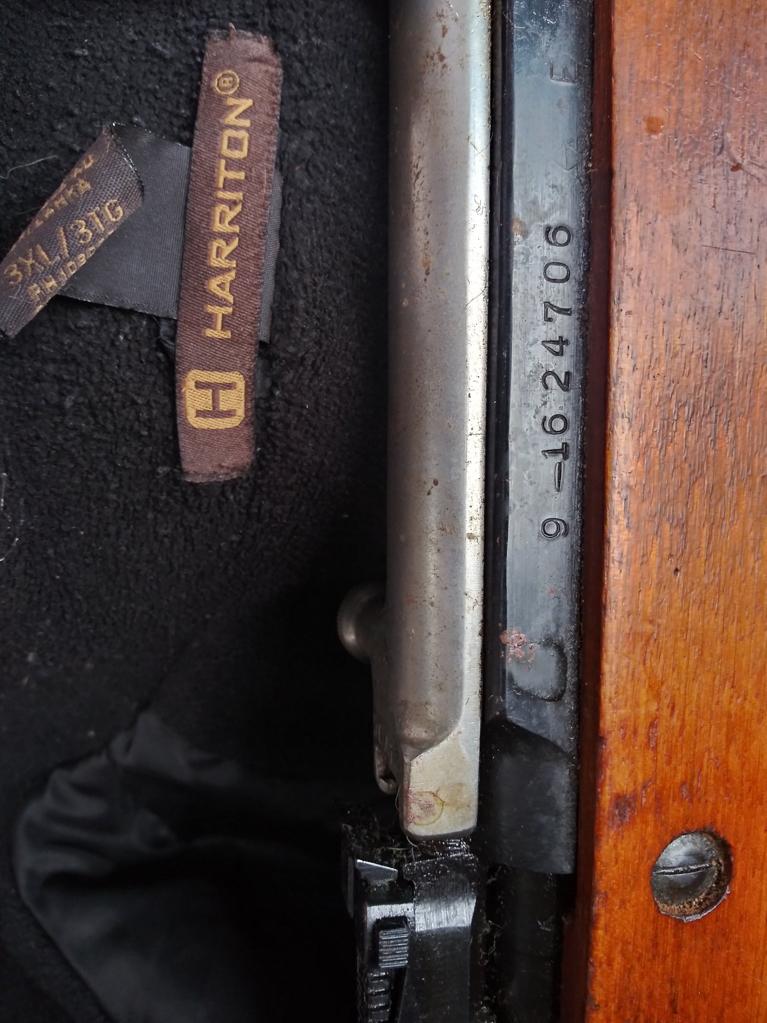

So I got it tonight.
Can't find info on serial #. All matching #s, 20" barrel, & came with a scope mount receiver cover and BSA red-dot and about 30 rounds of Tula soft point ammo. Front sight and bayonet lug are ground off, very crudely :(
I may cut it down and re-crown??
Serial # 9-162406 /_\ E
Pretty cruddy, but should clean up.
Since it's not a pristine, and already bubbuhed nothing stopping me from going further...

Does it have any other stamps telling you where / when it was made?
Haven't had a chance to investigate further, here at work I just wrapped my jacket around it and moved it to my truck, then snapped a couple of pics. I'm suspecting it's Chinese

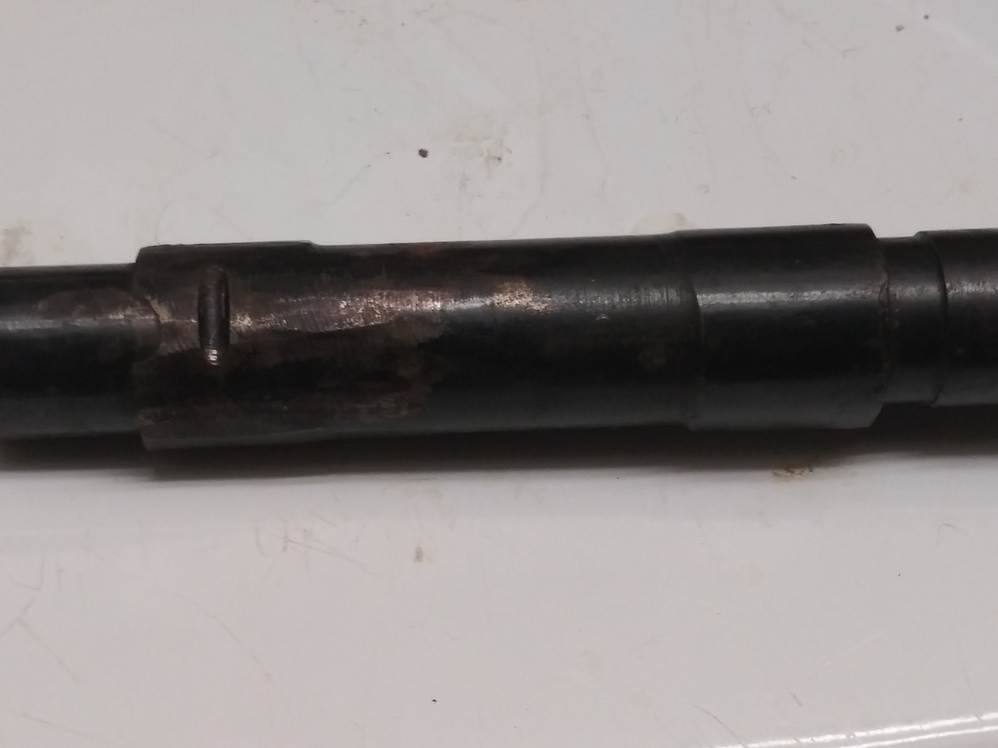

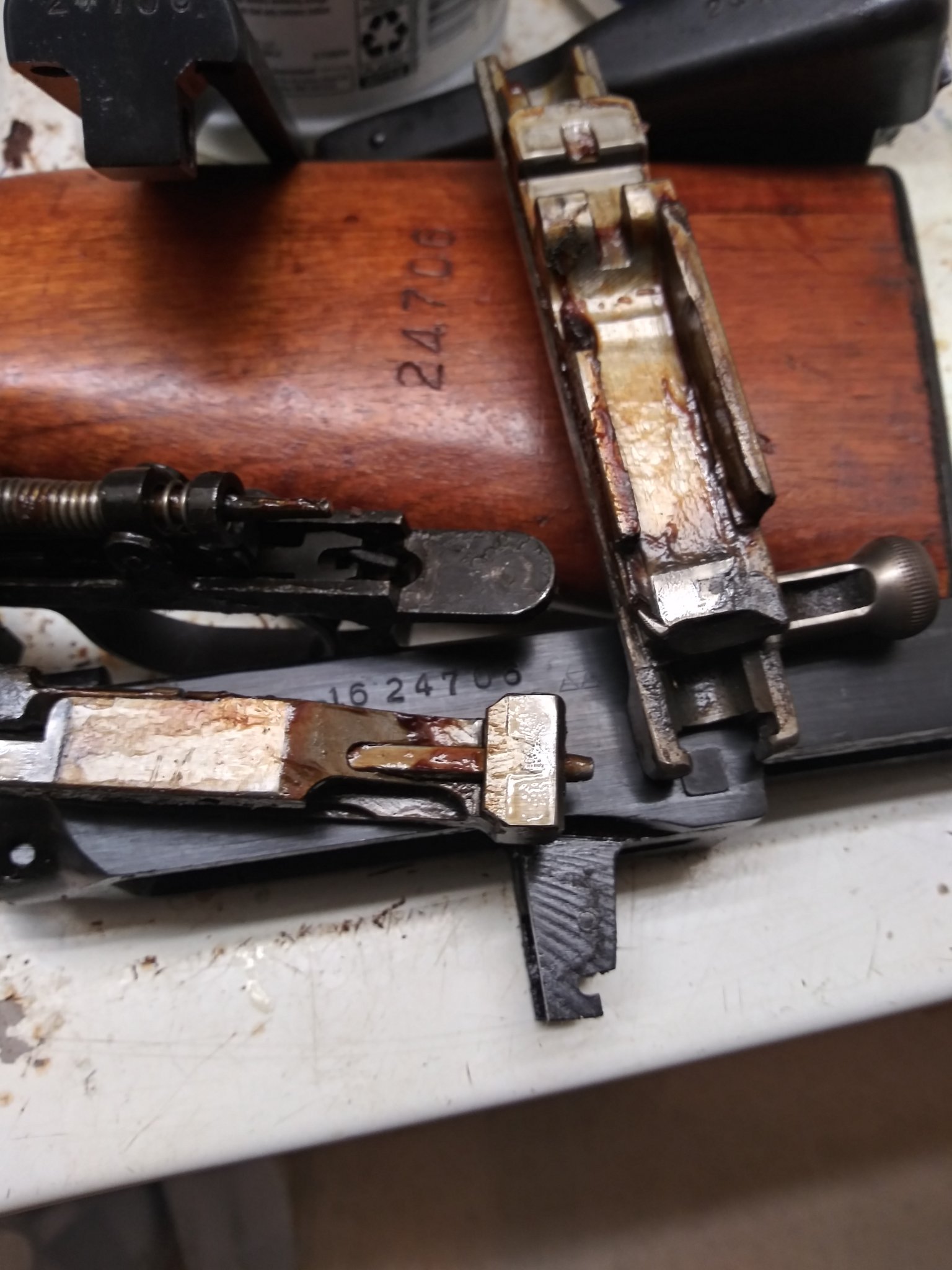

Okay I stripped her down this afternoon. It's a commercial Norinco; POLY, Atlanta GA USA (pressed/pinned barrel) it's never had the cosmoline cleaned out of the inside. In addition to an Nc star tri-rail receiver cover with the BSA red-dot the original serialized cover came with it.
Does anyone know if the front sight boss is concentric? I may need to build it back up & turn it on a lathe.
Don't understand the desire to remove the front sight & the only scenario I can imagine is guy didn't realize it was pinned on and just took a grinder to it until it fell off.

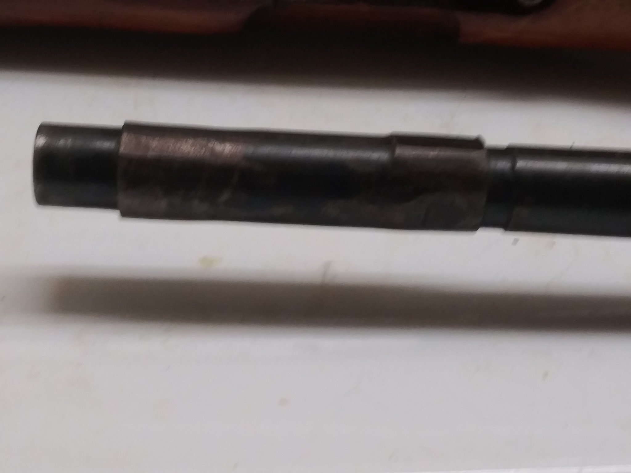

What I'm working with for the front sight

Make sure you check the barrels bore before you spend to much time on the front sight.
Look for any pitting from corrosive ammo.
And the cosmoline needs to be removed prior to any shooting., that sticky stuff can cause all sorts of grief.

It sure does! Take the whole damn thing apart and wash it old school in your sink, I prefer Dawn. Anything that washes light, sweet crude off of a baby duck will do a bang up job on the second best thing ever to emerge from behind the iron curtain!!!
Reactions: bfoosh006
So last night I soaked all internal parts with WD-40 and wiped it all down then a quick soake in Toluene and blew out with compressed air. Tonight I'll be in the plant alone and will clean the barreled receiver/stock. Looking really good.
So I have a front sight on the way, I'm thinking of mixing some Devcon and reinstalling it permanently with 1 tight pin & the 2nd setting up in the compound where the groove was ground away. Any thoughts pros/cons??

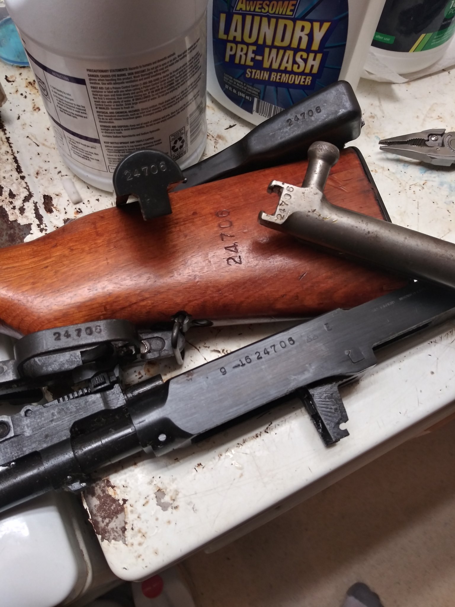

All cleaned up, in addition to missing the front sight there is no safety spring. I have those ordered. I guess I'm gonna have to learn how disassemble the trigger group...

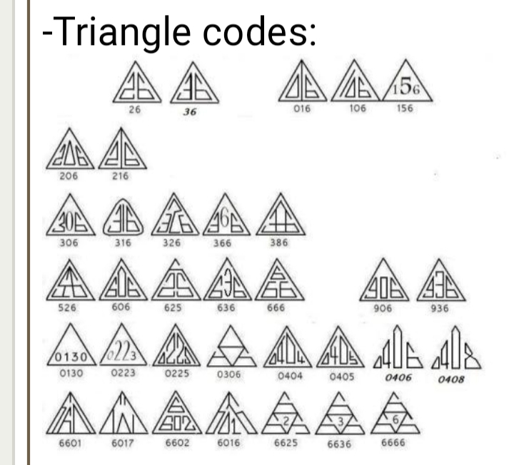

It's definitely Chinese, and most likely Chinese military issue rather than the later made for export examples that came in in the late 80's early 90's.
Zoom in and you'll see a faint factory mark stamped to the right of the s/n.
Looks like tri angle mark for factory 0306 to me.
Not sure if the Jainshe Arsenal/tri angle 26 date coding system( add the first 2 digits of the s/n to 1956, 16 in this case, 1956 + 16= 1972) applies to other factories but IF, and that's a big IF, it does production date is around 1972.
Not sure if the Jainshe Arsenal/tri angle 26 date coding system( add the first 2 digits of the s/n to 1956, 16 in this case, 1956 + 16= 1972) applies to other factories but IF, and that's a big IF, it does production date is around 1972.View attachment 7629447View attachment 7629450View attachment 7629451
Definitely the 0306, thanks!
So far I have the new safety spring installed along with a Wolf 22# hammer spring I found in my parts box. I received my new sight post and tool, just waiting on front sight to arrive now
So front sight is here, now I know PO did not remove all of the old sight, he merely ground off the bayonet lug, cleaning rod retaining tabs, and sight post. I have to remove what's left and install my sight. My Sat night project at work, sometimes it's great being a nightshift maintenance man (win some). Last night wasn't one of those (lose some) 😆

Also, since it's so cosmoline'd on the inside, consider disassembling the bolt to carefully clean the firing pin channel. SKS's are known for slam fires. Not terribly common, but why take chances.
Reactions: BAMAboy18
Yeah, I did a complete disassembly, inspection and clean. Firing pin, op-rod, gas piston all were still coated.
