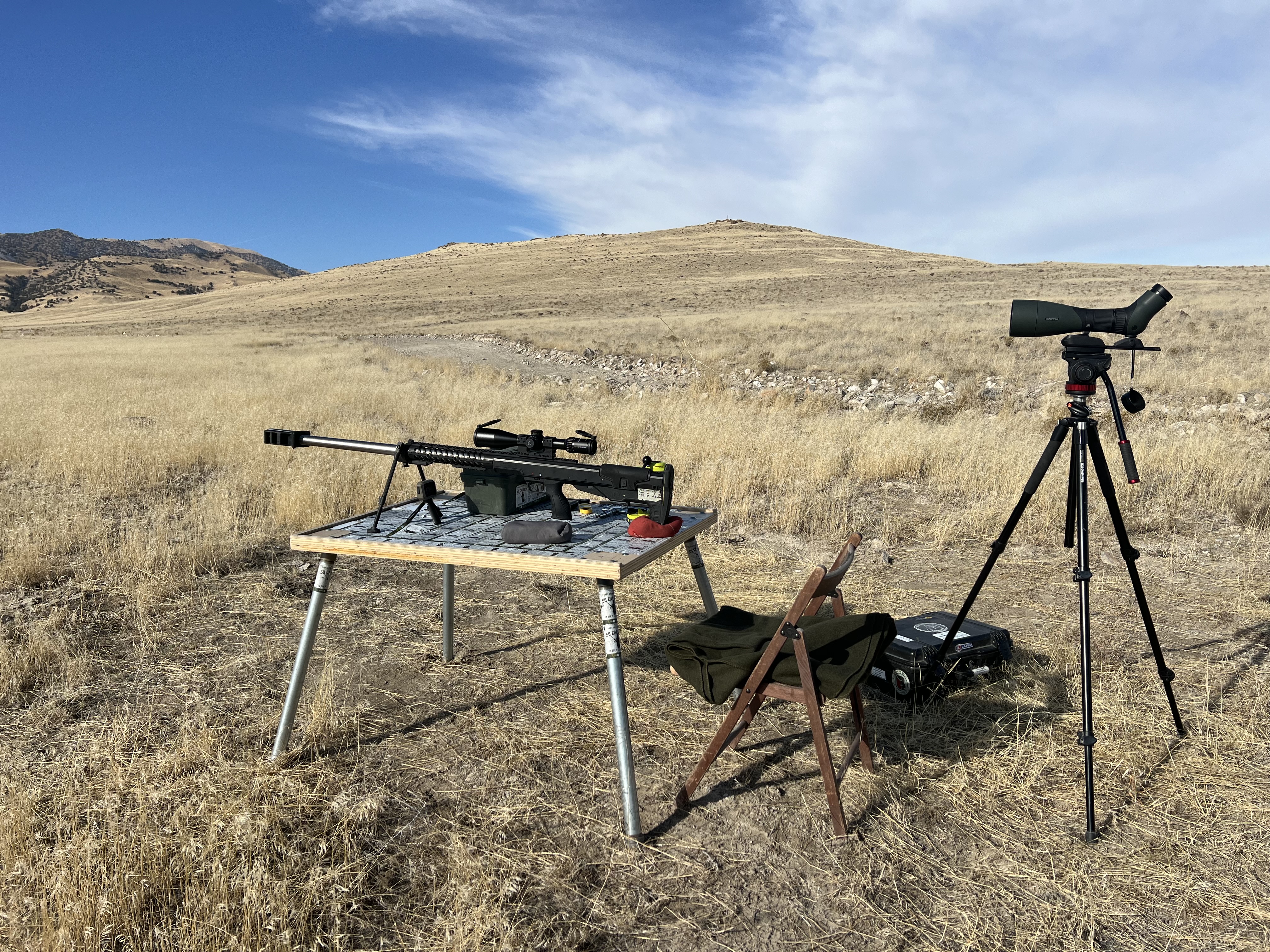

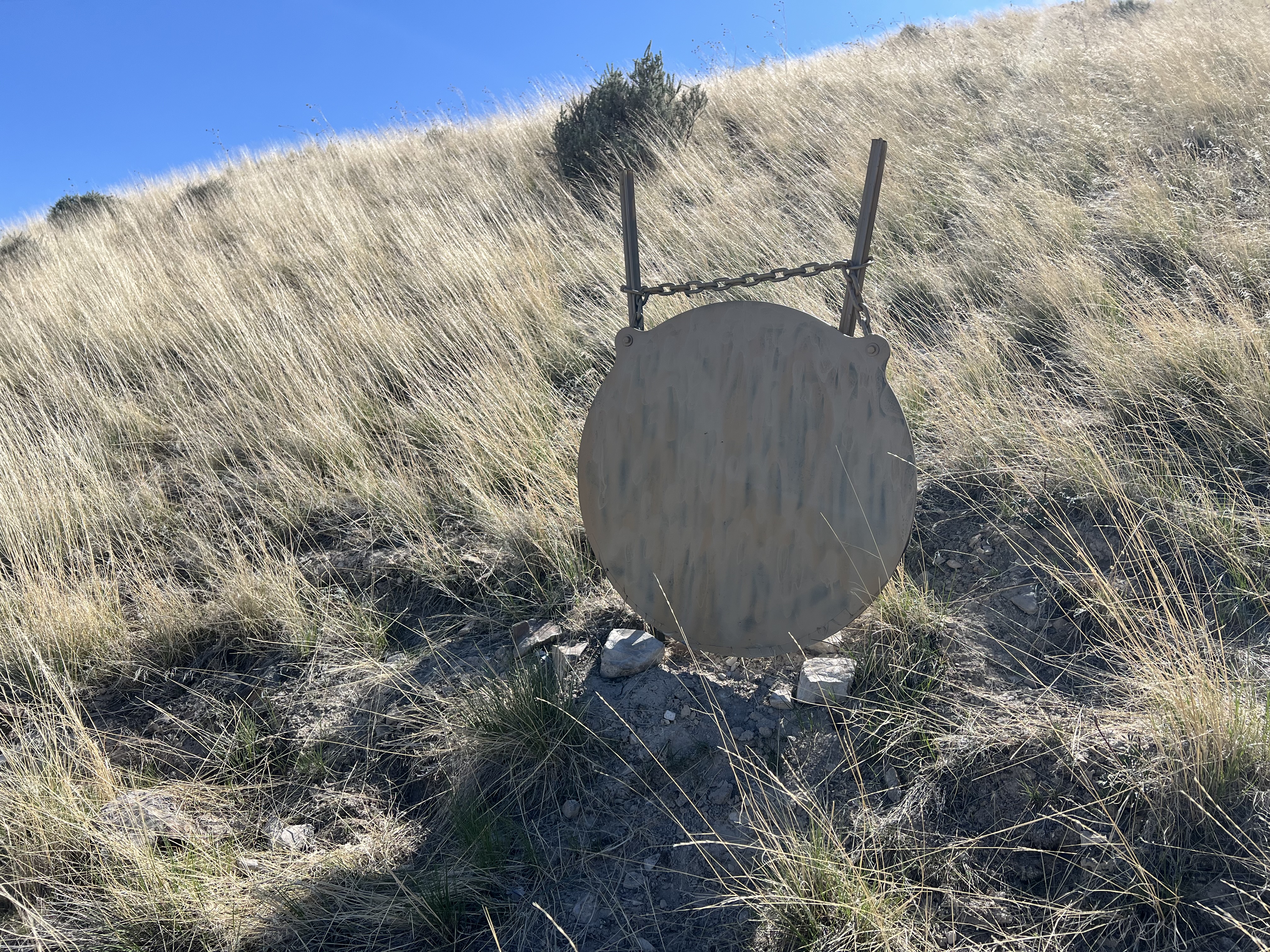

Something like this 30-inch 2050 yard target I set up today?
