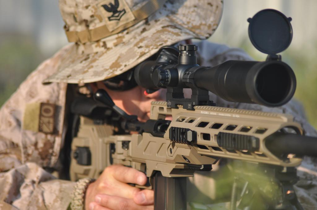

Gents, let me clear this up so you guys get the right kit you need. Unfortunately, the badger oversized bolt knob will not work with this chassis as the diameter will interfere with the closing of the stock. On our custom STALKER Series Sniper Rifle builds we have been VERY successful with the TEARDROP Handle from Pacific Tool

Here is a photo of the knob on one of our STALKER Sniper Weapons that went out to one of the US military teams.
URL]
We have also used the round knob that they make as well as some customers prefer this as well.

I have a custom fluted badger knob it just barely clears but there is no resistance or interferance
Photos look great. From what we have seen there is a possibility of bolt not closing if the bolt handle is too wide and also depends on how what depth the knob is seated when the bolt handle is threaded. This is why we decided to keep it with a Teardrop profile as this insures greater clearance.
