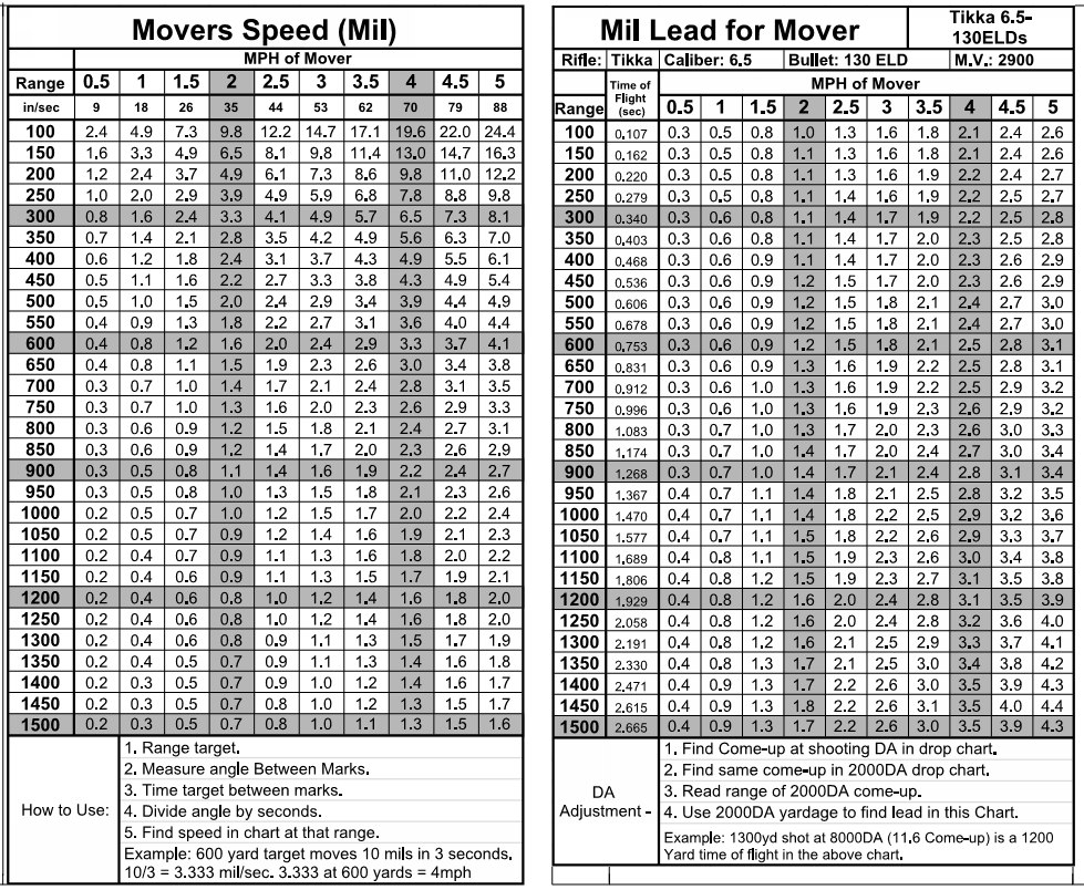

what is your method for calculating your hold on moving targets? Thanks in advance
There’s a bunch of different ways to do it so I’m sure people will chime in with other options but this works for me and is pretty quick. If you have a spotter with a reticle or can observe through your scope track how many mils the target moves in 3 seconds and then divide by 3 to get the mils / second. (Use 3 seconds instead of 1 for less timing error, it’s hard to be accurate in 1 second). Then multiply that mils / second by your time of flight and that’s your mover hold. Most programs will give you time of flight or you can just write it in for a hard dope card every 100-200 yards
Run it on JBM. Pretty accurate. Usually about 1.1-1.4 mils for a 2mph walking man depending on range. You can adjust that accordingly for speed.

That's why I figure stuff like this out on JBM (insert your solver of choice here) ahead of time then make a laminated cheat card.

Practice to get a good solid fast count. Find a rythm that is quick but easily repeatable. Most use a 4 count per second.
Know your time of flight for that distance. So for a time of flight of 1.25 seconds see how far your target moves while counting 1,2,3,4,1.
What ever lead that is, hold it and shoot.
used post 2 method a lot...find mils/sec and figure with flight time
you can also do it in a kestrel...there is a target speed calculator where you input distance to target and how many mils youre going to time it for...say 400 yds and 10 mils...you watch thru a reticle, hit start, and hit stop when it spans 10 mils...then it gives u the lead

100% on a chart before hand.

At Snipers hide cup this year we had an unknown distance mover at an unknown speed, not allowed to glass before hand or talk about mover holds with people in your squad. Having hard cards or a program with mover mph holds is great If you know the mph, but that doesn’t always work, like in this situation. It was a 6 min stage and we were able to get it ranged and mover speed calculated in under 1 min.

I set up my spotter and time the mover across as many mils as it has. I think it has 40 mils on the reticle. Then just divide 40 by whatever time you came up with to find the mils per second. Multiply by your time of flight.
I see lots of shooters at big matches just asking for the mover hold from other shooters. This is a mistake for several reasons. If someone just tells you it was 1.5 mil lead are you sure they were hitting center? Are you sure they were breaking the shot at exactly the 1.5 mil lead? Were they trapping the target or following the target? Was their windage dialed out correctly? Was their zero a click or two left or right of your zero?
I see lots of shooters hitting leading edge or trailing edge and if the targets weren't giant on most mover stages they'd hardly have a single hit.
Also, if someone just tells you it's a 3 MPH mover is it really? Is it possibly 3.5 MPH? Or 2.5 MPH?
It's very easy to time a mover and very accurate at producing the correct lead.
I also use the mils/sec X time of flight method. Takes less than a min or two.
I’ve never been given the speed for a mover at a match. Even if I was, I’d treat it just like range given. I trust but verify. Have found too many times something was measured wrong or typed wrong.
I just run my stop watch on phone or watch and time 10 or 20 mils. I do it 2 or 3 times to make sure I’m getting a consistent time. Then it’s just 10 seconds on the calculator.
You can always go the 2mph hold and adjust. But if you’re attempting to win a match, taking 2 min to get a better hold isn’t that hard.
