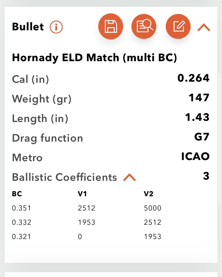

What BC are you using?
I plugged in all your data and my app is reporting pretty darn close to your reported numbers. I didn’t know your optic height. But I’m super close.

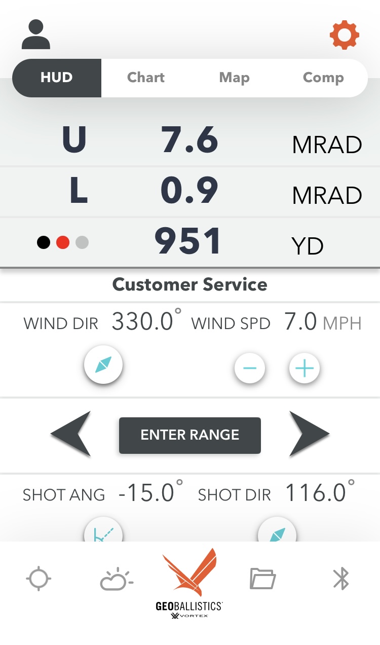

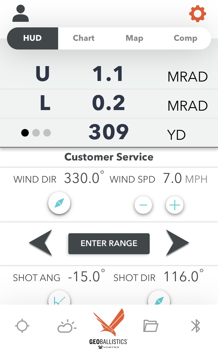

Ok, those geo ballistics numbers make sense. I didn't catch the 15° shooting angle in the screen shots.
I guess I should take a closer look at the depression angle of these targets 🤔 it feels pretty flat. Maybe they are way down there.
Happy accident. I must have tapped it after setting it at -2°
Let us know what you get for your angle at your next range day.
