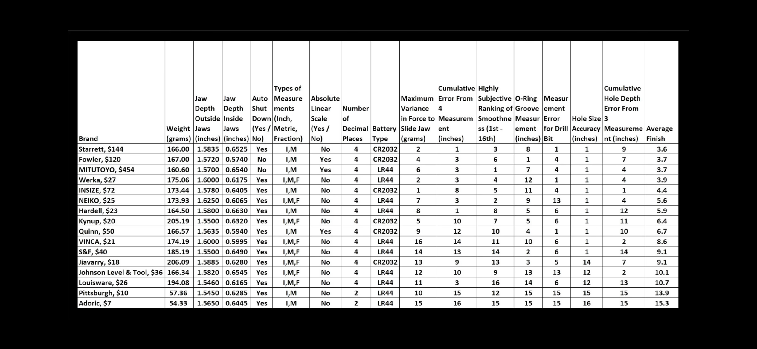

Nothing wrong with digitals, like anything else, you get what you pay for. His results aren't too surprising. Just by his price quotes, he didn't buy the industrial standard Starretts or Mititoyo's with the IP67 rating and certificates of calibration. Out of the box quality is one thing, but lets see the results after a few years of daily usage and see which ones hold out. What he should have done right away was close the jaws on each and hold them in front of a light source to check for light gaps between the jaws, usually the light gap will be at the tips. Notice most of them had different measurements when he just used the tips for measuring the 1-2-3 block. Take any old set of well used calipers, regardless of brand or whether they're digital or dial, and they will also fail that light gap test.
For reloaders, repeatability and longevity/wear over time is what we need to be more concerned with. Starrett and Mititoyo are kings in those categories. Brown and Sharp was sold off a long time ago, they just survive in name only. There's a couple German/Swiss brands out there, but you rarely see them outside of Europe.
speaking from experience, mitutoyo last for years with use 5 days a week, rarely change batteries. Worth the money.
For hobbyist buy cheaper is you want.
Here is a snapshot from the results of the video.
