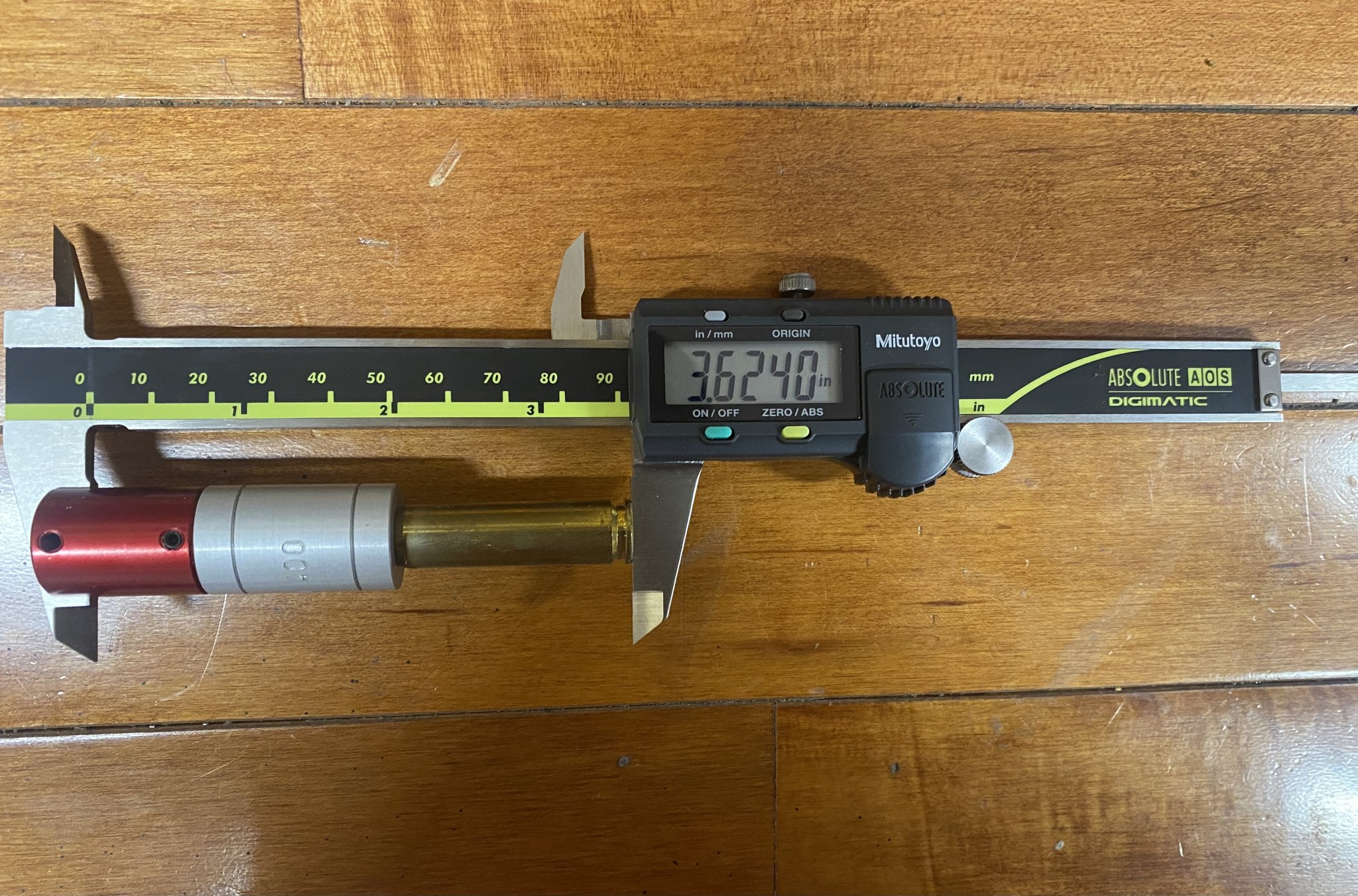

I’m going to buy a digital mituyoto caliper. Is the 6” model enough to use a bullet comparer with or should I go to 12”?
Unless you’re doing some crazy magnum, 6” should be fine. This pic is my 6” Mitutoyo with Hornady Headspace Comparator and a .308 round.

For comfort, standard long action calibers should be a minimum of 8” calipers for the body comparator, I don’t have a magnum long action, so a 12” maybe better idk. 6” works fine for short action but I prefer 8” anymore……I’ve got 8” for everything I have.
