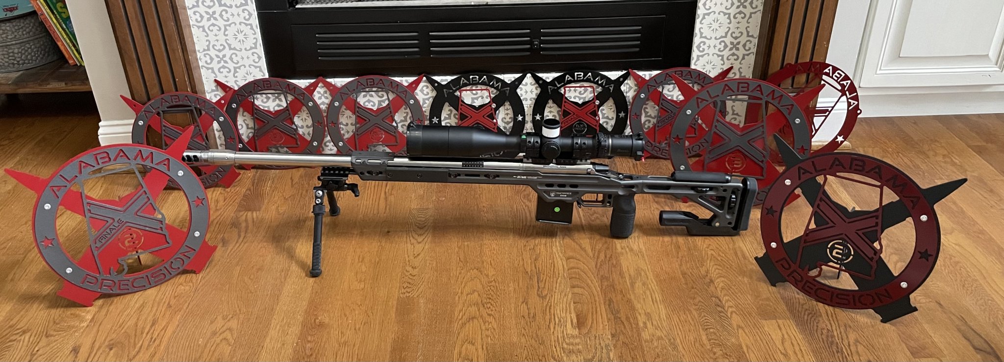

This is for the visual learners.
Used the XTR3 5.5-30 non-illuminated until the illuminated version came out. Glass was identical in the samples I compared.
Race Dial is a game changer for PRS. Tracking has been dead nuts. Placed 2nd out of 93 with it Saturday and the scope definitely wasn’t the reason I didn’t win.
Burris glass is equal to the Cronus I still own but I much prefer the Burris reticle and FOV for comps. Burris glass was on par with the Razor Gen 2s I’ve had.
