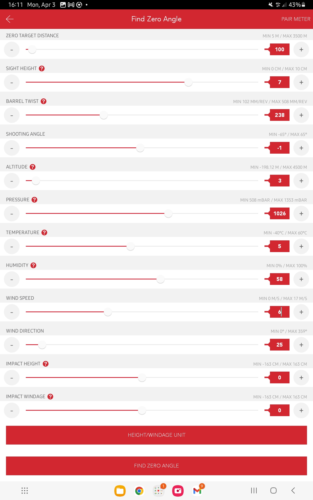

I have an issue when setting the "Zero Angle" in the 4 DOF App, more specifically to the relationship between "Altitude" and "Pressure".

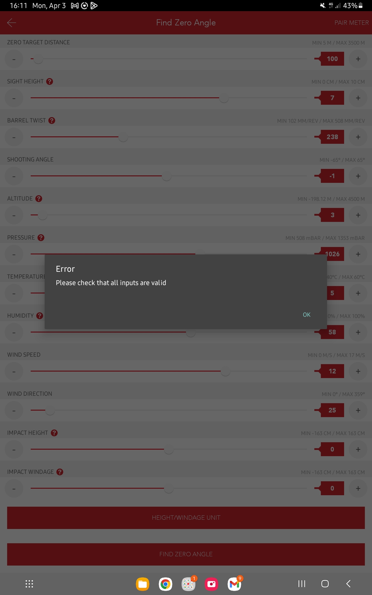

This weekend I was at a range planning to re-zero my rifles using "Zero-angle" but ran in to some problems as the app kept saying there was an "Error" when trying to calculate the "Zero Angle".
I suspect the issue I'm having is related to the before mentioned relationship between "Altitude" and "Pressure.
On Sunday the "Pressure" was 1026mb at 3m above sea level - the pressure was measured using my Kestrel (5500), and i was getting the "Altitude" from my phone using a GPS app to give me this. The range is literally at the edge of the sea, and we are shooting out over the water, so the 3 meters above sea level can't be completely off.
The pressure I'm using from the Kestrel is the "Station Pressure" not "Baro"
If I enter the "Altitude" value in the app first, it auto corrects the "Pressure" value to 1012.95 mb, and then it lets me calculate the "Zero Angle" but I would now be running with the wrong "Pressure" value, which would be counterproductive and wrong as I'm aspiring towards ELR shooting, where I need to make sure I have all parameters under control.
The same thing happens if I enter my enviromentals on the 4DOF HUD - if the "Altitude" and "Pressure" isn't within the range the app finds to be matching, it won't calculate a firing solution for me, and just set both elvation and windage to zero no matter the distance or wind.

The most of the data is in the screen shot of the zero angle page - it's a Ruger Precision in 338LM using the 300gn Lapua Scenars.

it's all in the screen shot. only thing missing is MV. I used 837 M/S. It works for me when I enter everything manually. However, I had to convert Mbar to inHG. My App stays inHG even when in metric. Can you change the pressure unit in the kestrel to inHG and try again.
I'd bet that's where the glitch is. If it's trying to use 1026 inHG it's gonna have a spaz

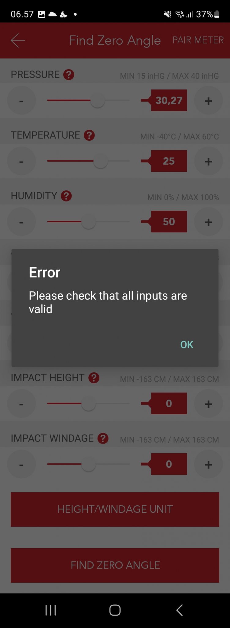

The rifle is new so I'm running a MV at 780 m/s.
Just tried to change to inHg - still the same issue. It just doesn't want to calculate in high pressure.

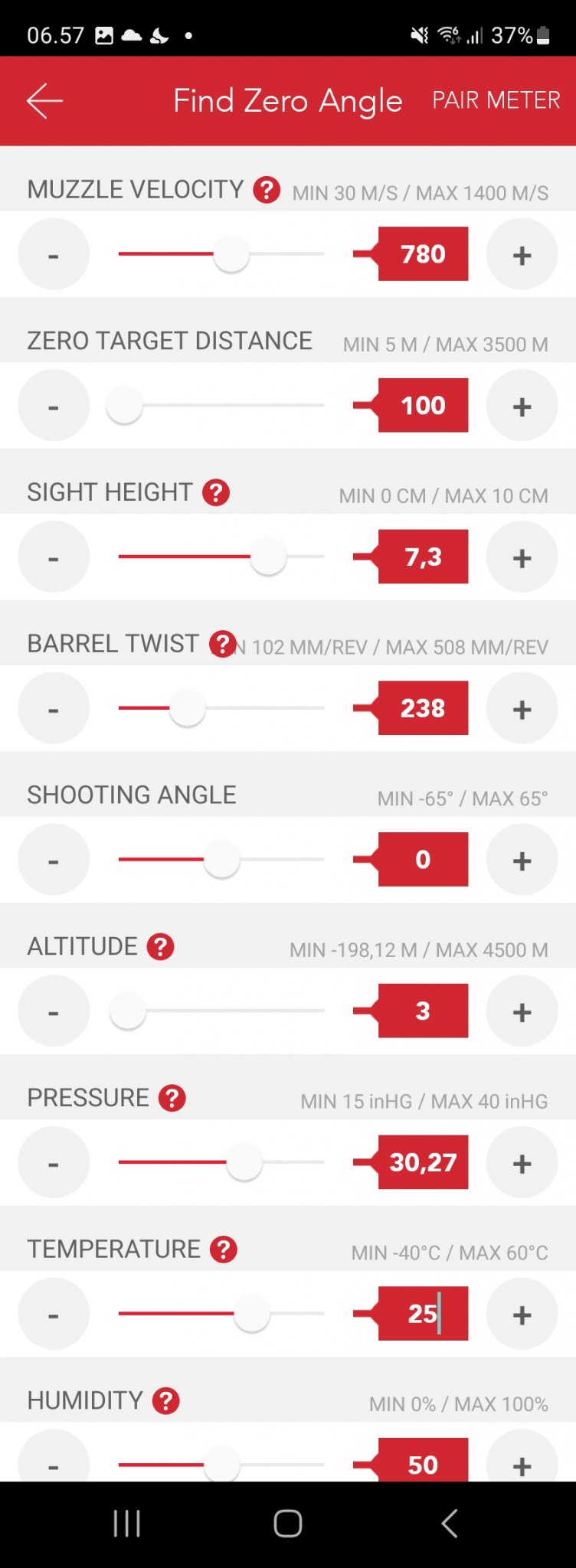

Rifle data:
MV 780 m/s
Sight height : 7.1cm
Twist : 238mm (1:9.375")
What I just tested
Pressure: 30.27 (pressure this morning)
Height: 3m
Tried it both in the zero angle dialog and HUD. Zero Angle gives error, and HUD don't want to calculate.

It seems to work fine for me. However this morning when I go into it half the inputs are metric and half are imperial so I don’t know wtf is going on there
Ok, finally got a chance to do some testing again. I copied my gun profile and changed everything in to (US) units, and it seems to be working.
So the conclusion must be that there is a bug in the conversion when using metric units in 4 DOF - seriously annoying. So now I need to decide I want to convert everything in to US units for everything I do.. Or start using AB.
