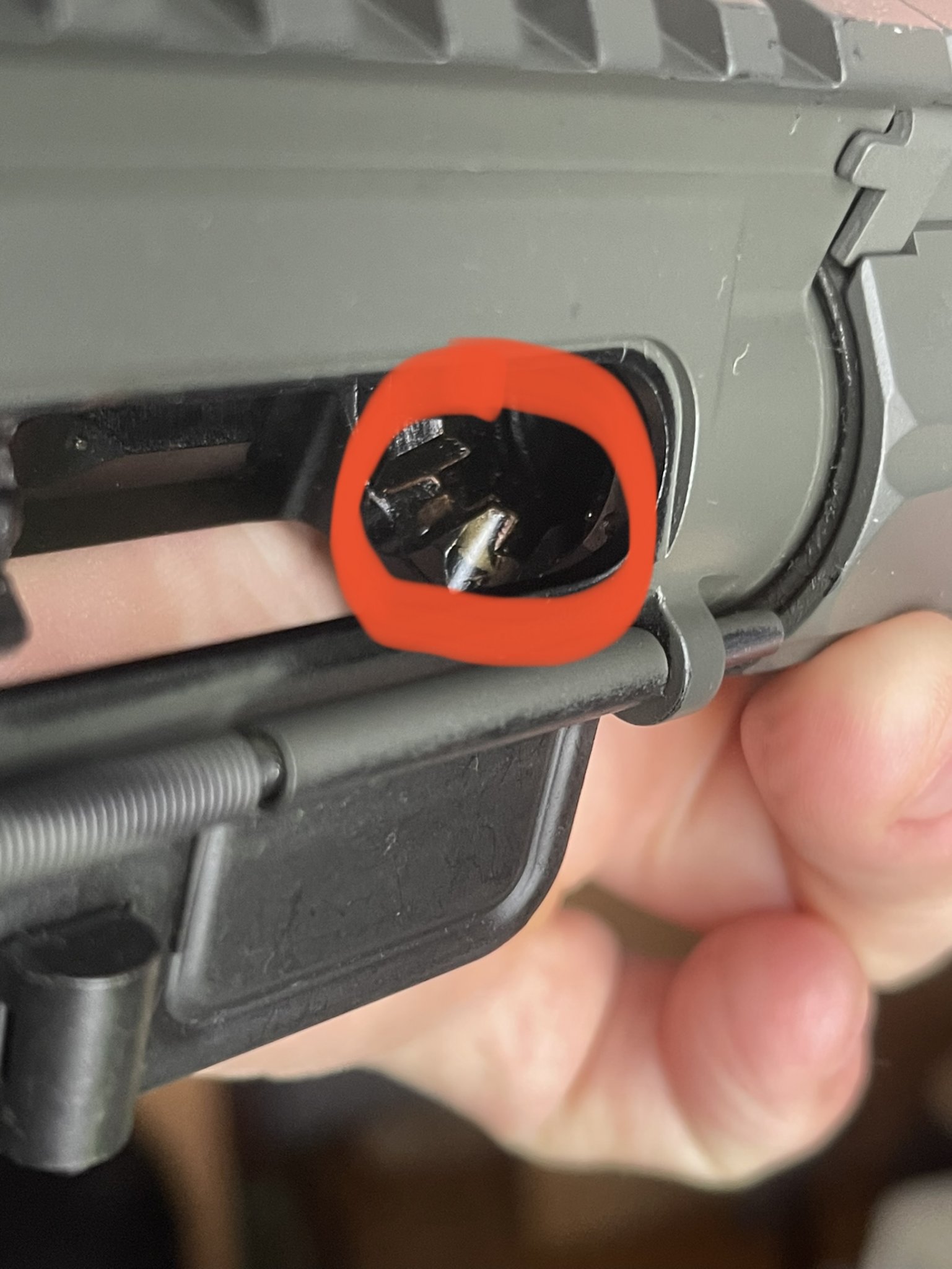

    I know this sounds like bubba gunsmithing 101 but can I simply dremel the edges off on these feed ramps a bit. There sharp edges catch the bullet when feeding. If you close the bolt slow the round wont even chamber. Sometimes pushing the bullet into the casing when loading
    So can I just open them up a touch knocking the corner down?

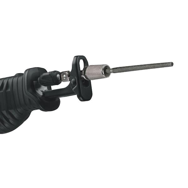

    Jewelers files and/or wet-dry sandpaper wrapped on a dowel. Then a bore mop and section of cleaning rod chucked in a cordless with #600 or #800 lapping compound. It's really messy, so plug the bore and cover anything else that you don't want to clean. Flitz is great for polishing (1500-2000 grit), but doesn't really remove much material.
    Thinking maybe initially with the dremel. I have some tips that I think will work good. Then hand file to decent. Then dremel with flitz on a polishing wheel

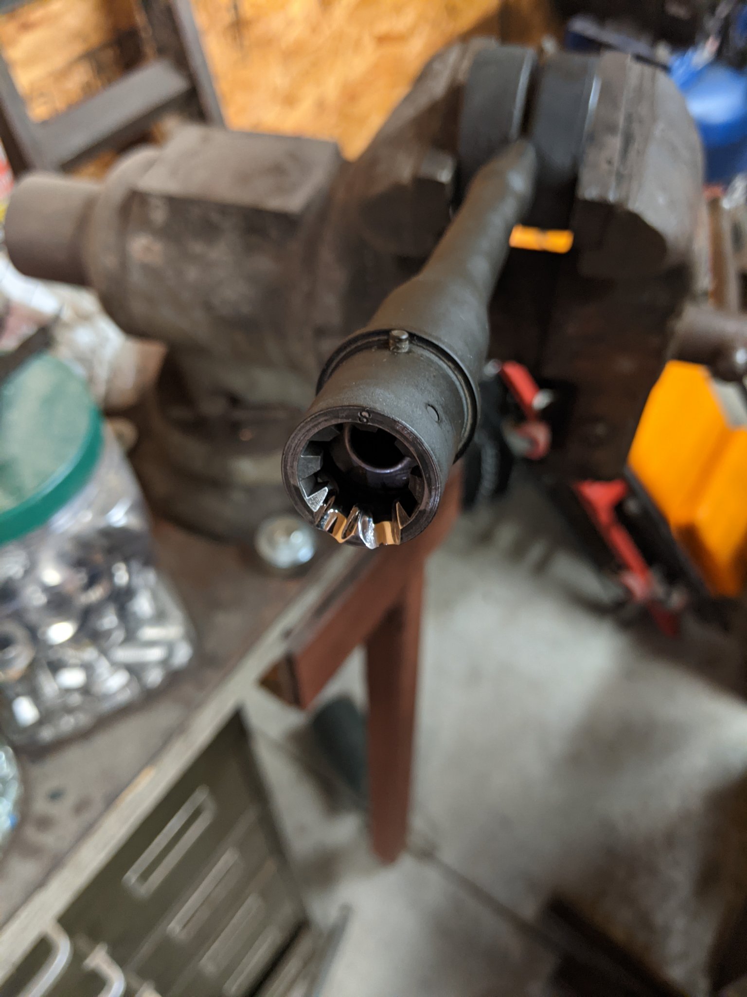

    Don’t use a dremel unless you are a brain surgeon with it. Use a Wooden dowel with a fine sand paper and some dykem.
    also, you will need to disassemble the upper to maintain the correct pitch on the feed ramps.

    Basically.....
    1. Remove BCG
    2. Remove hand guard
    3. Loosen and remove gas block and tube
    4. Loosen barrel nut and pull the barrel out of the upper.
    Yes, it's that simple. Imagine...if a USMC E1 can do it, pretty much any 6th grader can.

    i would consider not using a dremel, which seems to be a dead horse being beat.
    If you need to shape, get a file. Jewelers files work great, and make a just few passes. Don’t go ape shit.
    Then some sand paper to smooth. The dowel method people have mention works too.
    Then if you want, maybe use the Dremel to do a light polish to finish.

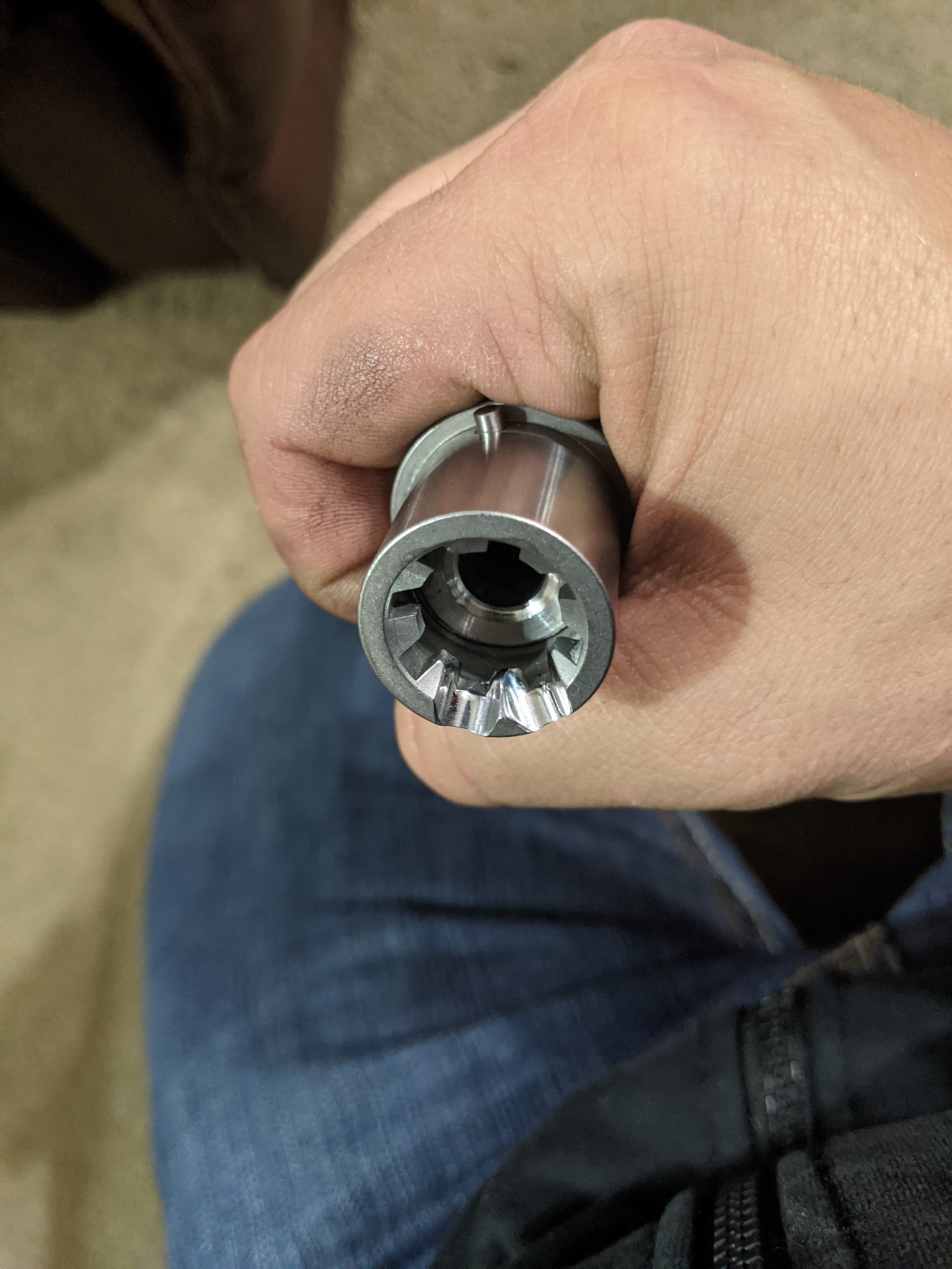

    I did something similar to my WASR 10. Had multiple sharp edges inside that would catch and mangle brass. Used a course rat tail file to cut the sharp edge back and then a really fine file to smooth/polish it some. Did it through the mag well. Works fine now.
    Just go easy. Like others have said, a dowl or 1/4 inch extension and sandpaper would work too.

    This above, also consider using Arkansas or India stones (also called oil stones). Stones are available in multiple shapes (round being a common shape), and probably real close in size to the diameter of the area of the feed ramp that needs polishing. They come in many grit sizes (stones are graded like sandpaper) from coarse for removing any burr or sharp edge through fine/ultra fine grits that would eliminte the need for any polishing with a dremel. Stones just need oil and a little elbow grease, no extra polishing compounds required, just plug the bore to keep the dirty oil out of it.
    You can most certainly use a dremel. I use the bullet shaped stones to very lightly knock the sharp edges off on the corners. And when I say lightly I mean just kiss them. The last thing you want to do is reshape the feed ramps and change the angle of them. Get a couple of the bullet shaped felt polishing tips and use metal polish on them to smooth everything out and shine it all up. I havedone this to every AR barrel I own and it makes a noticeable difference.

    Yeah its apparent to me now that pulling the barrel is the better option. So that is what I’ll be doing. Probably just start with hand filling and see what that gets accomplished

    Coat it with dykem and chamber some rounds, and lightly hit just the high points with lapping compund with a long wooden handled swab. or send it to D Wilson
