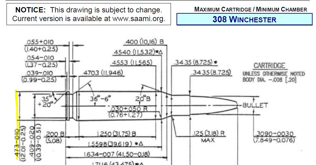

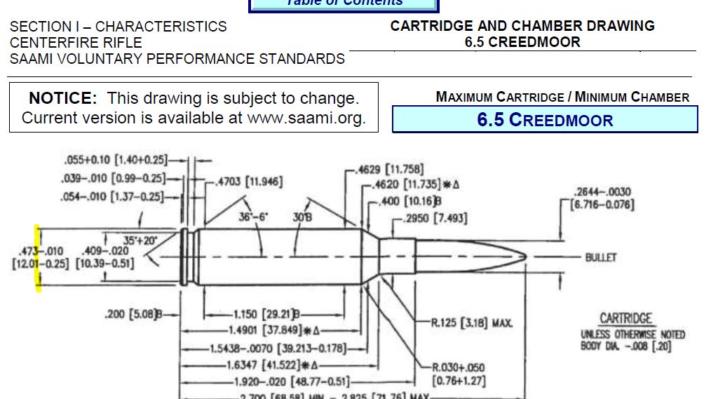

I'm inclined to go with option number three, but I'm wondering if i can buy a .308 barrel and use the 6.5CM BCG.

I sent them the barrel, waiting to hear back from them. Depending on how it goes, I'll either stay with the (6.5cm) setup (if it actually works) or I've been considering switching to .308, in which case I'll want to make use of the BCG that I already have, if it's compatible. No decisions have been made yet, just getting an education here.
....Yes, the bolts (and carrier) for .308WIN and 6.5Creedmoor are interchangeable for AR10's. Note the yellow highlighted case rim info on the diagrams.
Reactions: Evintos
Since .308 is 7.62 creedmoor the bcg and bolt will be fine.
